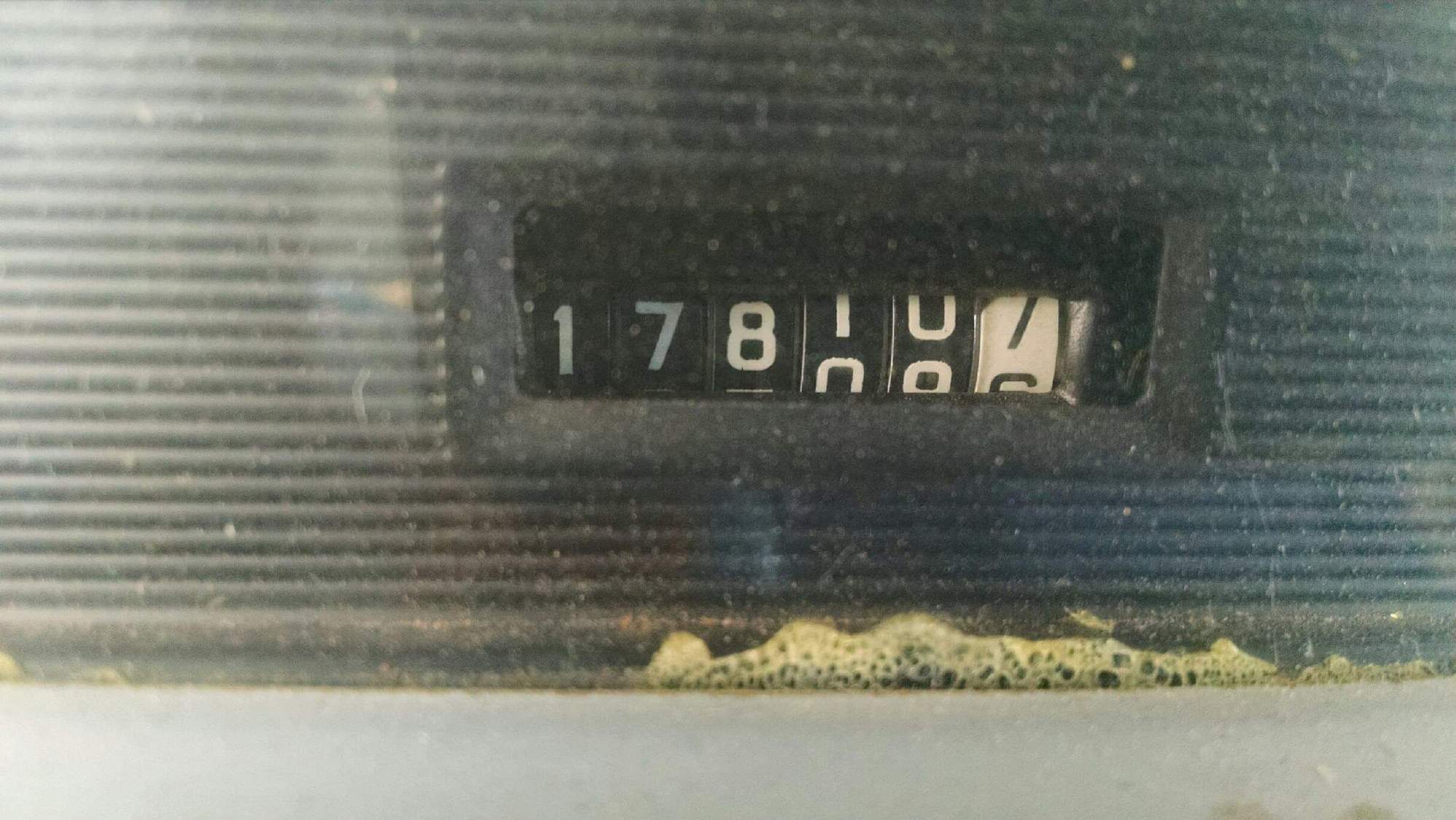

This may have already been discussed here, but I'm new and couldnt find it. I am getting a 1966 f100 custom cab that is all original except for a few bolt on parts. The owner has all of the original parts that I am going to put back on it. The only non original parts left on the truck or the wheels. I was trying to see if anyone k ows what the correct wheels or and what different variations they made. The truck is pretty much a survivor with only 17xxx miles on it. Thanks in advance for the help.

Remember these trucks don't go to 100,000 when the odometer rolls over - it goes back to zero and starts over again. With the seat upholstery redone on the truck and other things looking like they do I can just about guarantee you this truck was not driven an average of 336 miles a year.
You can often tell when the odometers have rolled over because the digits can start to roll over more than one at a time. Notice how three of the five digits are not centered. That wouldn't normally happen with the base mileage odometer like this looks. It's rolling to the 10 mile mark when the tenth mark is between 6 and 7 - classic signs.

I’ll also suggest you look at the brake and clutch pedal rubber pads. Heavy wear would remove any question of low mileage.
There is no way, none that this dowdy truck is all original and has only 17,000 miles. It probably has 117,000, but it could have 217,000 miles.
Reupholstered seat using the wrong materials, blue overspray on firewall mounted parts and the exterior (in fact the blue paint is not original or correct), are two of the dead bang give-aways.
This truck was beige originally, so it not have a blue interior or a drop of blue paint...anywhere, except on the engine. 1966 was the first year that all FoMoCo engines were painted Ford Corporate Blue.
Do not believe the miles shown on the odometer, as it read to 99999.9 then returns to ZERO!

I am the third owner of the truck. Yes most of yalls comments or correct except the reason parts were replaced is the truck was parked or 30 years on a barn. The distributor went out and the first owner just parked it. Dont know why or exactly when. The wheels and interior was changed by the second ow era as well as the distributor air cleaner steering wheel and he also added the radio. I'm not sure 100% about the paint. I believe under the hood is correct and it was at o e point painted the beige. I will get the tag numbers when the truck is delivered to me.

Looks like a solid truck and should be a fun project but for sure not 17,000 miles. Sounds like the first owner drove it for 20 years, 117,000 miles, and then it sat for 30 years.

No way it has 17,000 miles with the that bench seat as it is. I can show you my four old cars ranging from 79,000 miles to 153,000 miles and all have the original fabric or vinyl seats. If this sat 30 years then the bench seat should be intact and pristine. Either that or this F100 went through the hardest 17,000 miles any F100 has ever gone through.
