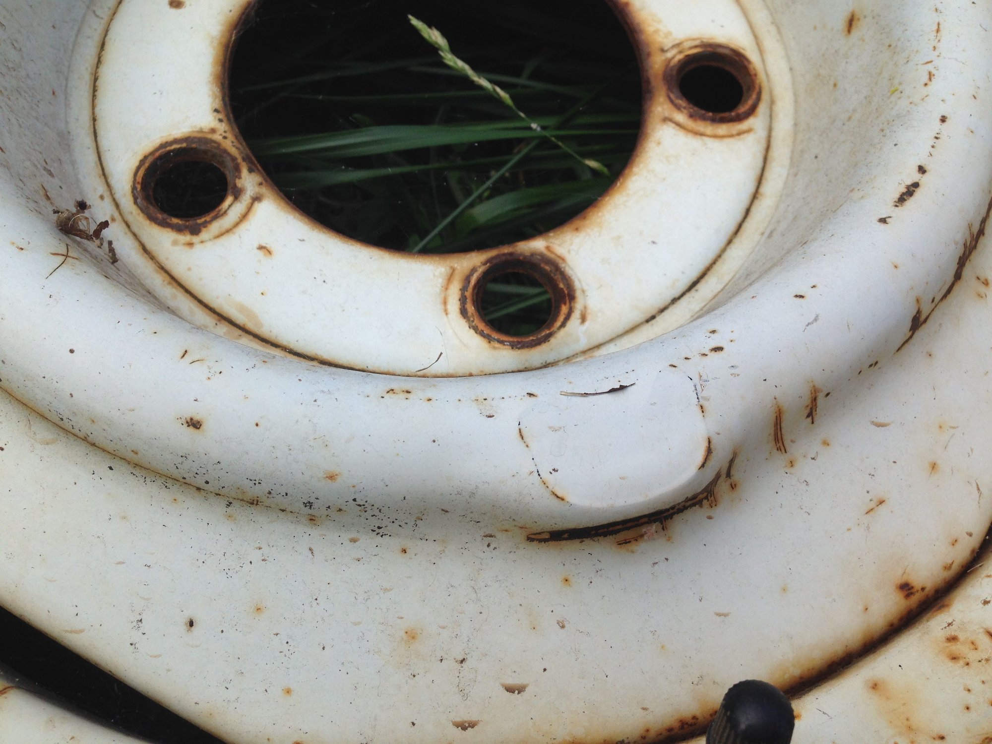

Are these the original wheels for my 1964 Ford F100 4x4?
It looks like a hubcap would snap to the outside of the inside. I read on this forum that the 4wds sometimes had hubcaps and sometimes didn't but that they only had rear hubcaps anyway. I know for the past 35 years it hasn't had hubcaps, but the marks on the tabs look like maybe it did at one point.

The correct for 64 will be innie style. The pictured rim is a later model.

Not original, these are "outie" wheels that no 1961/64 came with.

No, not original to any year Ford. Those are off a Jeep.

The innie wheels are only an issue if you want to run the correct hubcaps or you want it as original as possible.
The outie wheels will work just fine.
There are lots of innie wheels in garages, sheds, and yards that people have discarded for newer rims.
Its easy to ID Ford rims by looking at the hole in the center. Ford, Dodge, Jeep, and some (I think) International used 5x5.5 bolt pattern, but the center bore is all different.
Pretty easy to see that wheel is off a 4x4 and the nubs are not Ford.
