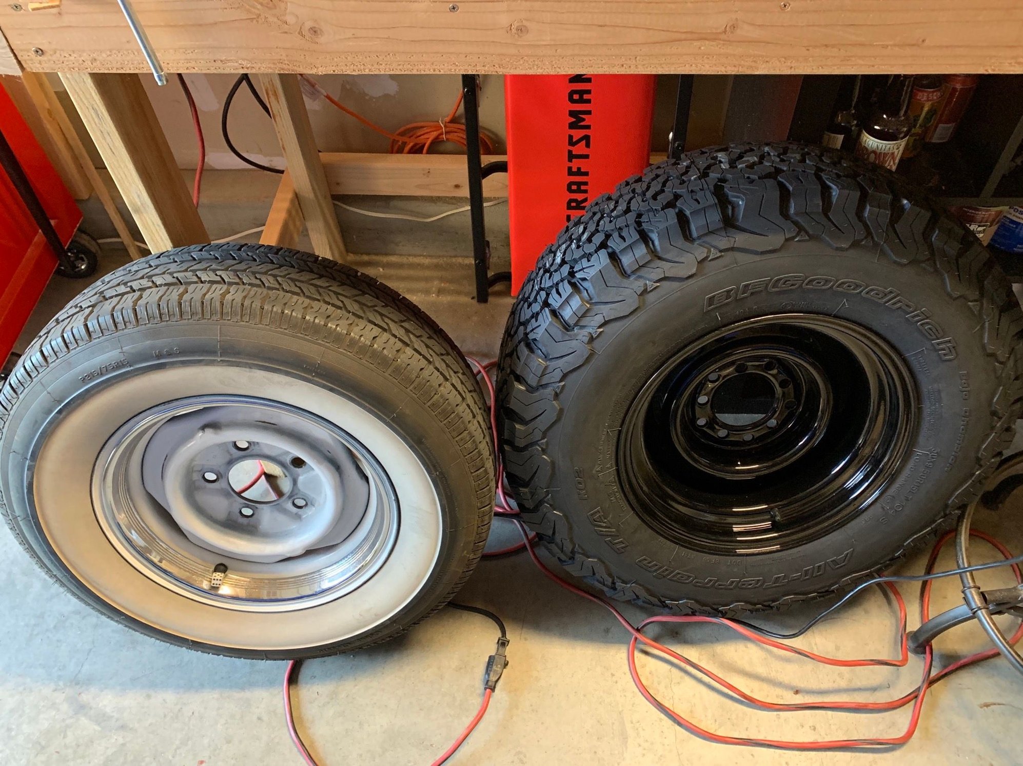

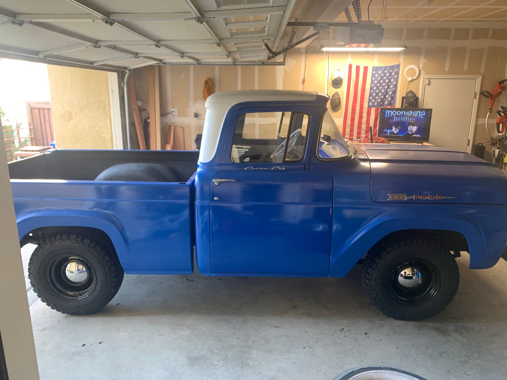

I have a 1960 and change my wheels to 15x8 with a 4” backspacing
i was able to but 30x9.5 bfg on it with no rubbing
