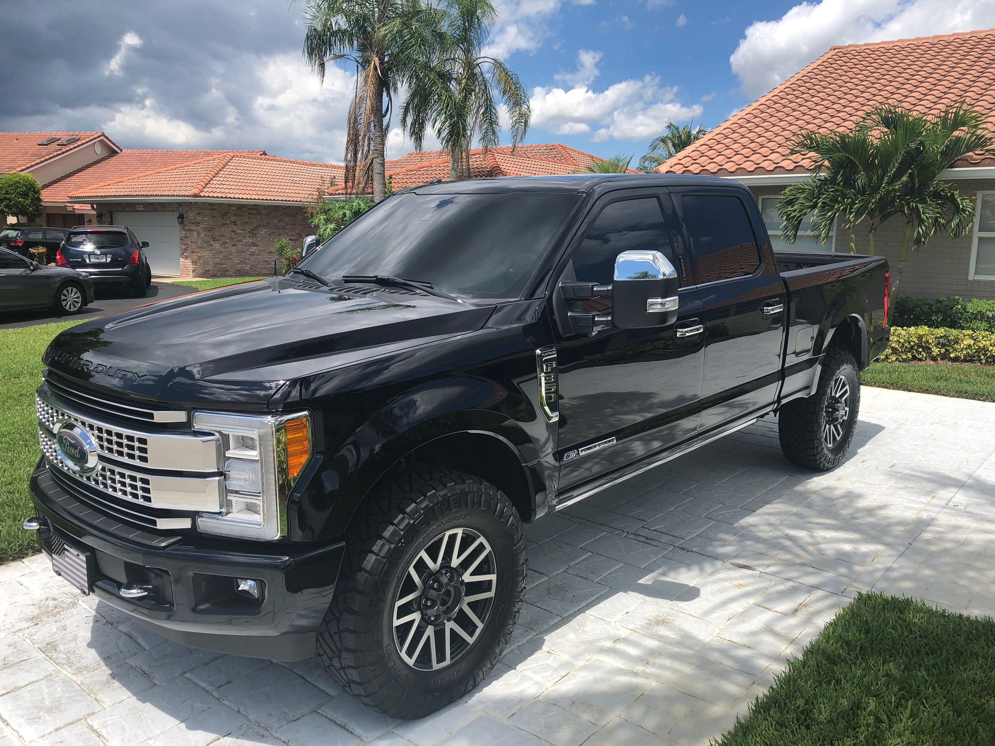

This is my current set-up with 37" Ridge Grapplers on 20" OEM machined wheels. 100% stock suspension.
