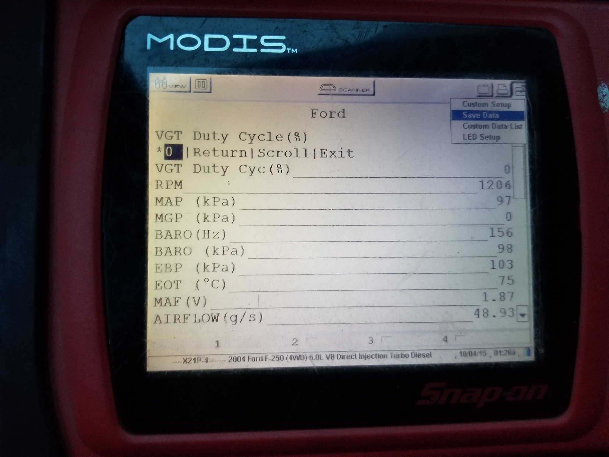

Old May 13, 2019 | 03:43 PM
Nick Fogarty's Avatar
Nick Fogarty
Joined: May 2019
Posts: 17
Old May 13, 2019 | 03:46 PM
Nick Fogarty
Joined: May 2019
Posts: 17
Old May 13, 2019 | 11:05 PM
JaySVX's Avatar
JaySVX
Joined: Feb 2008
Posts: 1,955
From: Eastern PA
EBP and MAP look fine, but VGT doesn't look right. Even on the low side it should be 15%. Your rpm is 1206, were you driving when that picture was taken? IE. not in park?

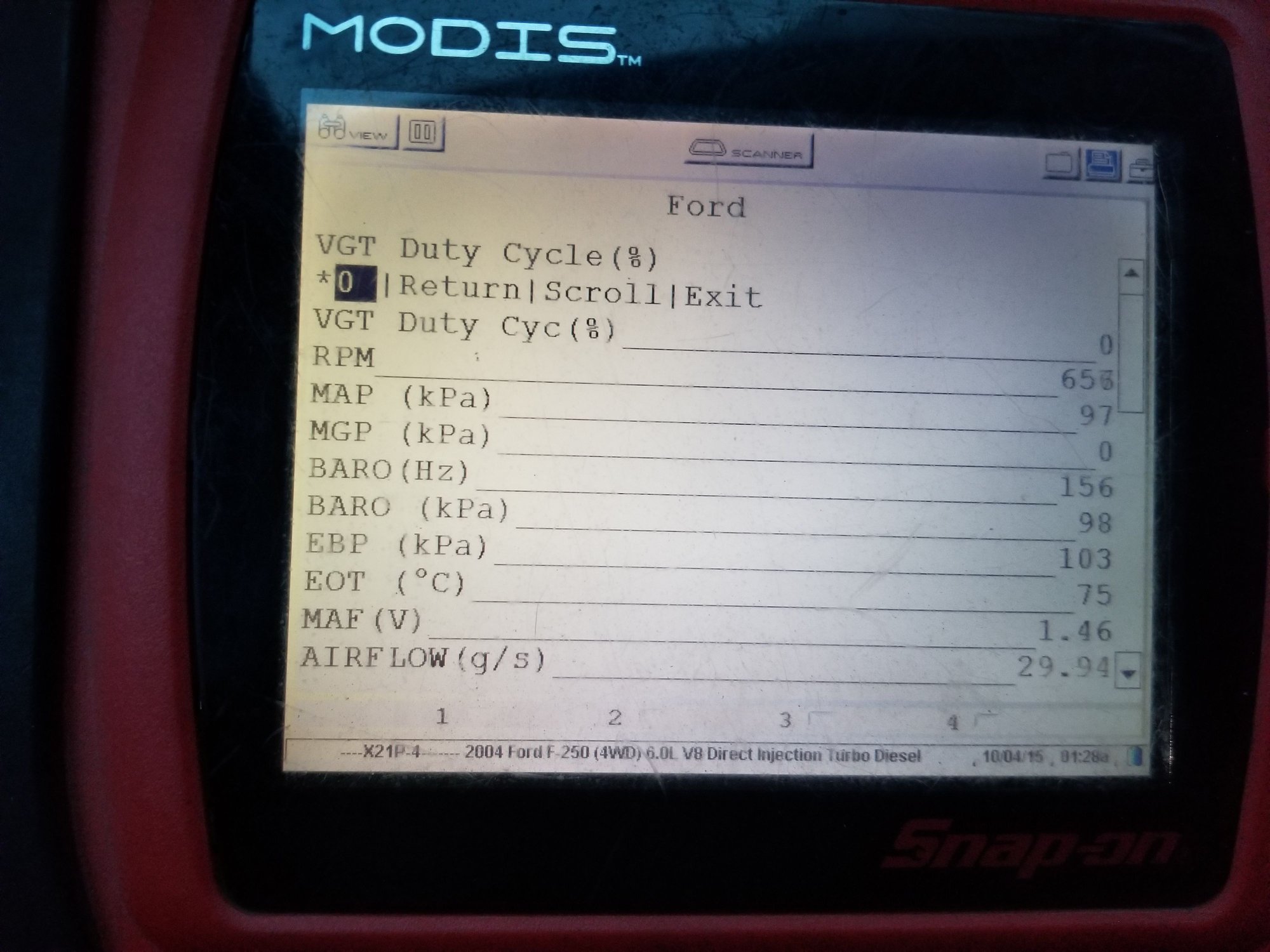

Old May 14, 2019 | 08:42 AM
Nick Fogarty
Joined: May 2019
Posts: 17
The scanner wanted me to idle to 1200 rpm. But here's a pic at idle no throttle.
