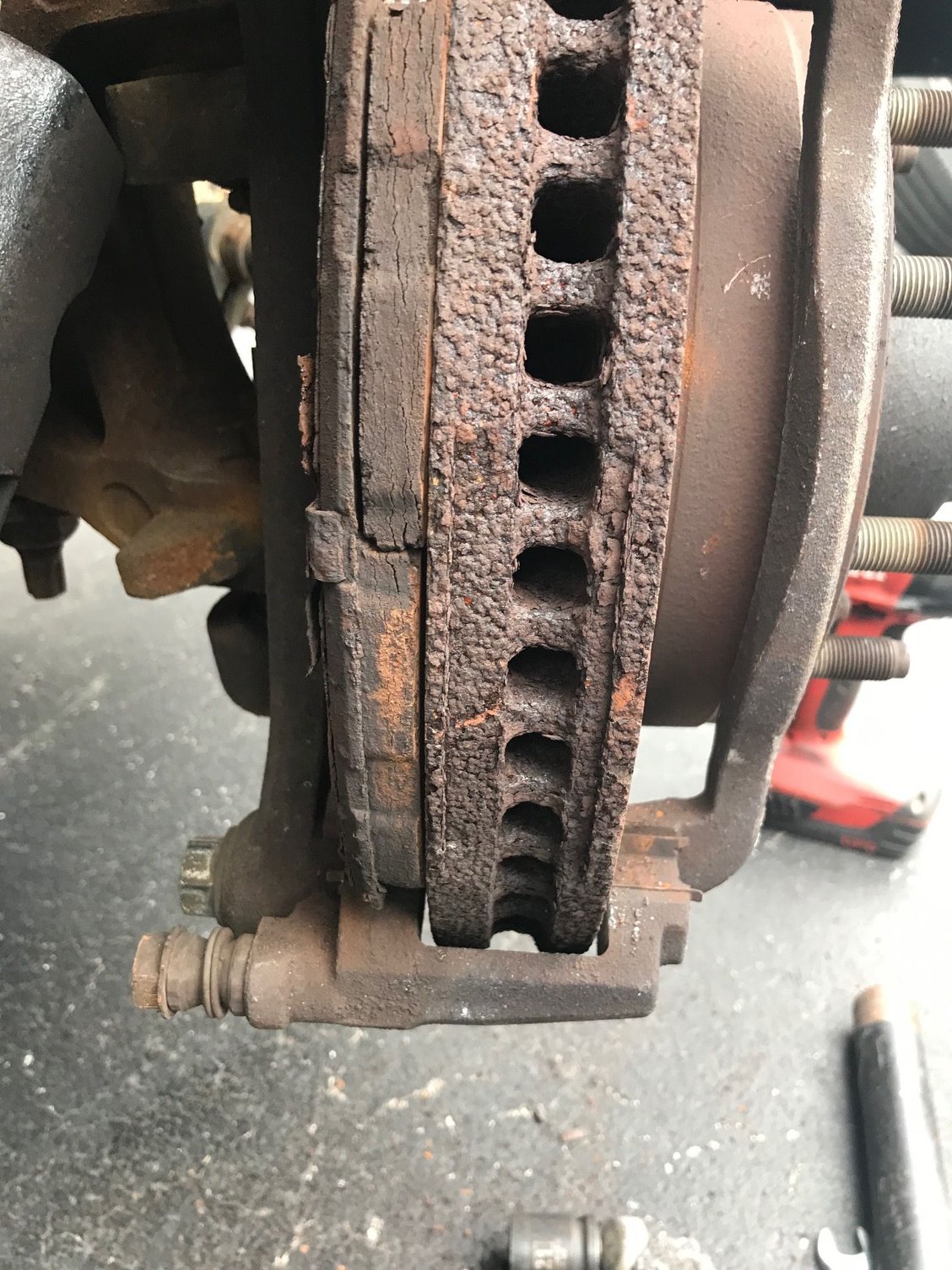

It's time to get ready for trailering season so I pulled off a front wheel to have a look at the brakes. The pads look fairly new and I was getting ready to put the wheel back on when I took another look at the inside pad. It didn't look right, so I poked it with a screwdriver. It was loose, and broken into two pieces, but still in the caliper, and I'm really happy about that. Never seen anything like this before, is this common? I'll try to post a picture when I take it apart to replace the pads.

Replaced the pads this weekend. Looks like rust is the culprit. Both of the inside pads have the pad material broken off the backing plate, and the pad itself looks like it is delaminating. Not sure whose pads they are, but they aren't near worn out. Bought the van with 30K miles, supposedly almost all highway, and it has 51K on it now, mostly highway, so there's some chance that they're OEM. The van has seen very light use over three Wisconsin winters. When I bought the van, it had been in a warehouse over the previous winters and it looked showroom new, so I'm surprised by the rust damage.
I'm really glad the pads stayed in the calipers. Could have been disastrous pulling a trailer, or more accurately, being pushed by a trailer down the mountains on I80 with no brakes.

Make sure the caliper isn't sticking when applied, those pads look like they where overheated and had the resin burned out of them.

Agreed---that look isn't normal wear at all.

The calipers retracted easily when I put the new pads on. Boots were fine. The sliders slide. Just took the van for a ride down the freeway and back home and the rotors were too hot to comfortably hold your finger on them, but not smoking hot. I'll keep an eye on them and check temperatures after a longer ride to make sure they're not cooking.
