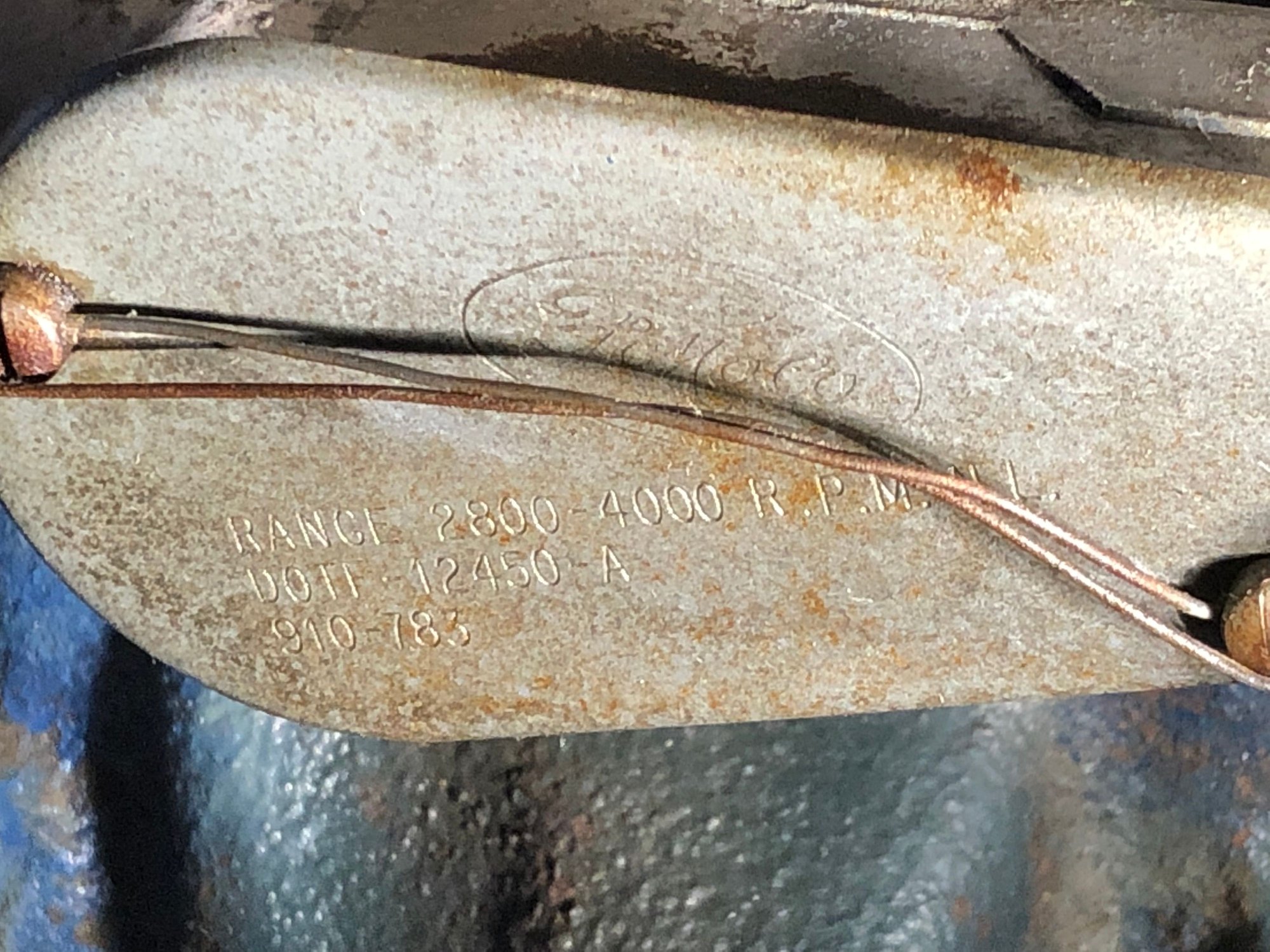

while looking at the carb to get the info I need to rebuild it I can see it is mounted on top of a riser, that has lead seals locking out something on the choke side. Does anyone know what this is?
Choke side, see seal and wire on carb riser (bottom of pic)

My guess, that block under the carb is the governor. Likely spring loaded air door? Have you pulled the carb off to see?
Hi Freighttrain,
no I haven’t yet, I was going to wait till the rebuild kit comes in first. You may be right, I know these FT engines are low rpm torque motors.

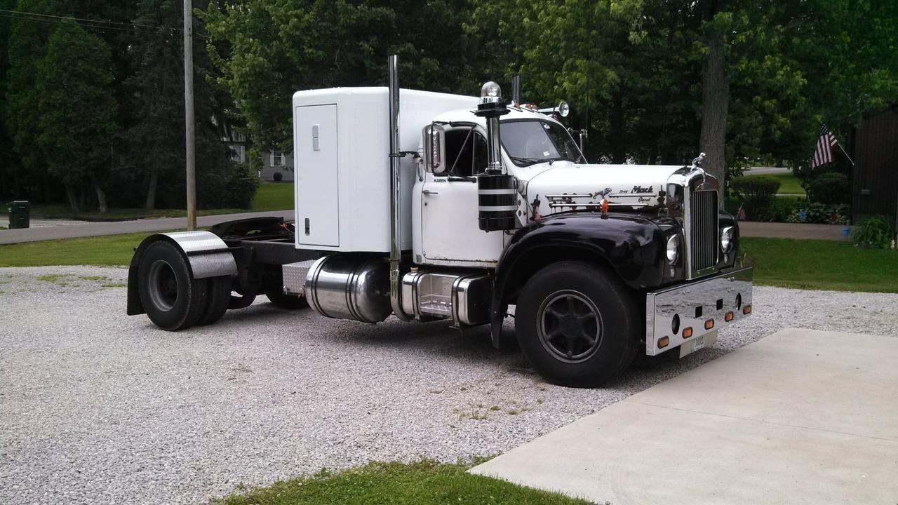

I'll say the door brackets are both "lower" mounts from a B model. The upper brackets on a B are curved to match the door. I just blasted and painted mine. I didn't spend the $600 for new SS brackets!!! Last winter I put a set of NOS door shells on it along with new glass/seals.
Though they could be early R model stuff too?
Here's my truck. Just a long work in progress for the last 18 yrs. Just chipping away at it. This picture is a couple years ago.

Nice Rig! Does that truck have the sleeper outfitted with a bunk?
I noticed my cross bar (top to bottom) is opposite of your mack

Yes that's for the carburetor governor. If my memory serves me correctly, there is an adjustment screw under the front cap.

You guys are right on, I took a closer look at it and found some info printed on it. It gives a range of 2800-4000 rpm. Definitely a governor. I’ve read a bunch of posts about how important it is to stay under 3800 rpm with the FT330, to get longevity out of them.

Yes, the bunk is a Bentz 42" sleeper. I stretched the truck 5ft from when I bought it, added air ride and put the bunk on. I cut the back of the cab open for access. I've done lots of other improvements over time.
