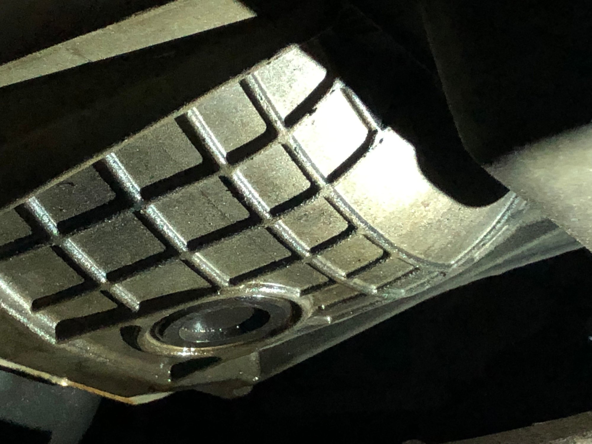

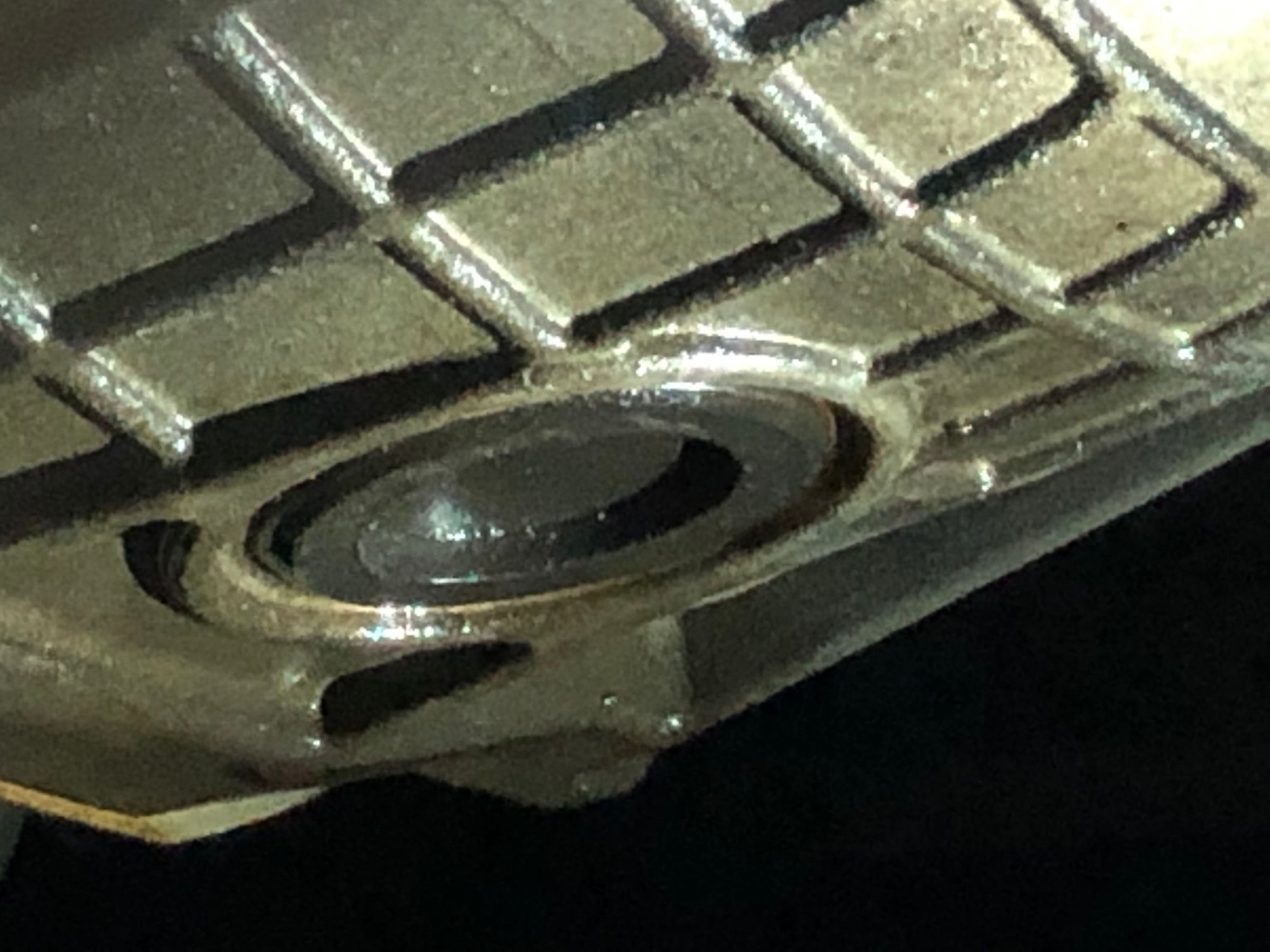

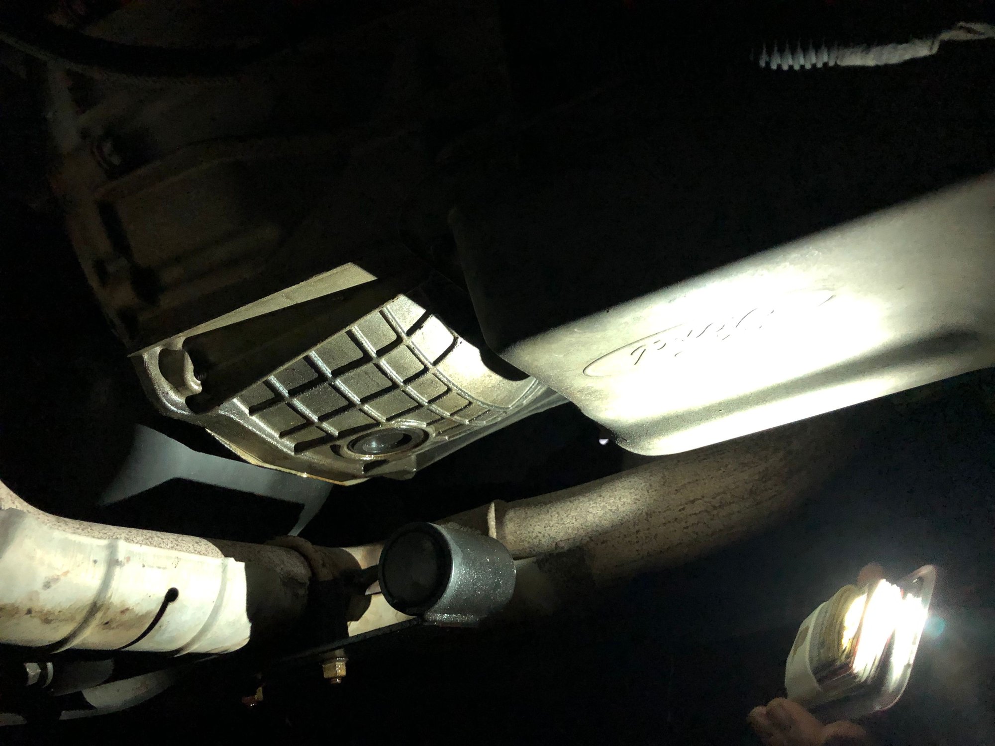

Was towing a load tonight and my transmission started leaking only my exhaust and smoked like crazy.
Transmission still shifts but is leaking around this thing.
I’m ignorant.
Many idea what this is and why it’d start leaking.

That is an access plug for servicing the torque converter (back when they all had plugs to drain them). You have likely overheated and started leaking out the front seal.
dammit
Would that typically by just a seal replace or worse?

It depends on what is found when the seal is removed. The bushing behind the seal could have failed and made the seal leak. It could have damaged the torque converter, too, and if so it needs to be replaced.

The most common seal leaks seem to be while reversing, especially up a grade after towing for a while and the trans is already hot, then reversing under higher load with no air flow through the cooler gets the fluid and seal hotter and then the seal gets soft enough to leak some. Many times after the seal cools back down it will return to normal and not leak, but like Mark said, if the sealing surfaces have been scored then that damage will need to be dealt with.
For any rigs that tow regularly with the 4R100 trans its recommended to monitor the trans temp via either an app like Torque on your phone or tablet with a dongle plugged into the OBDII port or with a stand alone gauge with the sensor installed in the trans test port. Getting too hot is very unhealthy for these otherwise good transmissions, that's why monitoring temps while towing is recommended.
Does your EX have the trans cooler circuit inside the radiator as well as the air to oil cooler in front of the radiator? Some early EXs didn't have that extra cooling loop.
Now that it's cooled back down to ambient temperature you can start it up and see if you still are leaking without the heat and towing load.
