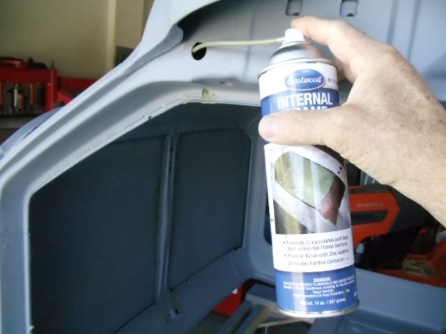

Yeah, I think you're not necessarily headed towards disaster, but I think you're headed for a lot of work.
What I would do is leave the reinforcement in place and use a product Eastwood sells. It's called Internal Frame Coating. It comes in an aerosol can with a flexible tube and nozzle that can get into very tight spaces. It's a spray that neutralizes the rust and is paintable. It's also very thin so it can creep into tight spaces.
https://www.eastwood.com/eastwood-in...RoC55MQAvD_BwE
