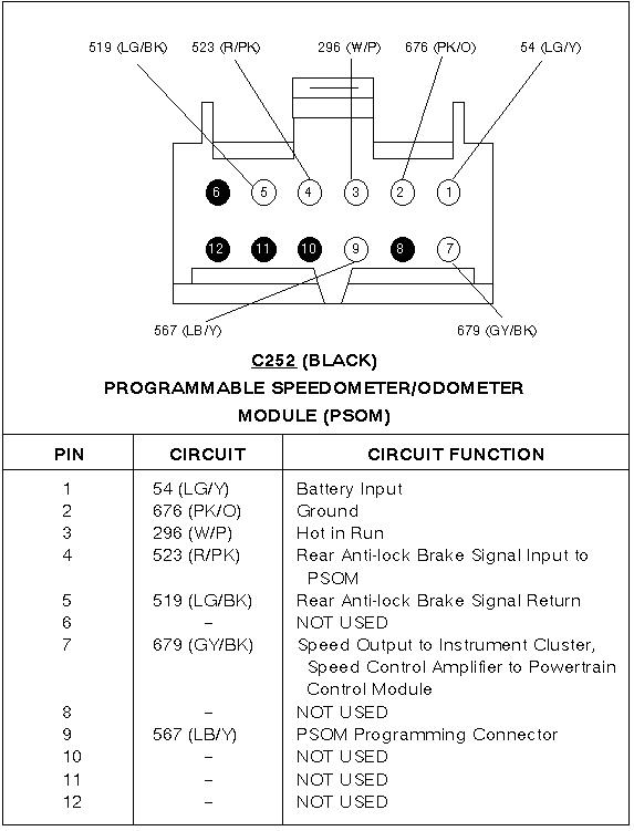

Find out why the doom light does not work.
The fuse that supplies the doom light also powers the PSOM.
You do not have power on a power pin going into the PSOM (pins 1 & 3).
You might have to pull the cluster out some to test these two wires with a loading test light (non LED)..
If both wires are hot and you have a good ground to the PSOM then you might have a bad PSOM.
Attachment 280347

Well I have an update on this issue. A little embarrassing but I've never claimed to be a mechanic and my mind isn't near as sharp as it once was. Now that I have my excuses claimed, the fuse box I was checking is under the hood, WRONG ONE. I should have been checking the fuse box to the left of the steering column on the lower dash. #8 fuse was blown. Replaced it and all is good. Still not sure why driving through the car wash would have cause it to blow.
