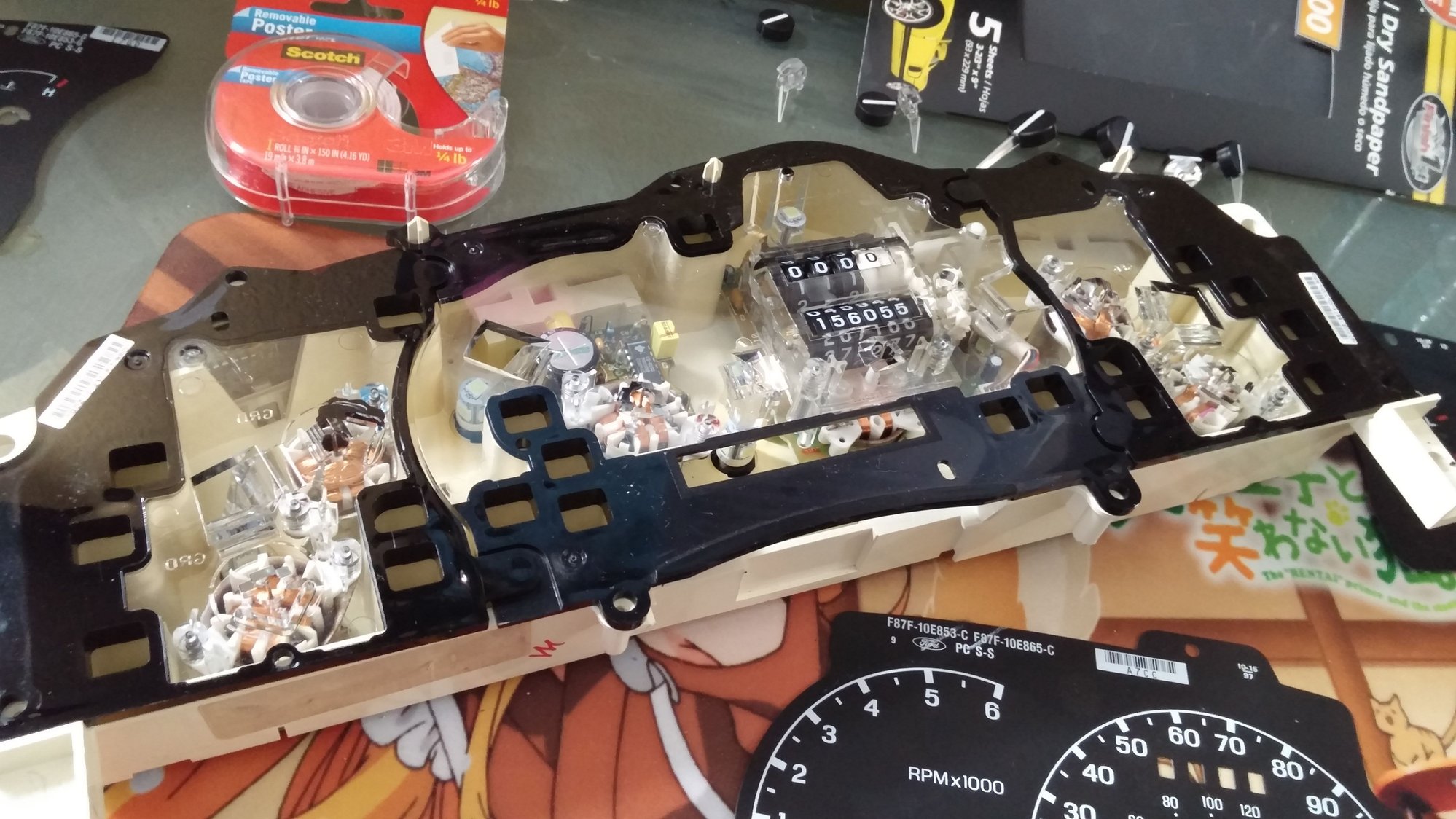

Your odometer assembly literally screws into the Speedometer control board its self. It is sort of a separate unit but the motor that drives the Odometer plugs directly into the Speedometer control board.
To get to it you will need to take apart the gauge cluster, remove the needles and the face. It is very trying and takes alot of patience and a very careful touch. The needles are sensitive and tricky to get back on in their proper position.
This is what the Odometer looks like
This is the Odometer motor
This is what the Odometer/Speedometer control board look like in the cluster
I would first check your wire connections in the back of the Gauge cluster and at your GEM (behind the radio) before venturing to disassemble your cluster.
