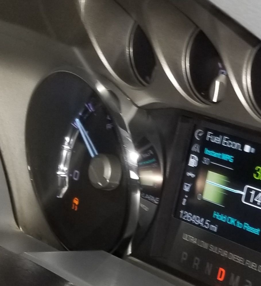

Sorry if I missed where this was posted somewhere else. Have a 2011 f350 4x4 ccsb. Truck is completely stock. Replaced left front wheel bearing assembly with wheel speed sensor last night due to it making noise. On way home from mechanic's the light that I say is for traction control came on for 30 seconds and went back out. No other traction control or stabiltrac or other messages in center of display. This morning girlfriend took pickup to work with her so mechanic could check it out. No codes came up. On her way back to work, it came on again so she took straight back. It come up steering position sensor. Mechanic has no clue. On her way back to work it went out again. Any suggestions? I will try to post pic of light.
Light on left side of dash.

Think it was just from us replacing the wheel bearing and maybe it took a while for the computer to recognize the new one or maybe while we were turning the wheel from side to side to tighten the nits and studs to hold new bearing on that it got out of range.
We also did relearn the settings on the ecm for the steering position sensor. It is ok now. Really can't say what for sure happened.
