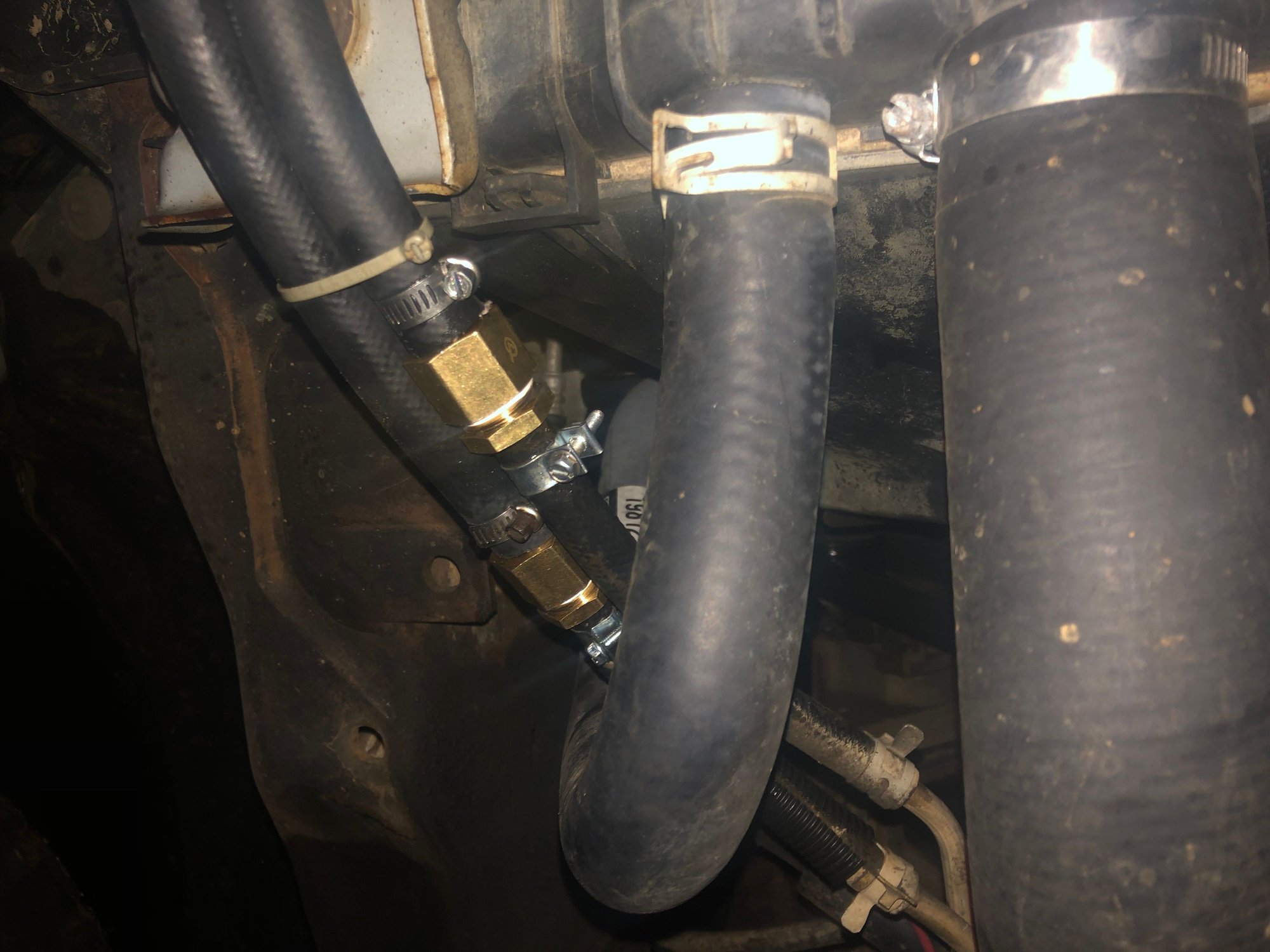

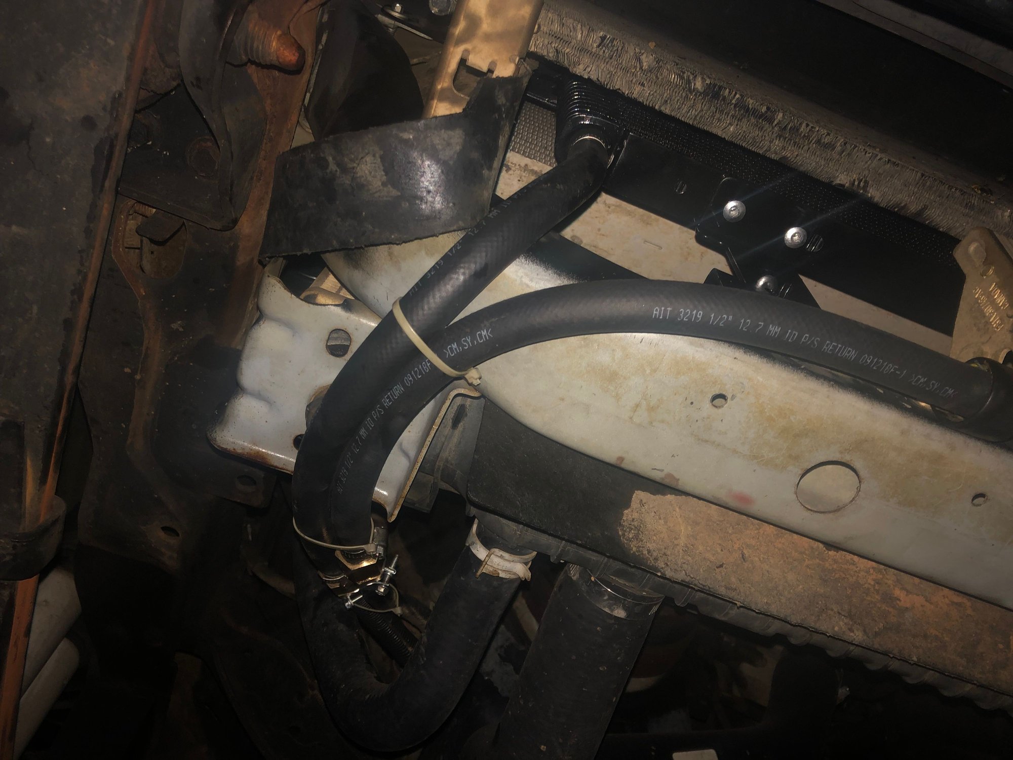

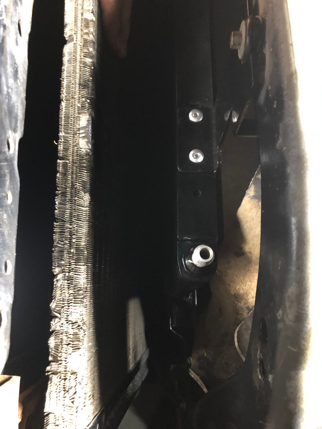

So I found a dorman 918-216 6.0 cooler at the Autozone hub and picked it up today after deciding I didn’t like the idea of throwing that cheesy Hayden auxiliary cooler on my truck. Bought some 1/2” power steering hose and stopped by the hardware store and bought a some 3/8 barb to NPT male and a 1/2 barb to NPT female for the change from 3/8 to 1/2. Finished it in just over an hour. I didn’t really get to take pics during the install cause I’ve got so much to get ready before towing the tractor and tools over to our lake property to work. But I snapped a couple of the final product. Took a 30 min drive and drove her kinda hard and my trans temp was just barely beginning to even register so I think this should have me fixed up.

Not bad man..good job. A word of advise though...either, loom or get heater hose and splice, to cover any trans soft lines that have ANY vontact with metal..etc. Doesnt take long for the constant rubbing to wear a hole.

already wrapped them up this morning. I was to tired to go digging through the shop for hose scraps last night. I’ll let y’all know how my temps do on sat.

Problem solved! 6.0 cooler makes a big difference, better than the Hayden. Just be sure to get the later radiator with the transmission oil cooler when it comes time to replace.

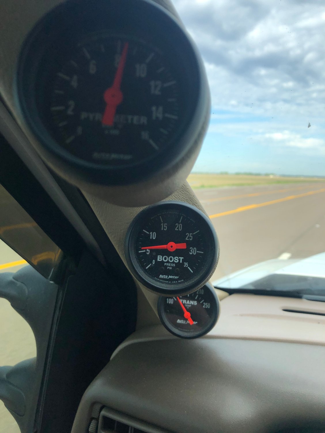

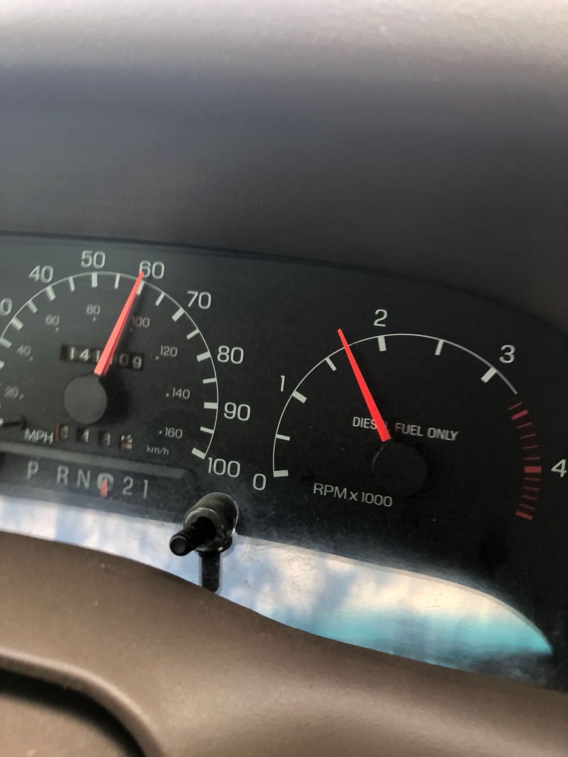

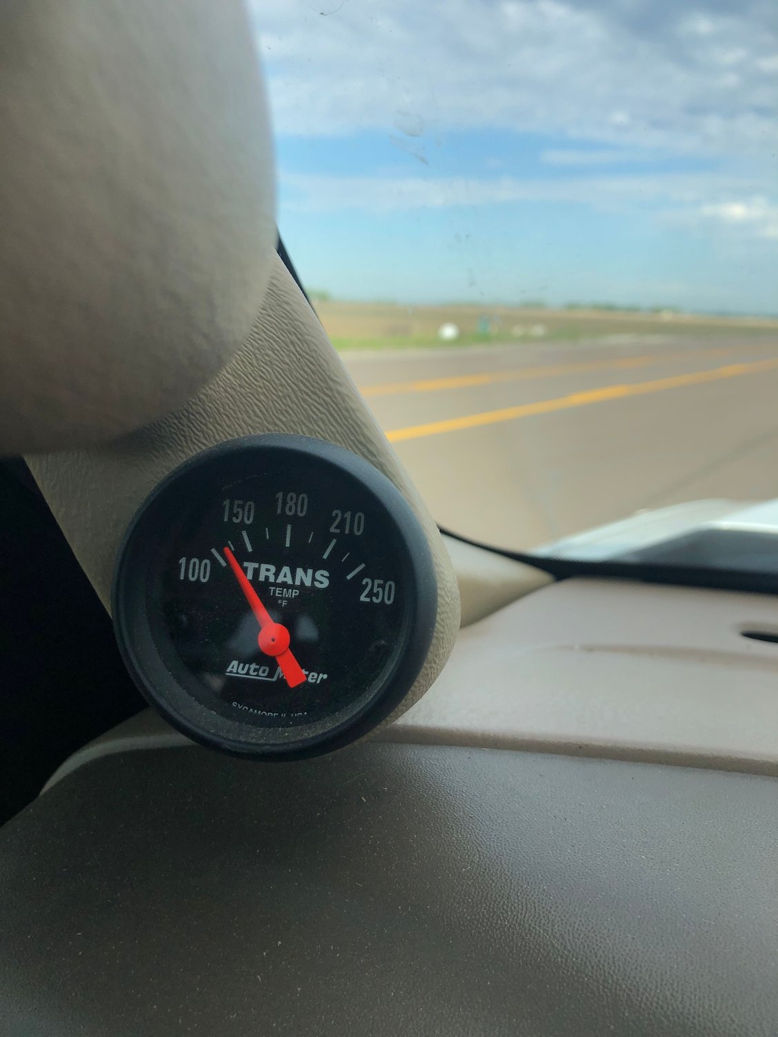

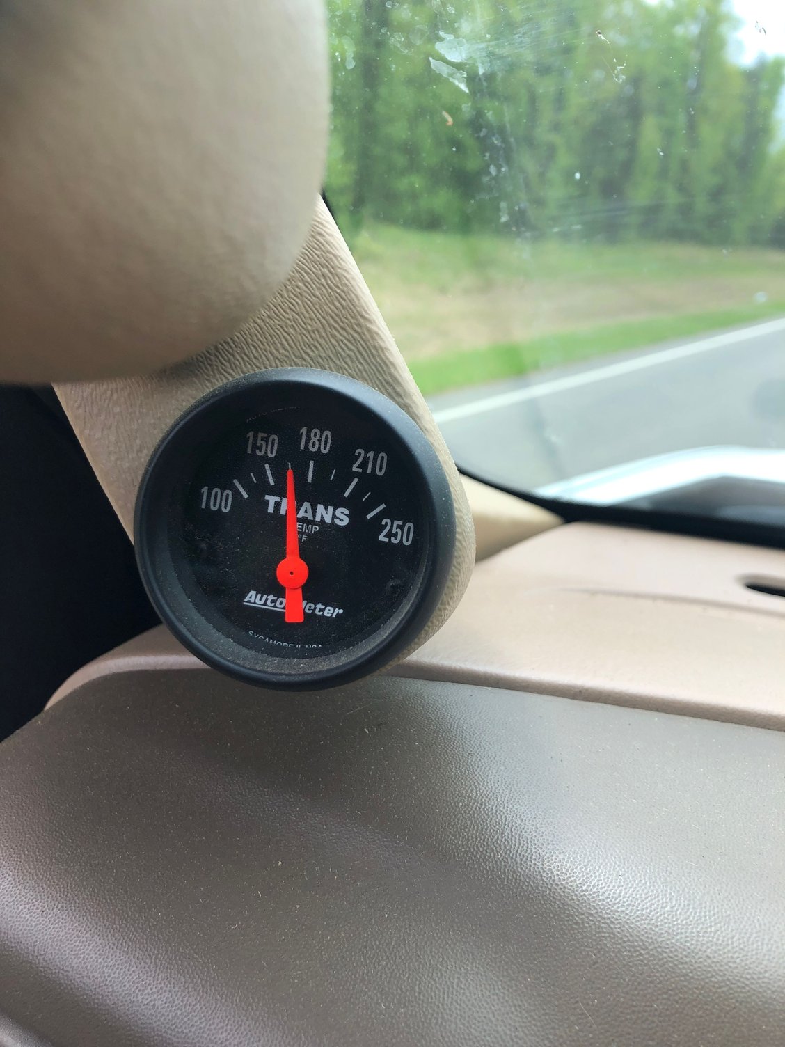

Sry I’m just getting back with the results of the new cooler been out of town a week and have **** poor service where I was. 6.0 cooler did wonders 12k pounds was nothing for it ran 160 in the flats hit 175 in the hills only cause I couldn’t roll on cause I was following my dad in his 82 F100 that was towing way more than it should and his was struggling a bit. Was nice being able to drive the truck however I wanted without constantly staring at the trans temp.

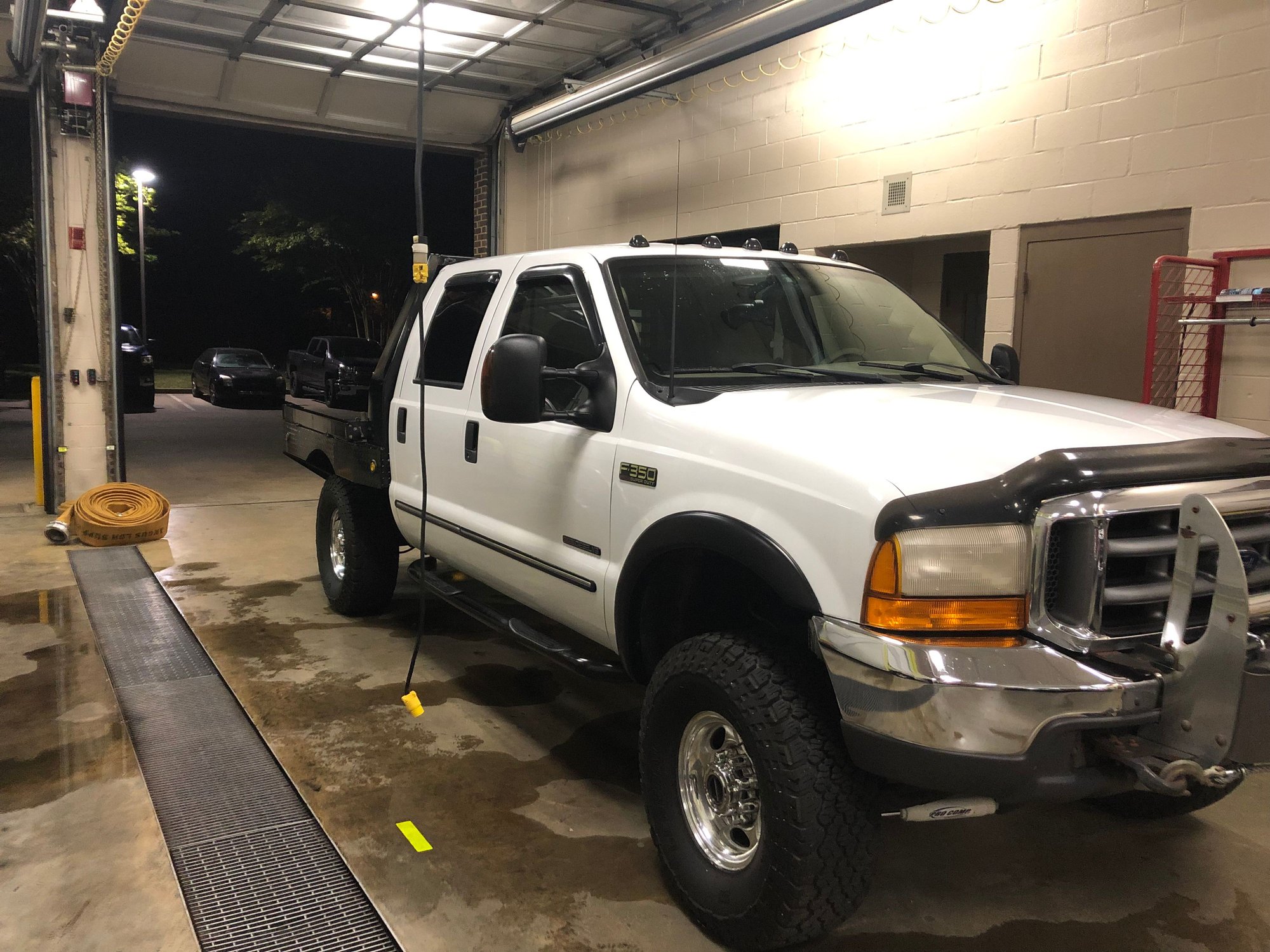

Cleaned her up good tonight at work.

I have the exact same gauge setup, just in a different order.
