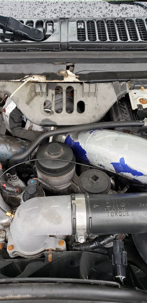

A motorcraft filter with a tall cap can be problems.
The OEM cap is about an inch high when measuring from the start of the threads. The aftermarket one is noticeably taller. A google search for "aftermarket filter cap on 6.0l" or "tall filter cap on 6.0L" should bring up a few links w/ pics.

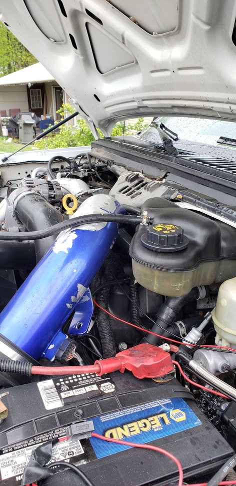

Take a few pictures of the engine compartment and post them here. Members usually can spot any irregularities and offer where to improve.

I'll get a picture after work. It is an OEM oil filter cap.

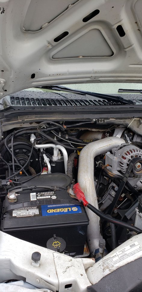

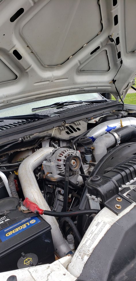

Here's some pictures of the engine bay as requested.

Old Apr 20, 2019 | 09:48 AM

I'll punch these up, but there are a low resolution.
From my perspective, you have a ton of potential issues with the added on wiring, so that should get sorted out. All terminal should get cleaned and closely inspected. You're right the oil filter cap appears to be stock unit to me. I would get a hew firewall harness plate to keep the wires farther away from the turbo. And you should get a stock air cleaner assembly. The coolant level is overfilled, it should be at the minimum level when cold. Not sure of the color of the coolant.
