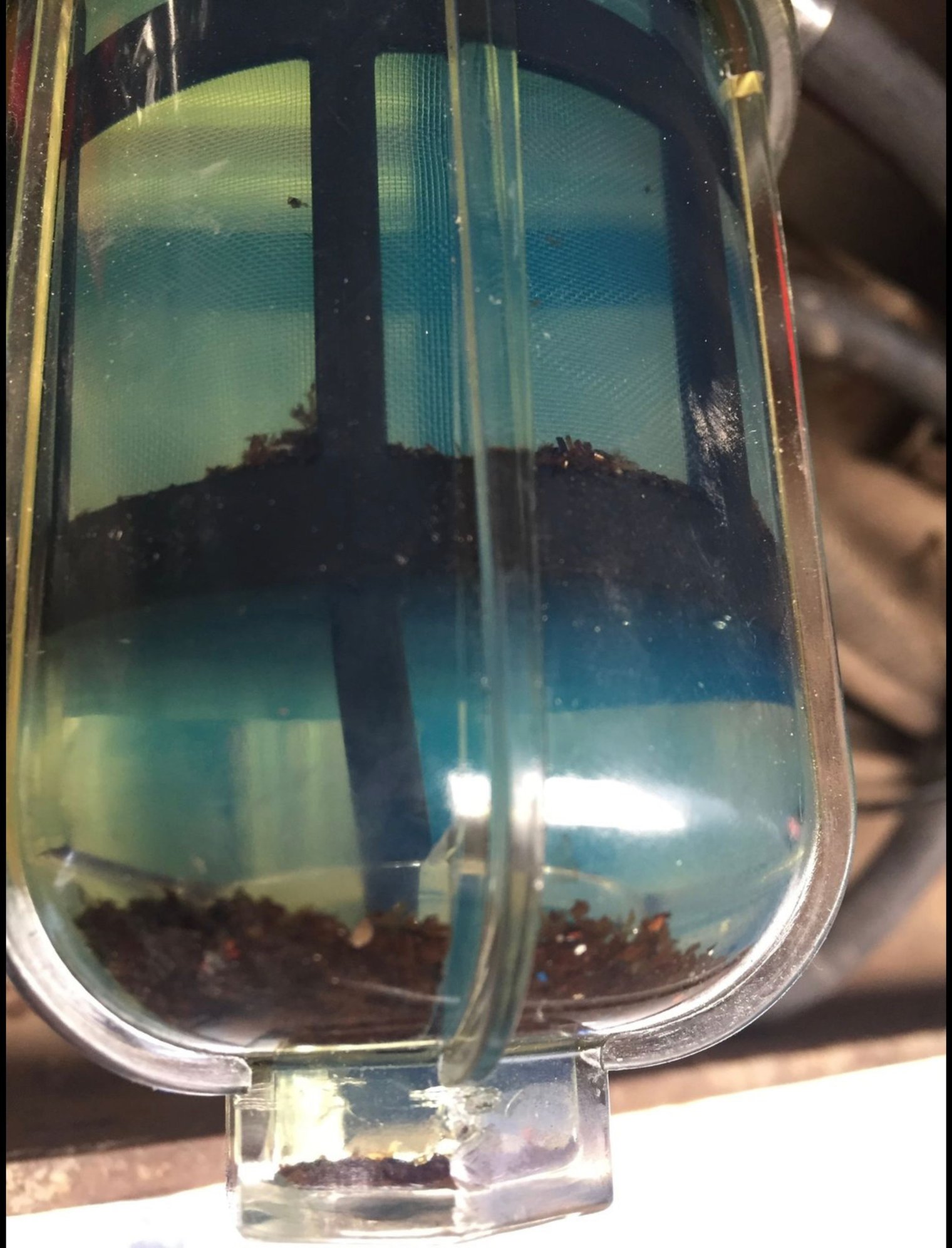

So something I just remembered after I did my H&H mod, this is what my filter look like after about a 5 mile drive you can see there’s a lot of debris that the Racor filter caught BEFORE it reached the pump. From my understanding there is a screen on the intake side of the pump and I’d be willing to put money on it that this debris would’ve plugged that screen up. You could remove the fitting from the intake side of the pump push on a 3/8 ID hose and see if the truck runs better pulling fuel out of a 5 gallon container. If it does then you know your issue is at the tank. If it does not I would probably start by seeing if you can blow intake screen out, then try the hose a second time and see if that fixes the problem. Then you will know that you had debris plugging the pump screen. This is how I would troubleshoot that problem …
Did you remove the screens in the tank or just clean them out or replace them ?

Since you removed the screens from inside the tank, you really need something in line to prevent plugging inside the pump itself, and the Racor PS120 is the perfect solution for many reasons:
- low cost
- protective screening
- no flow restriction to the pump
- huge screen surface area
- cleanable
- provides an observation window into exactly what your pump is seeing coming to it
- etc..
Your timing probably doesn't allow you to wait for a Racor PS120 to arrive, so you can always use a short term solution of a smaller and even cheaper inline filter with barbed ends. I would order the Racor anyway and install it later once it arrives. Just my personal opinion and recommendation, and you can certainly choose your own approach since it's your truck..
Now, onto your problem... You do seem to have a fuel flow issue which could be because either a hose is pinched, your pump coincidentally has decided it's just too tired to keep going and needs to be replaced, or both. My proactive maintenance minded philosophy would tempt me to toss in a new Bosch replacement pump, and if that is not the problem, it eliminates it from becoming the problem later on down the road. The other thing you can do is re-lift the bed and make sure your hose is routed where it cannot get pinched. Either or both of those efforts should clear up your issue.

Pete and John have your problem nailed, I would bet on it.
My Racor filter looked like the one John posted too, just not as much debris. I clean 8t about once a year now because I see crap settled in the bottom.
All of that crap would be plugging to pump inlet screen if it were not there. Your problem is most likely self induced.
