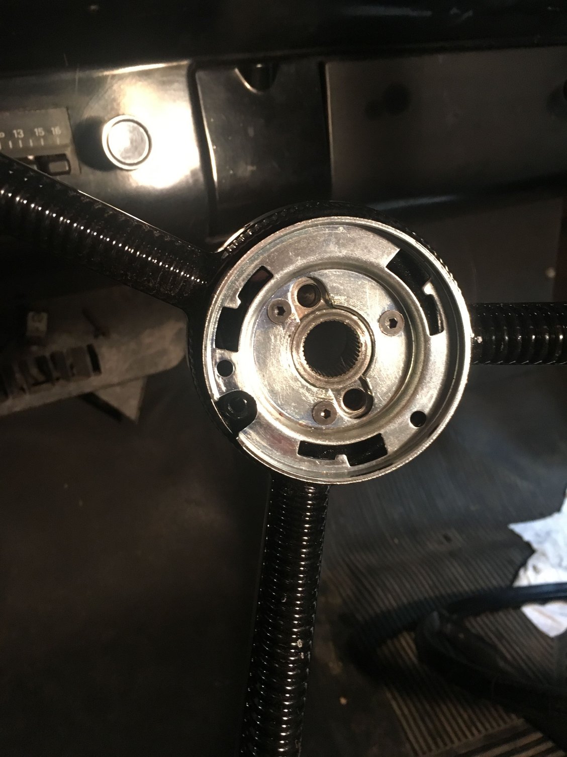

I think I see the hole in the steering wheel that you’re talking about but I will send these pictures to you just to make sure. Is it the same type of brush? Where do you get the second one if it is different?

When the outer horn button is removed, there should be a brush right there, fits into the dealio on the steering wheel. It's not in the pic?
The second brush is visible in the other pic. The brushes themselves are identical pretty much.
My truck needs to tighten up the gap just a little. The lower brush died, after replacing that, have the steering wheel nut about as tight as I dare. Not sure what the deal is.

When the outer horn button is removed, there should be a brush right there (I said this in post #10), fits into the dealio on the steering wheel.
It's missing.
See 13A821 above the steering wheel in the pic. 13A822 is the insulator. Brush/insulator was also used with the horn ring, also on 1971/72's w/the horn pad.
