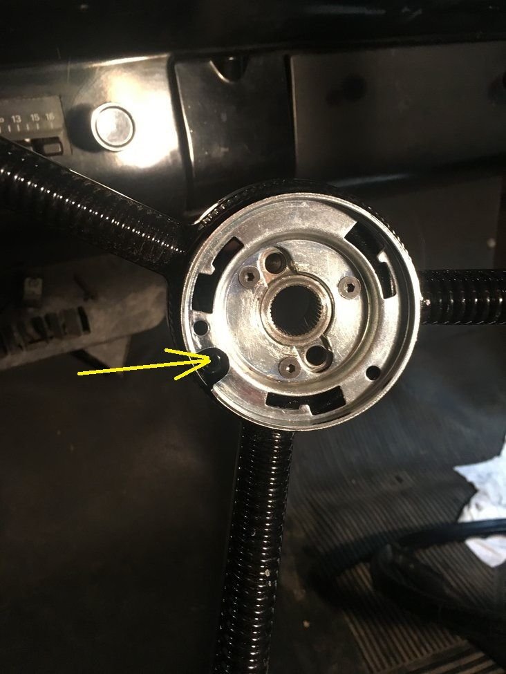

Horn button not working
I will get another brush for steering wheel. Not sure about the insulator don’t know if it’s already built in or if I need to find that too ?

I drew a yellow arrow to what looks like the plastic insulator here. It looks like it is already installed to me, but you are much closer to the action.
Chad
