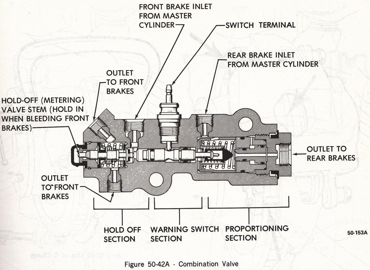

I assume you mean wheel cylinders when you said solenoids. Start there make sure your lines are tight and bleeder screws are tight. Check front brake lines too. Looks for fluid on all the lines. Check your distribution block, located by your steering box mounted on the BIG cross member, for a leak. When you started the brake job did ALL of the fluid drain out? If you only added half a quart I would say you just introduced a HUGE amount of air in your system and you have a lot of bleeding to do.

I'm all about old stuff, but one thing I've learned that isn't cool is the old antiquated brake proportioning valves on our trucks, and my jeeps. I've recently gotten rid of all of them. I plumbed front brakes direct to master cylinders, and used adjustable proportioning valves on rear brakes only. It's made a hell of a difference on all three vehicles.

I'm all about old stuff, but one thing I've learned that isn't cool is the old antiquated brake proportioning valves on our trucks, and my jeeps. I've recently gotten rid of all of them. I plumbed front brakes direct to master cylinders, and used an adjustable proportioning valves on rear brakes only. It's made a hell of a difference on all three vehicles.
Thats a genius idea

Yeah, but I'm not the genius. I saw it on another vehicle years ago. The only reason it took so long for me to do it is I was afraid of making brake lines. Turns out it's so easy, and actually fun to do.
