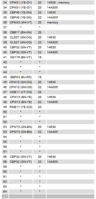

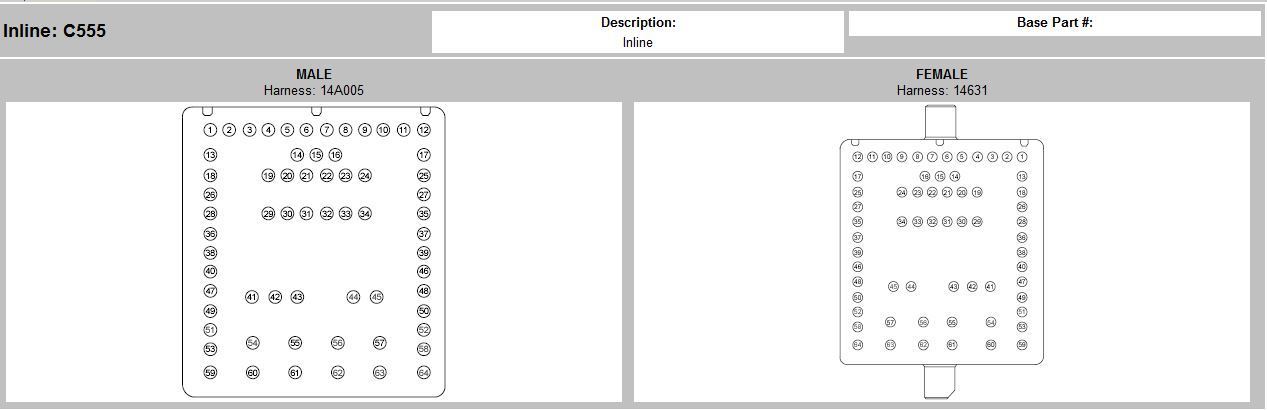

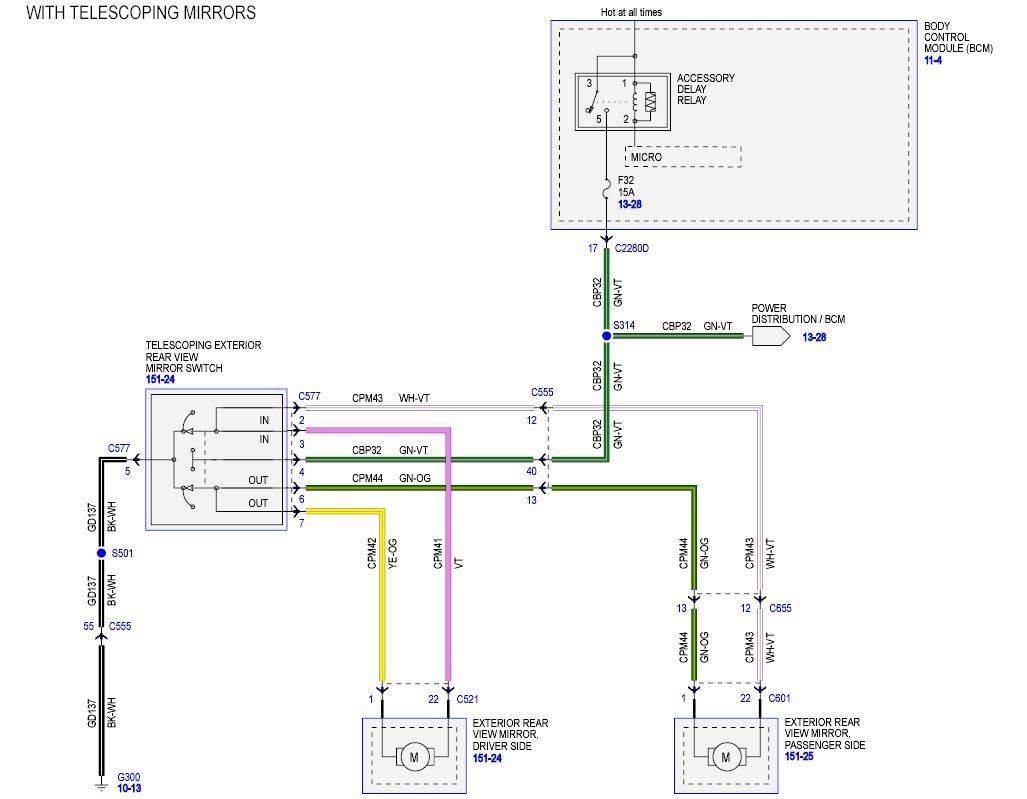

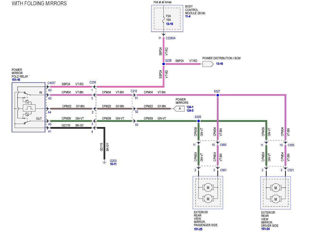

Here are the wiring diagrams.....

Seth, yes, the foglight was easy as Ford did sell a kit to add foglights to the XL/XLT trucks on the Ford Accessory site. The wiring might be there but I highly doubt in for the mirrors.
You could check the door plugs to see if there are pins or wires shown above or on this drawing.
