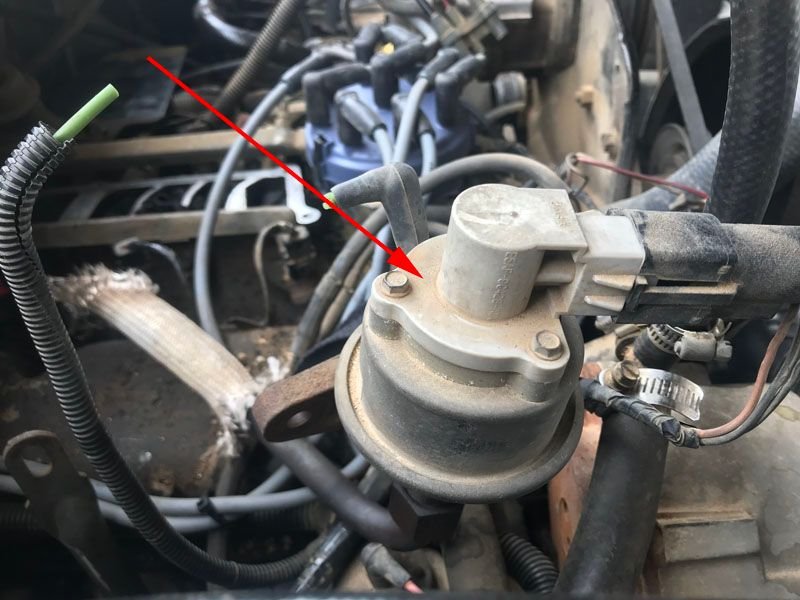

First picture:
What is this friggistat?
It's the thing the snapped green little hose connects to.
Is that maybe part of the smog control system?
It seems like some sort of blowby something or other.

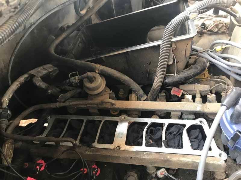

It connects to the gizmotron in pic 2 depicted by the arrow.
If it's all to do with the smog set up, then it probably doesn't matter since the smog pump isn't inline anyways.

Looks like your EGR valve, was it bolted the the plenum? And the other part is your solenoid bank. Runs the vacuum accessories via computer input.
