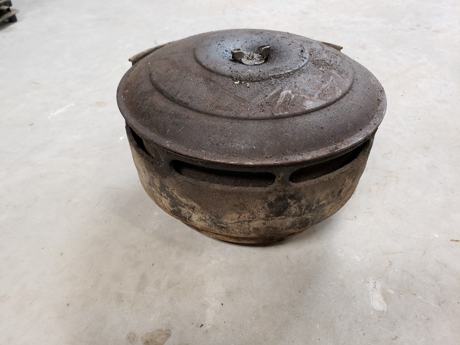

Thanks for the tip, however...im not sure what air intake i need. One didnt come with the truck. Any pointers on that?

The correct truck carb and matching air cleaner have a unique mounting surface at the top of the air horn compared to the car versions. It's a more positive gripping system, presumably for the higher vibrations one might see in a truck application. Because of this, the shiny aftermarket air cleaners the vendors sell for flattys won't work on truck carbs. They're made to slip over the flatter sides of the air horn on the car carbs.
Truck carb
Car carb
Here's an original truck air cleaner on ebay, although imho his price tag is a bit steep. These typically sell for under $50.
https://www.ebay.com/itm/1948-to-195...UAAOSwuWJb24sL
