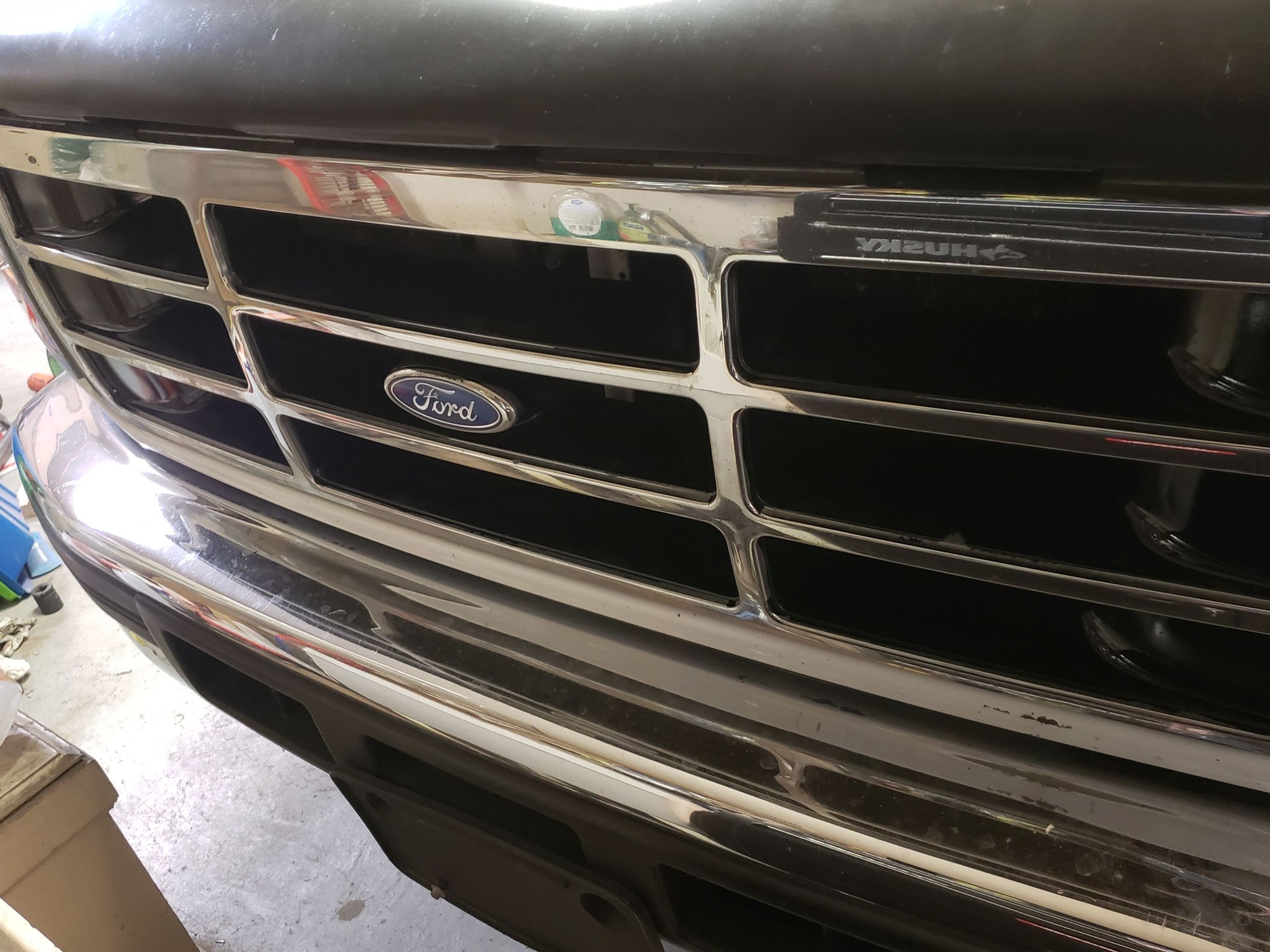

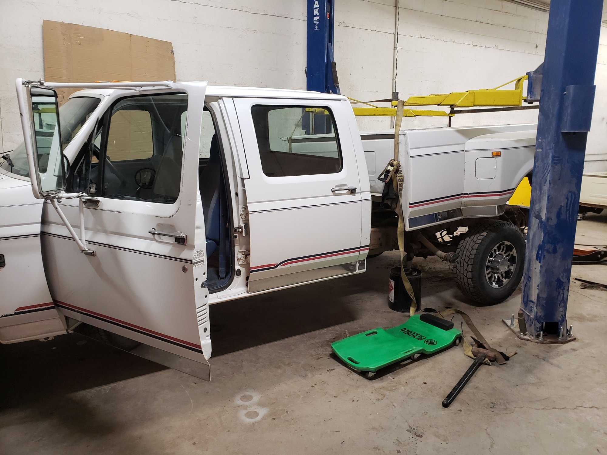

Betty White

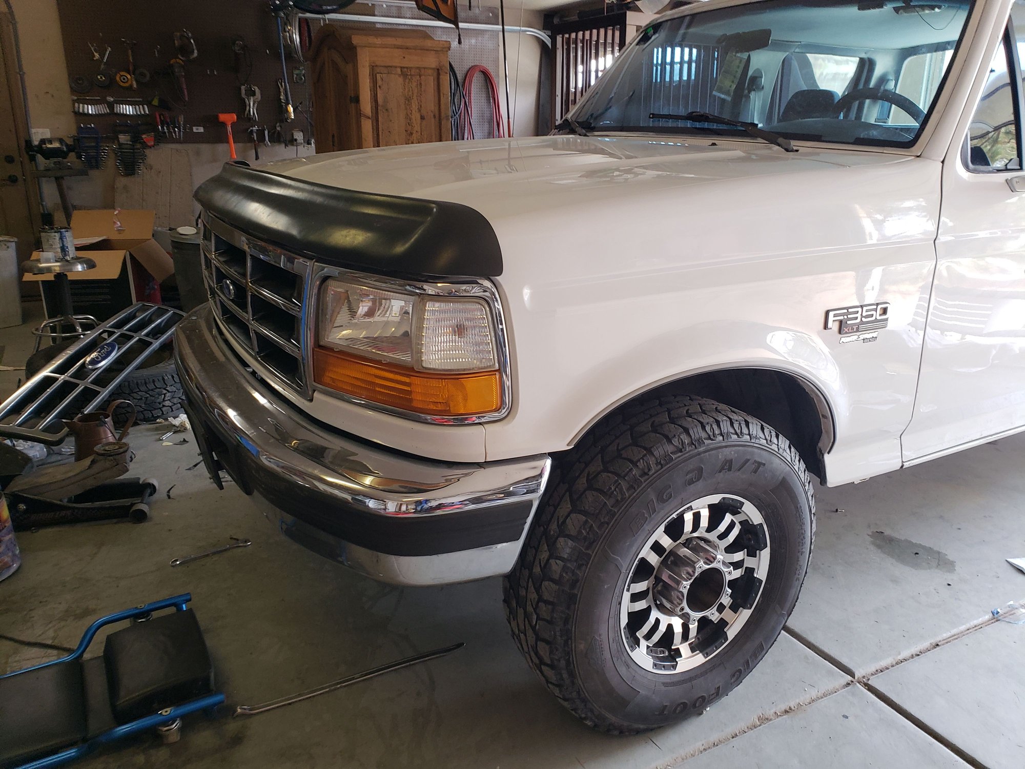

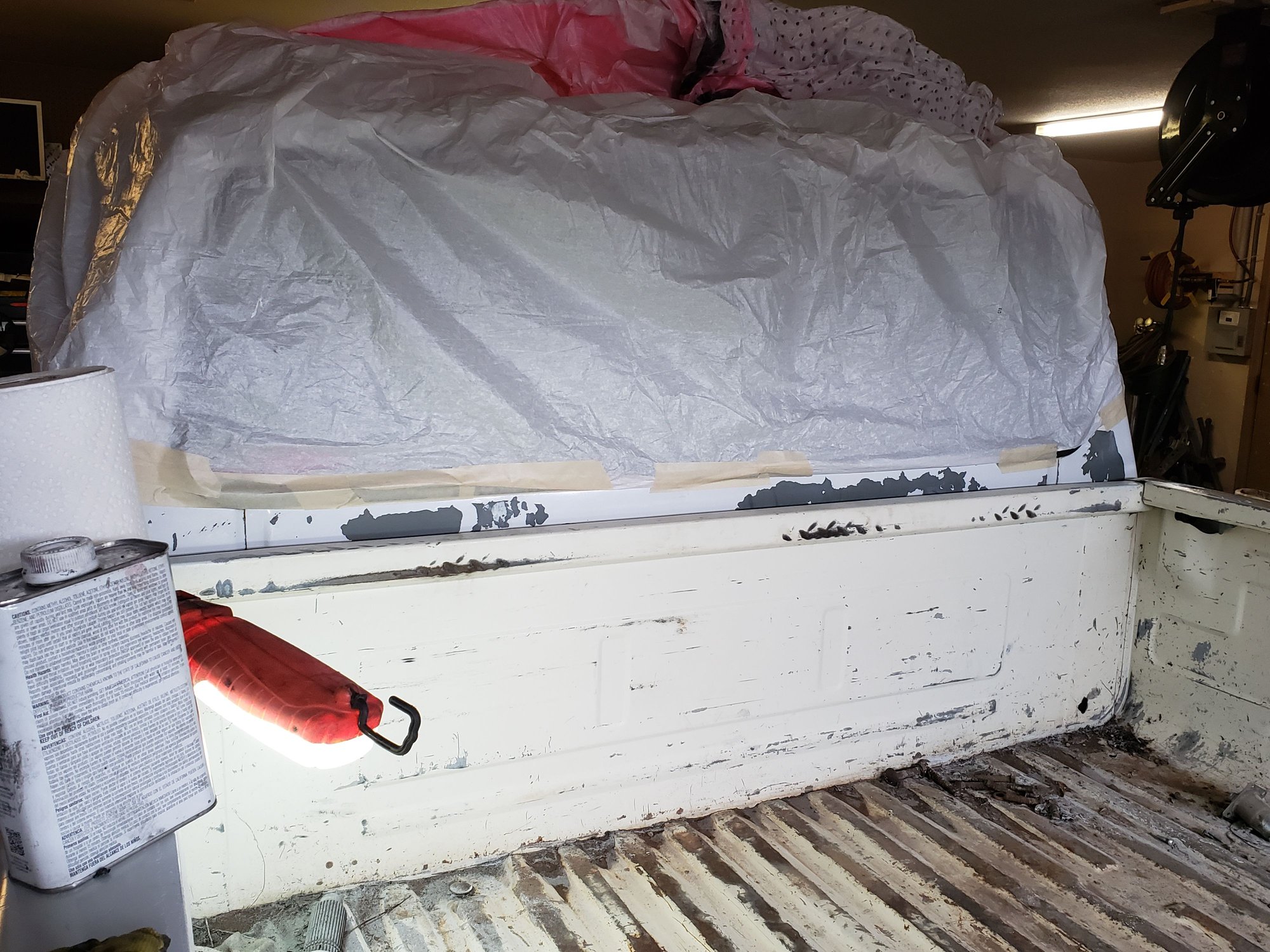

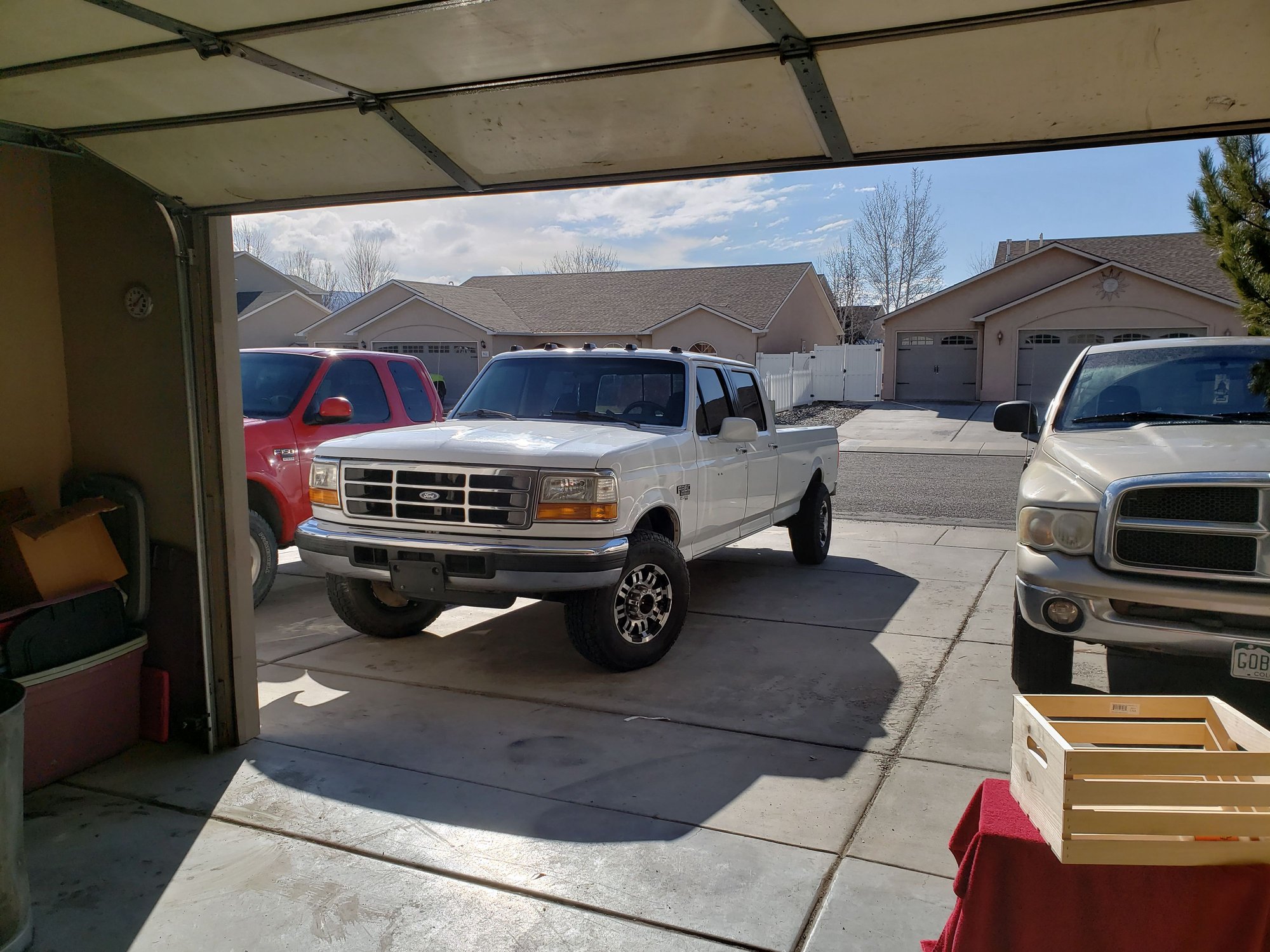

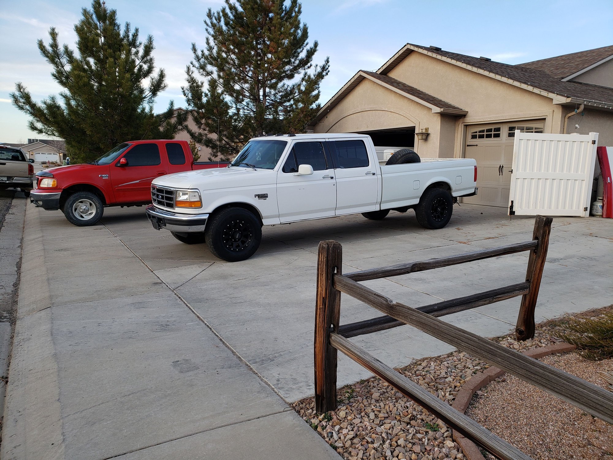

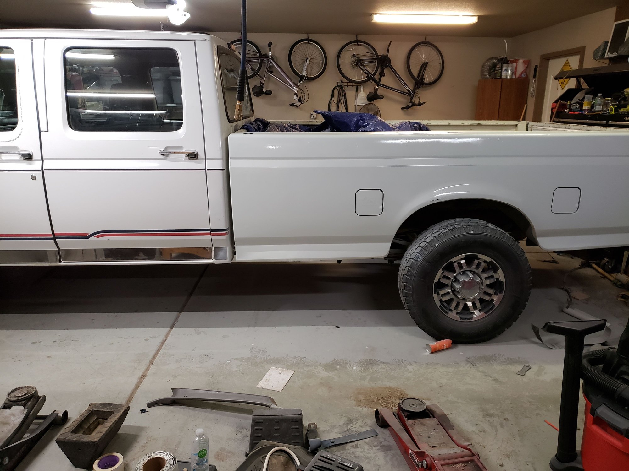

Picked this thing up. Gonna use it as a DD. 95 4 door long bed dually, 2wd, auto, 205k. Tried to fit it in the garage and wouldnt fit so I did a DRW to SRWswap. Found a SRW bed for $100, swapped the bed and then paint match rattle canned it. Then clear coated it. Also found a D70 Srw out of a 2003 Ford E350 with disk brakes and 8x6.5 bolt pattern. Also started cleaning the crap out of the entire interior. Lifts make things so much easier.

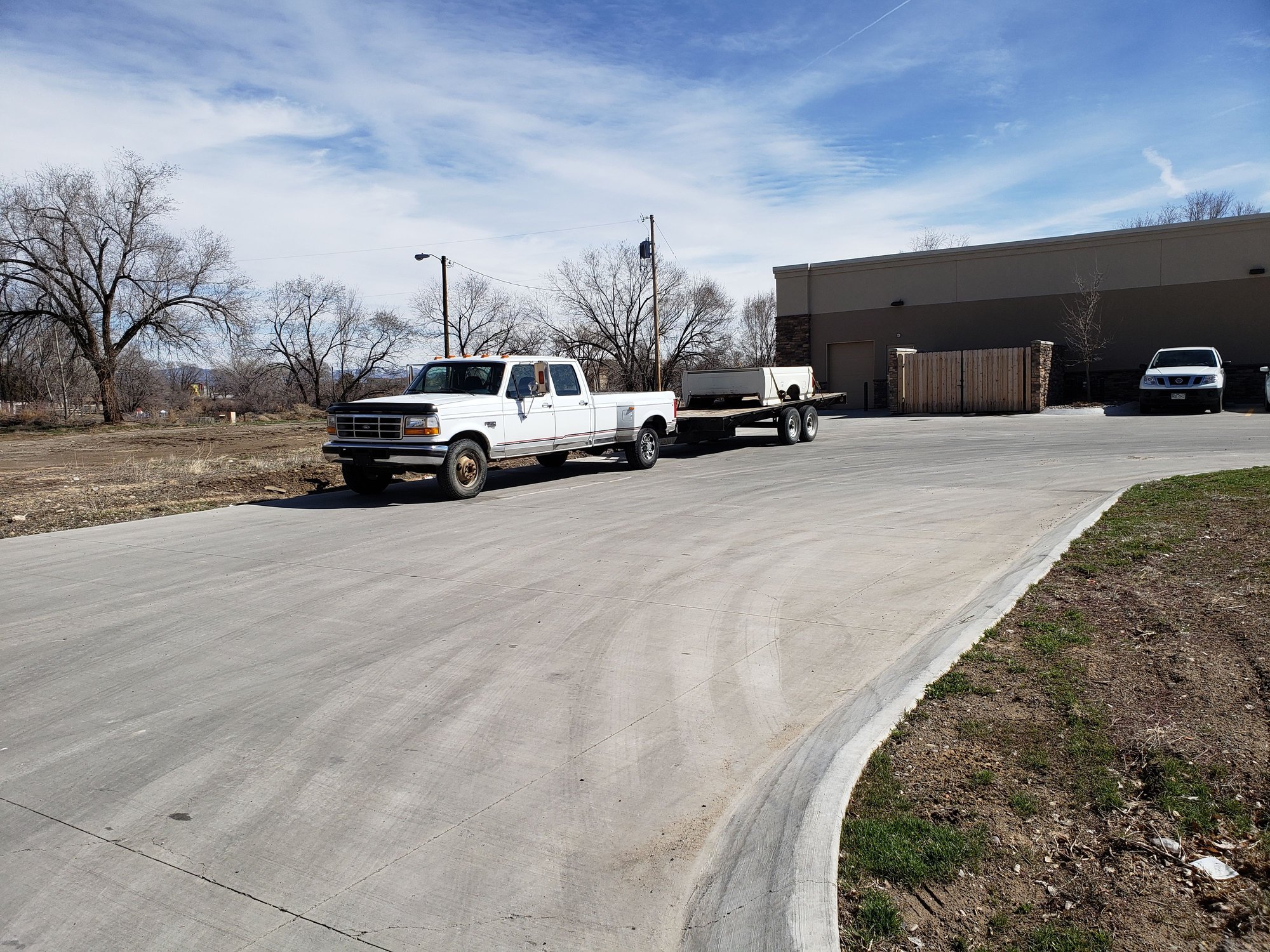

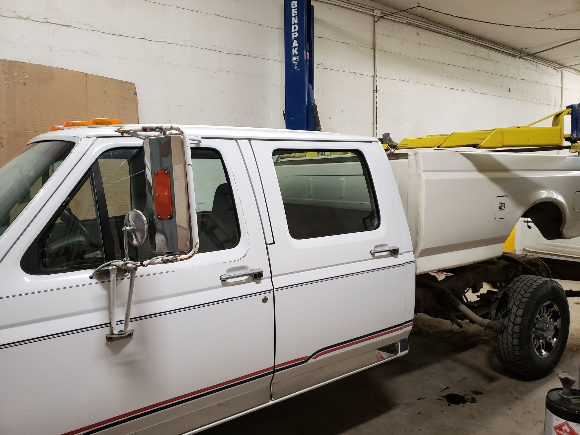

Had to make a few adjustments to the rear end, redoing brake lines and had to narrow the spring perches 2.5"s on each side. Wasnt too bad with a plasma cutter, cutoff wheel, and a portable band saw. Little before and after.

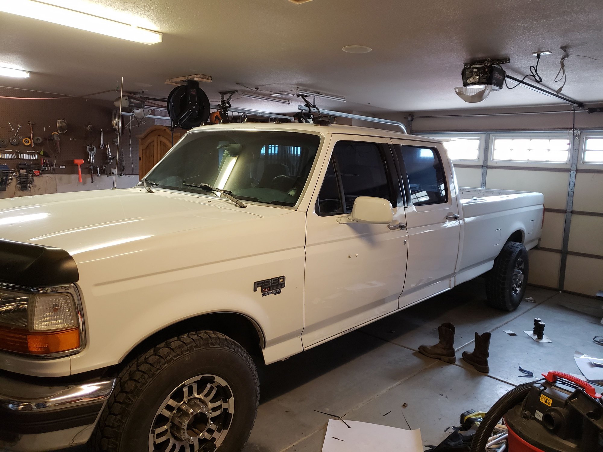

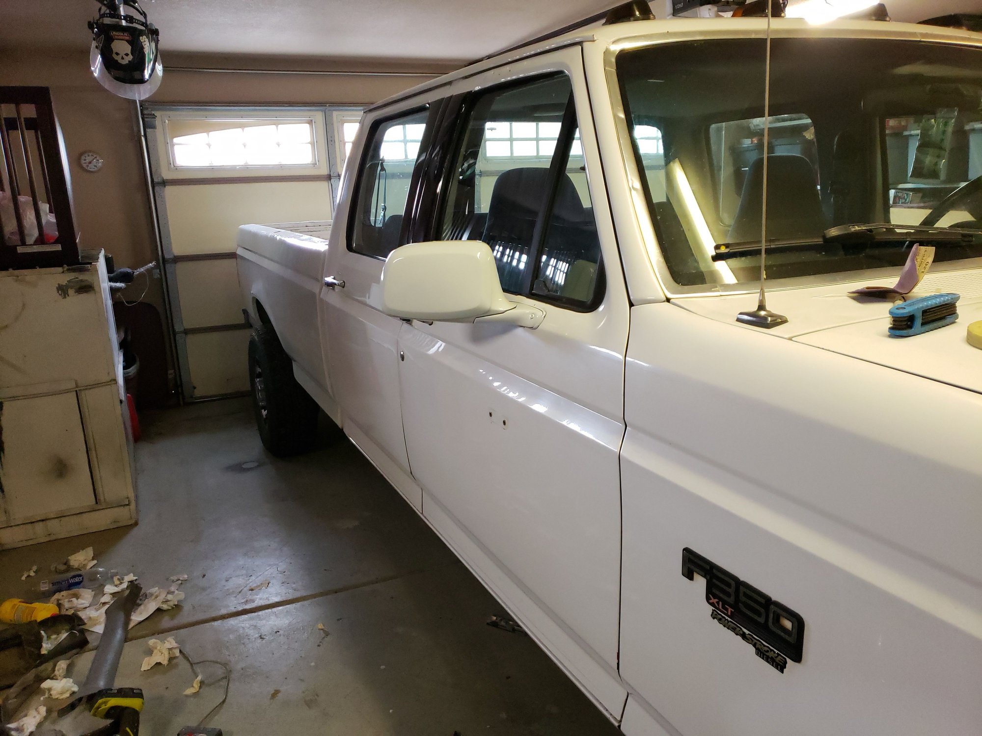

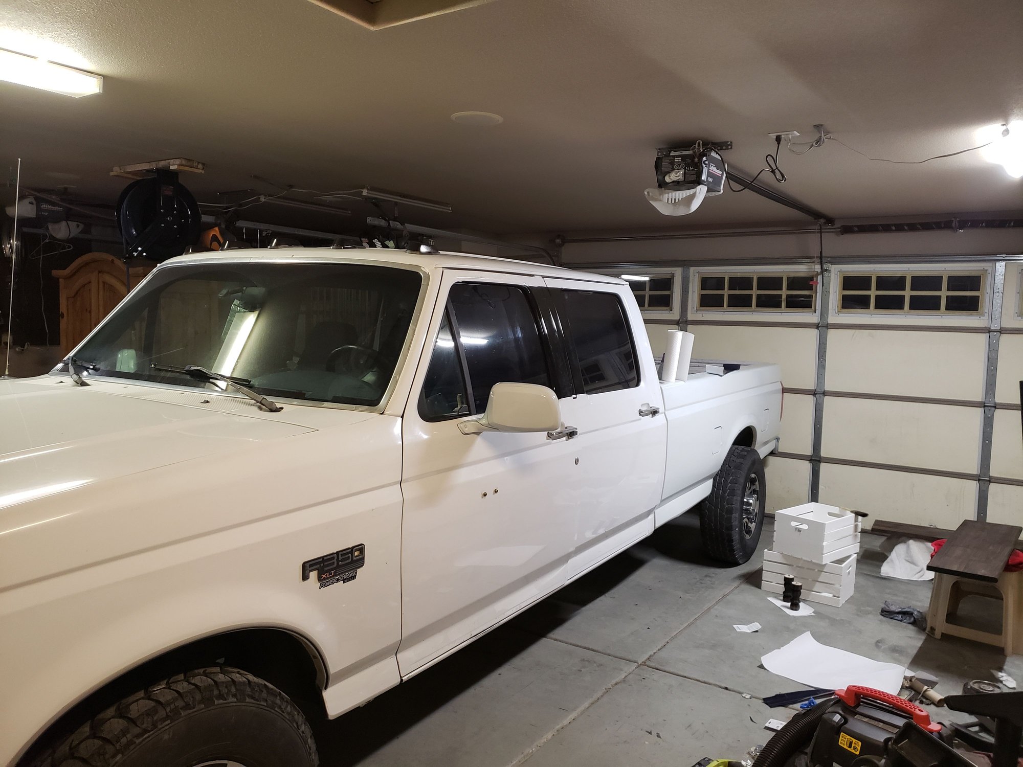

Swapped the rotors from DRw to SRW up front, then got to cleaning up the exterior. Eraser wheeled all the pin stripping off. All 200 linear feet of it. Also found some passenger mirrors to swap and paint match. Also painted the b pillar black. Thatll come in later.

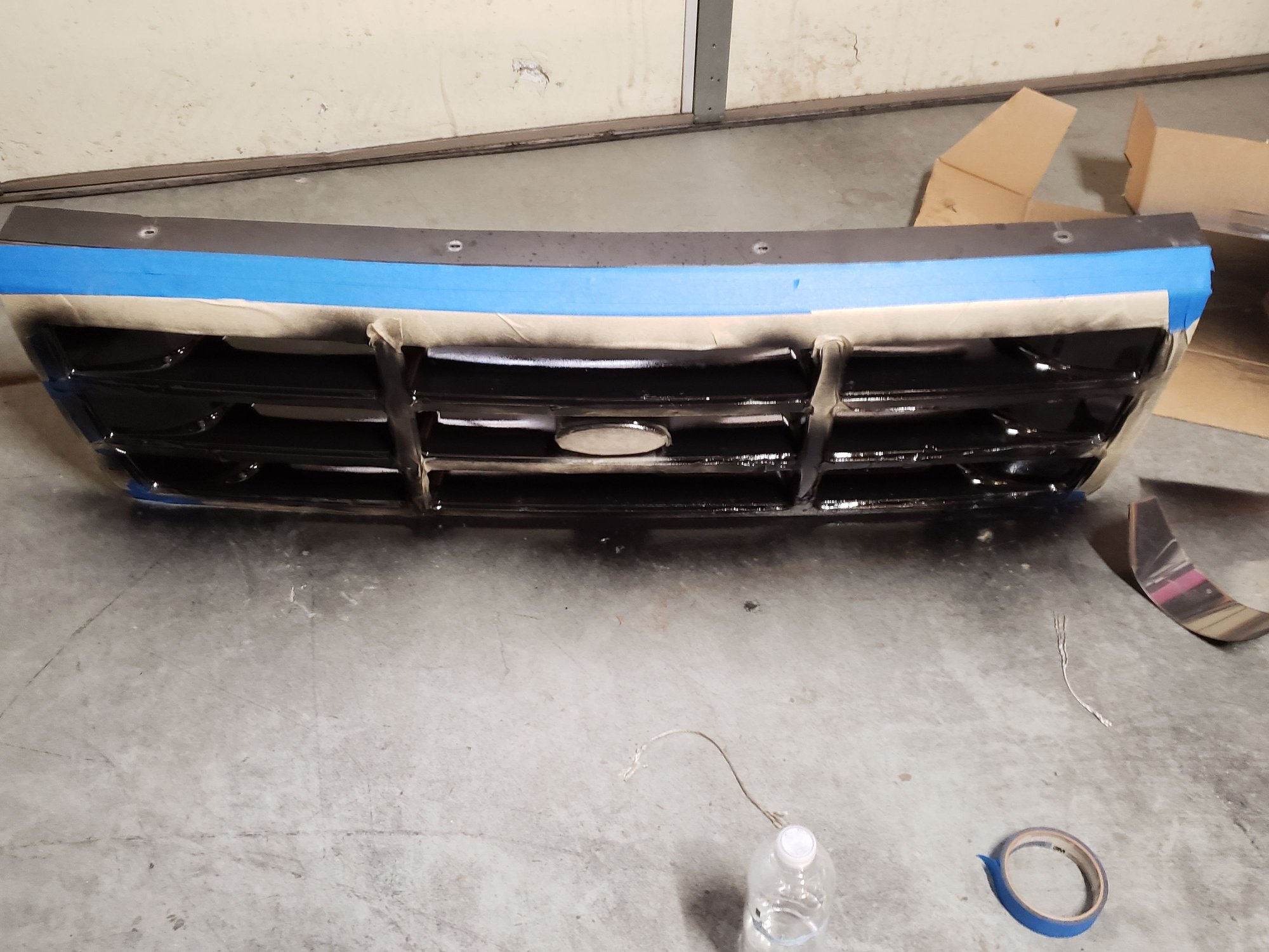

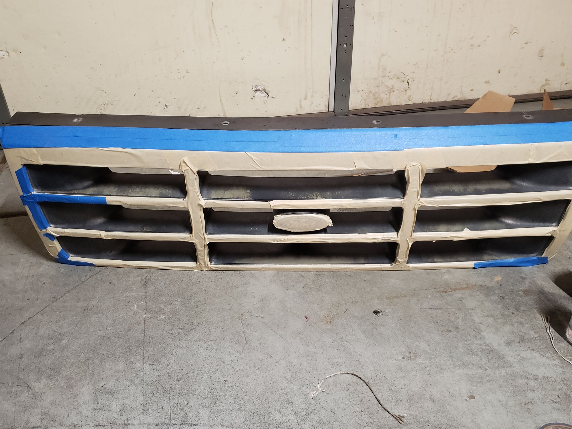

Got some more Things masked off and painted up.

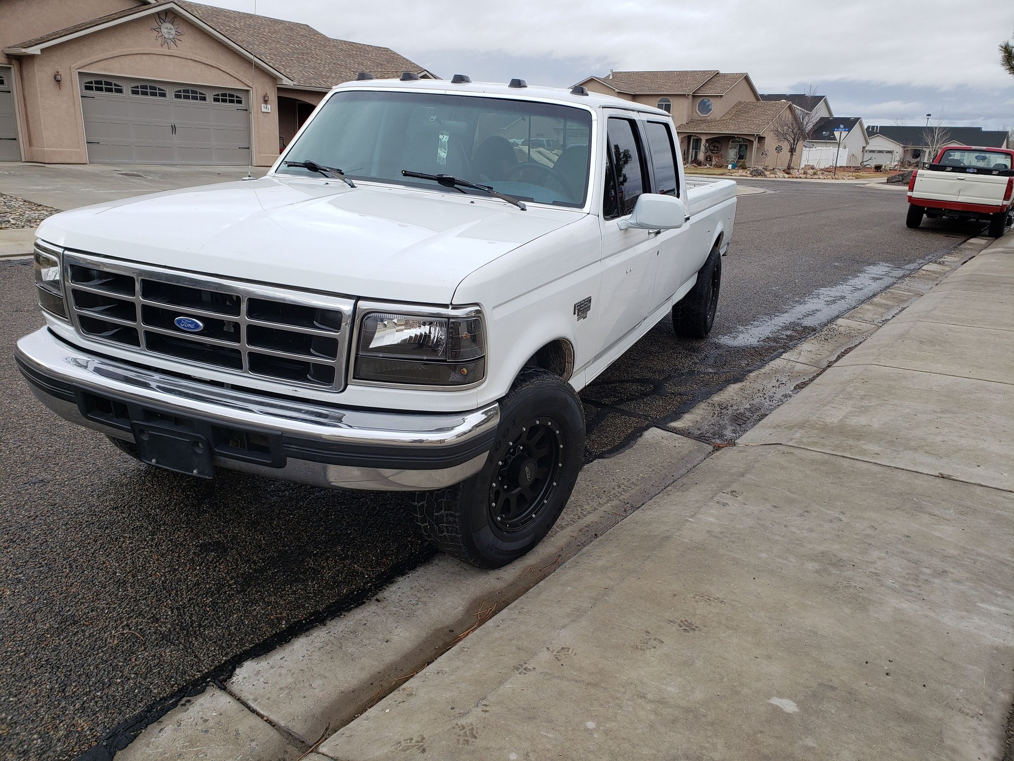

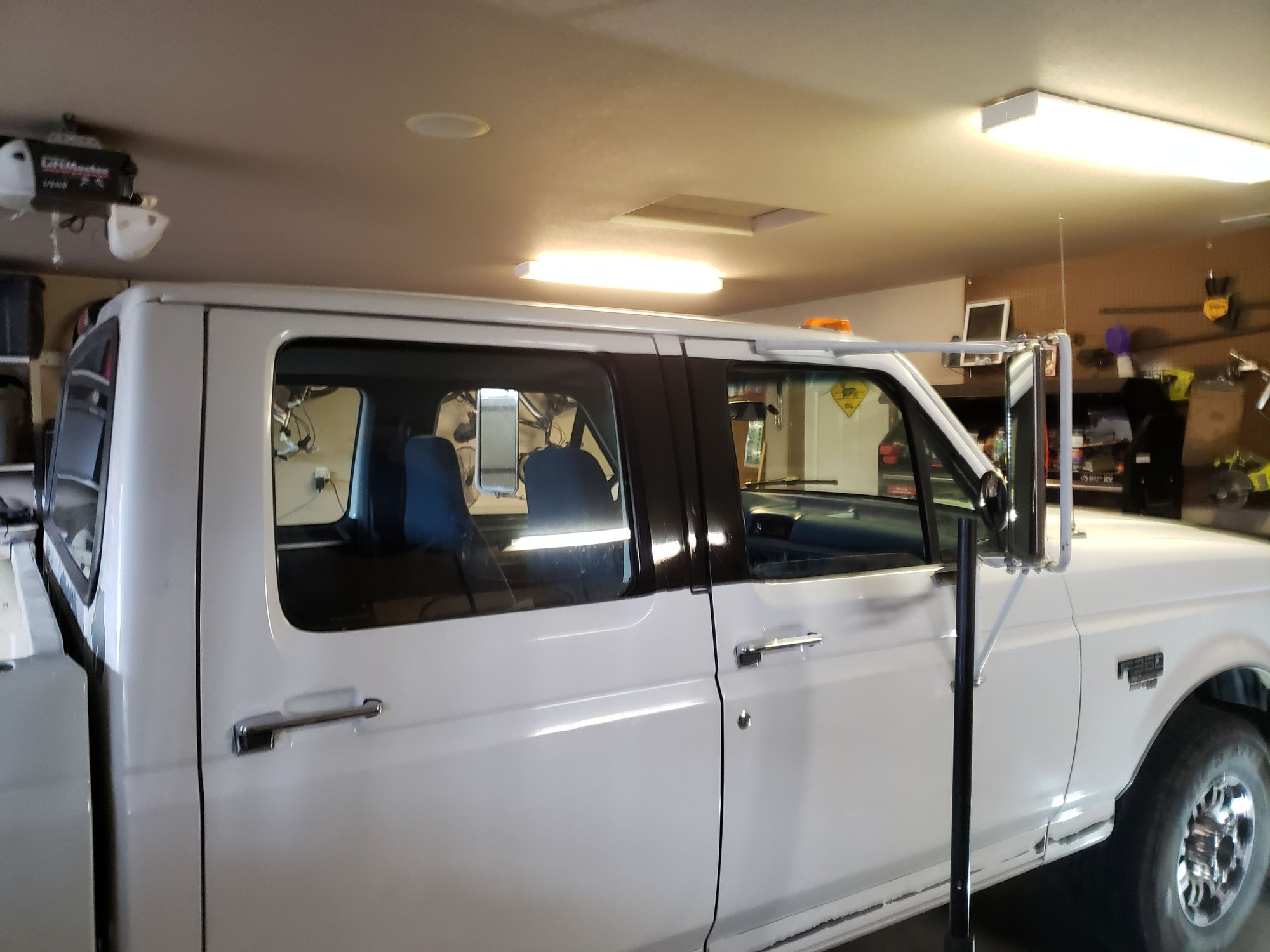

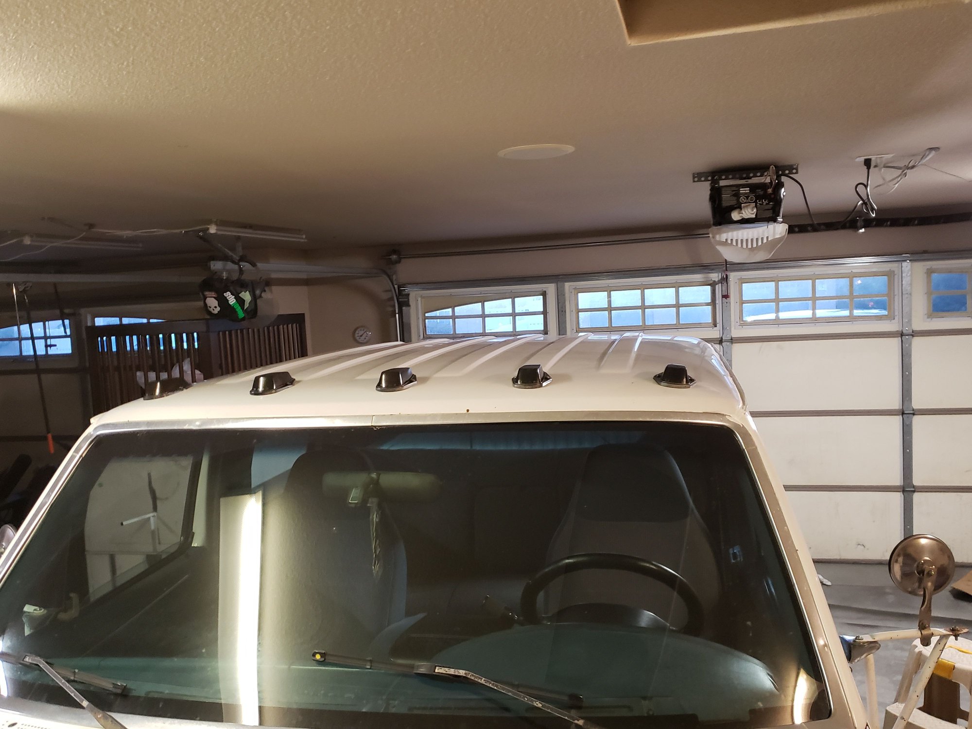

Blacked out the clearance lights, finished the tint and fixed the bumper sag.

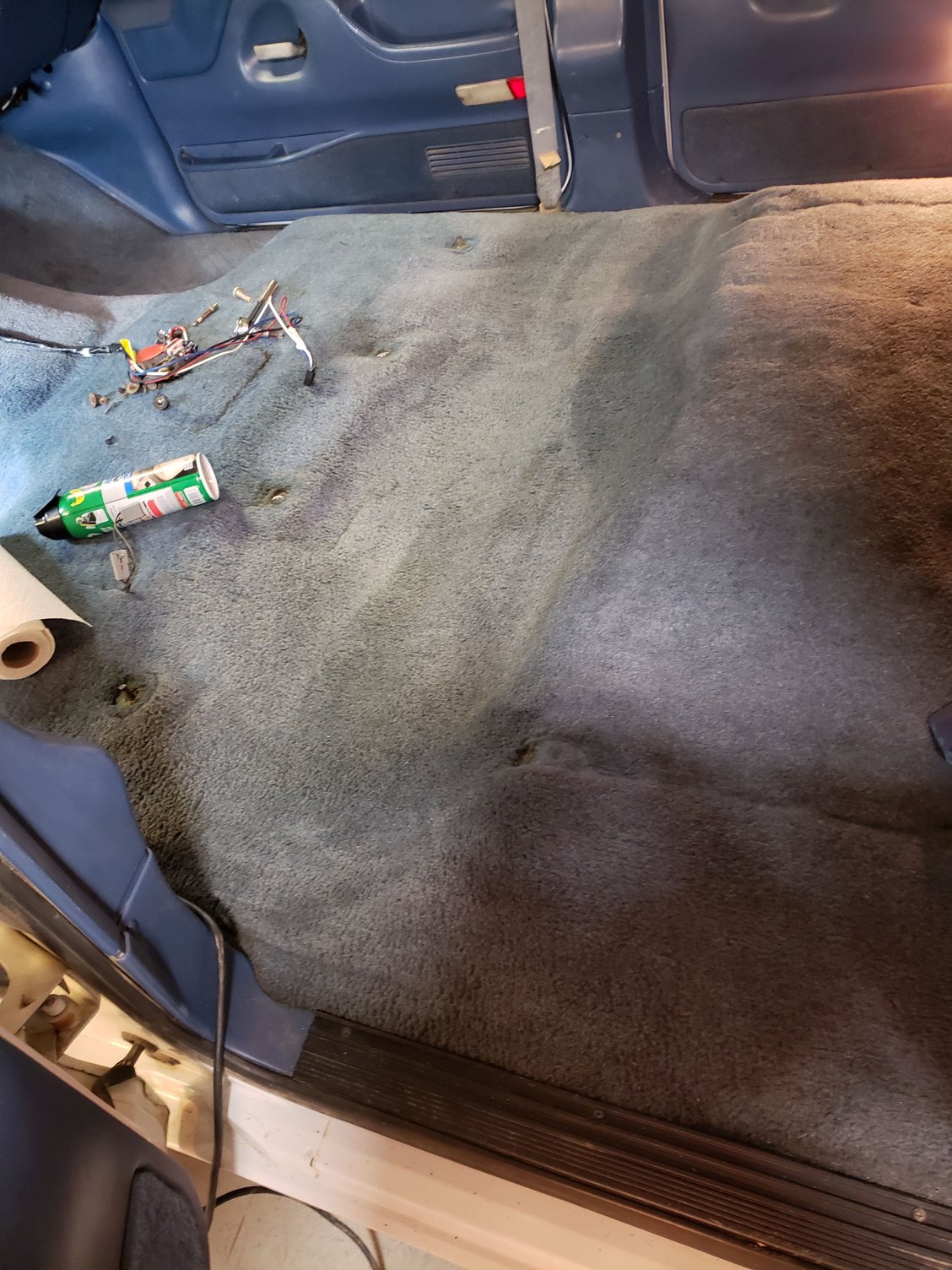

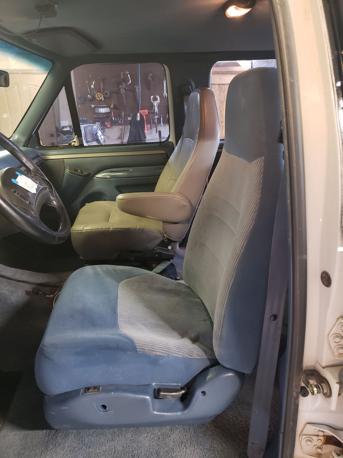

started doing a leather interior swap, rewrapped the steering wheel, found some black wheels and tires.

swapped front headlight housings.
