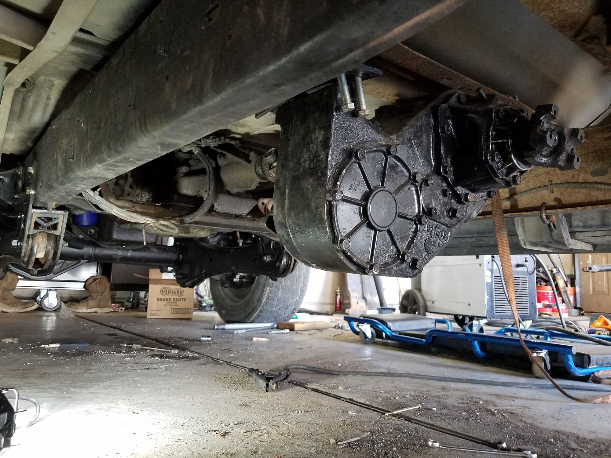

Originally Posted by z31freakify
Nice, yeah I was talking about the bracketry. What vehicle came with the divorced NP205? Im scoping to do my obs 4x4 after my last camping trip.
Could be wrong but I believe 70s ford Highboys.
Tcase in question after fresh rebuild.

Old Jul 18, 2019 | 02:48 PM
  #72
Ezalycasaid's Avatar
Ezalycasaid
Joined: May 2015
Posts: 1,002
Likes: 38
From: State of Delusion.
Taking longer than I want but at least it's in place. Need to get the brackets finalized and cleaned up.
