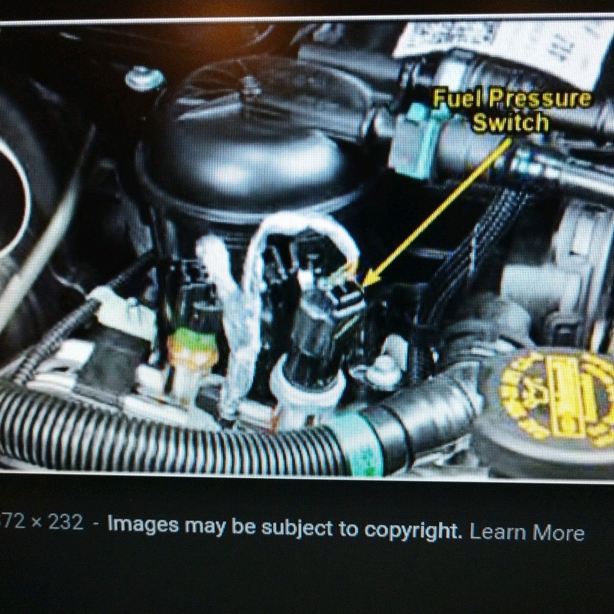

Check the fuel pressure switch as they are now starting to come apart on some.

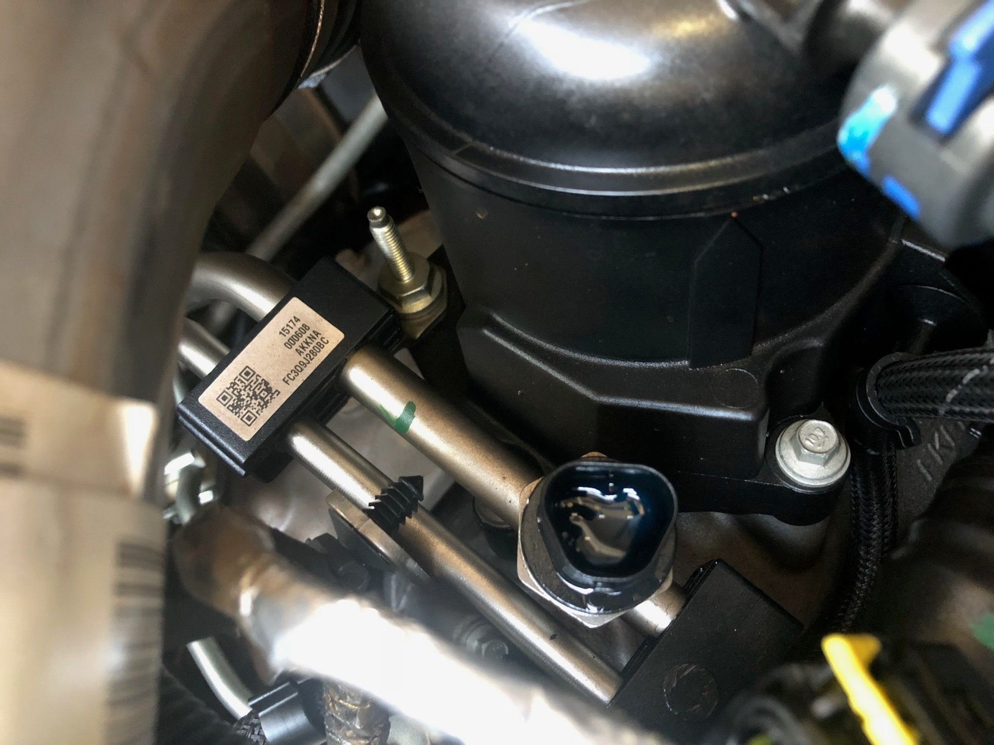

So with a better light and the info above i don't think injector or hold down . its puddling right under the pressure switch mentioned above but not coming from there ..i tend to think it's the secondary filter?

Pics aren't great but no fuel coming from that switch inside or ooutside ..filter connections are dry too ..maybe cracked housing?

Carefully pull the two lines and remove the filter to inspect the filter housing. The lines will drip some so have a towel ready so you don't complicate narrowing down the fuel leak. If it's good, once completely reconnecting and latching (you don't want those lines leaking while accelerating!), go through the air purge process.
There is a small bolt that clamps the filter in place (at least on my 2011 there is). Once that's loosened, turn the filter housing so it can be removed (there is a hook on the bottom). None of this requires force.

Thanks all for the education. It was the engine mounted filter. I didn't understand how it was all put together until I took it apart...makes perfect sense now. And I really appreciate no one hating on this newbie. Seen that on too many forums. Admittedly, it's been over a decade since I really turned 🔧 on cars, had a few quick fox bodies before I had kids. Once again, it's really appreciated.
