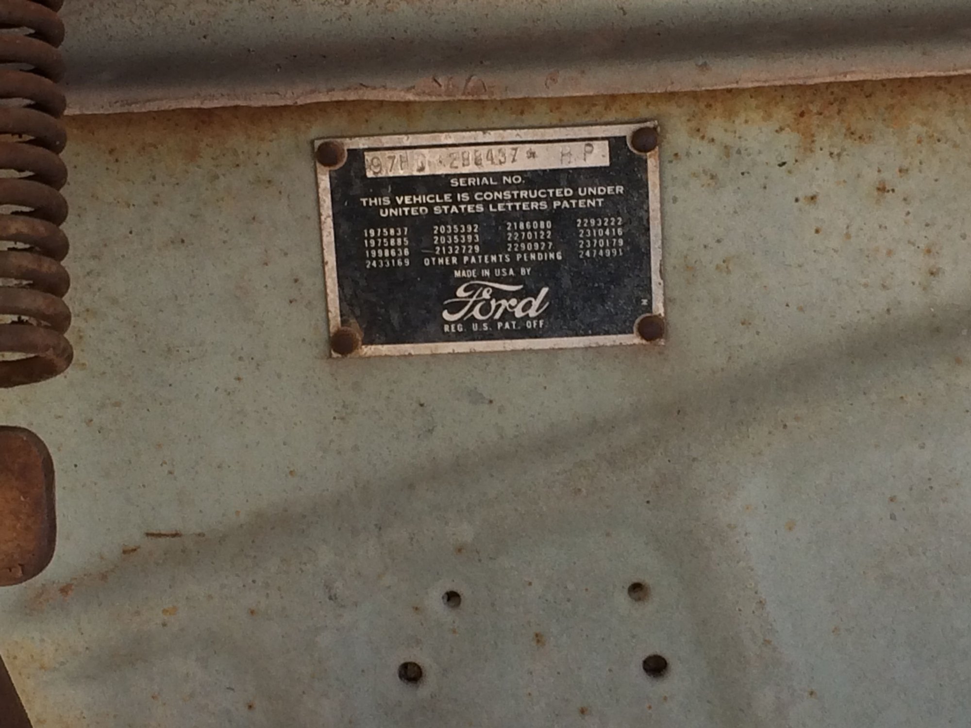

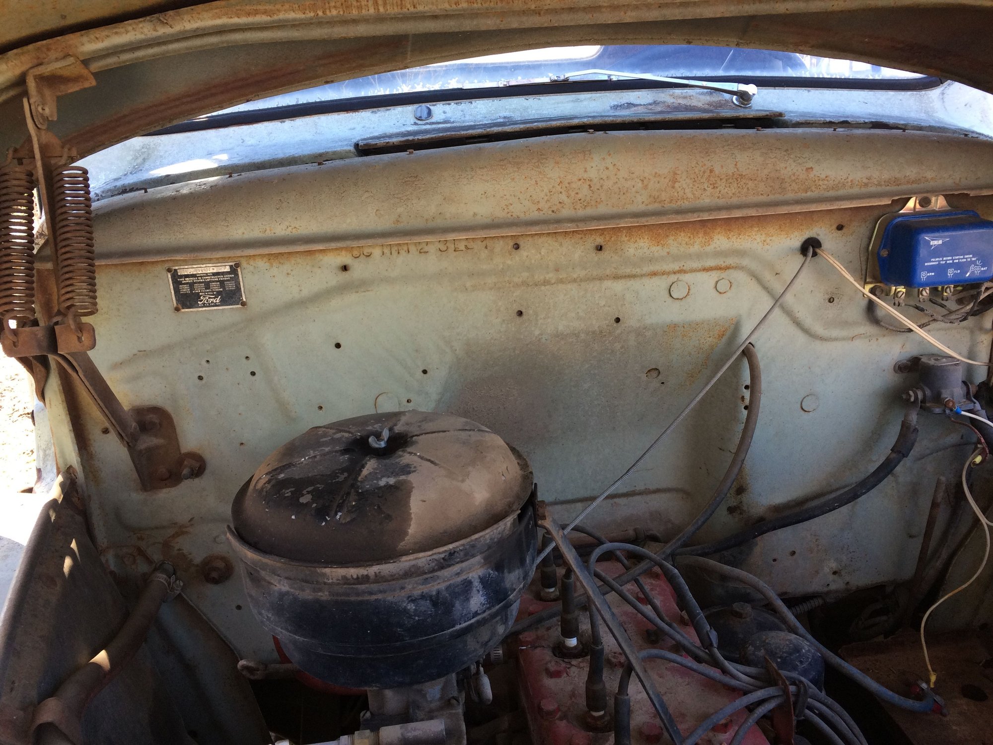

I am considering buying this F2 project for a factory restoration project. Can anyone decode the data plates in order to determine how original the truck is?

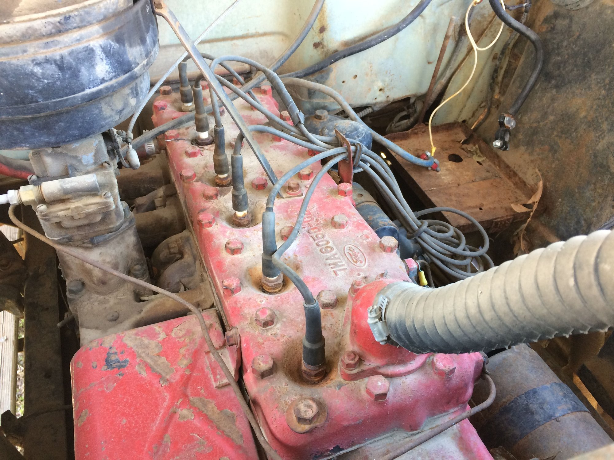

The '97H' matches the 226 H Series in-line 6 cylinder engine shown. I can't read the characters after that. Perhaps you might tell us what you see.

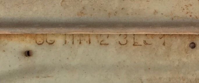

Smarter folks will be along shortly to decode the cowl stampings.

The data plate that is pinned on the firewall looks like 97HC 288437 MP as best I can read it.
This would be from an F1 with a 226 six cylinder produced in Memphis TN
I can't see enough of the first four characters on the stamped assembly code to give you much help. These would tell color and assembly plant.
The first two characters I can't make fit any of the usual color codes.
If I were to guess, characters three and four seem to be spaced right for HM - the Highland Michigan assembly plant - which doesn't work with your data plate.
It was produced Nov 23 so it would be a late '49 truck. It may have been titled in '50 and some states used first title as year of the vehicle.
The last 31 (?) would be the vehicle down the assembly line.
You really need to get the number off the frame. Passenger side near the cross-member for the motor mount. They are stamped lightly and may need to be scrubbed to make it stand out.

The plant code on the patent plate looks to possibly be H.P.
Would/could they have stamped HP on the patent plate, for Highland Park, but HM on the firewall? Have you ever seen that before?

I see that Wayne - I wondered if they were intentional periods. It's possible - I believe they started using Highland Park later anyway.

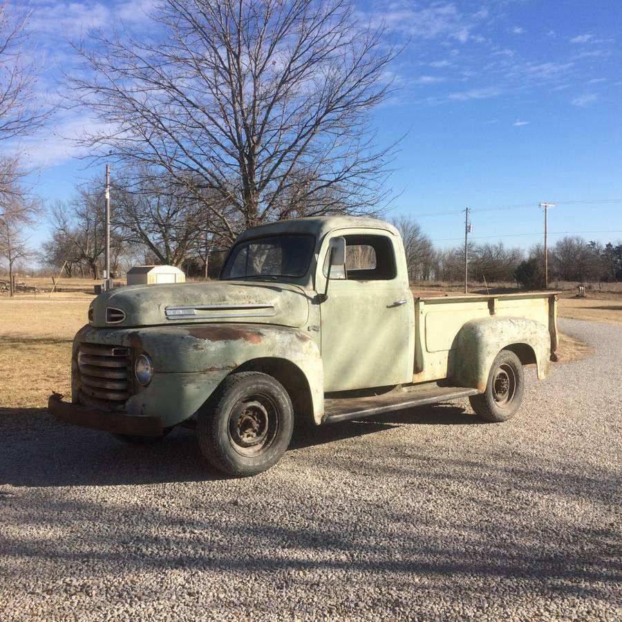

Those photos are all I have of the data plates/stamping. I will try to get some better photos when I pick it up on the 30th.
Everything I've seen so far on the truck leads me to believe it is original and unmolested.
It is a three speed floor shift, and I believe the original color was Sea Island Green.

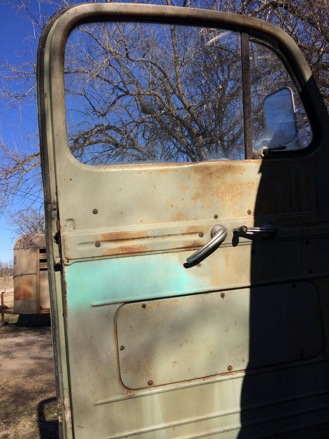

A fine looking beast. It does appear to be an unmolested original. The 3 speeds in the F2s were less common than the unsyncro 4 speed.

I enlarged the pic of the data plate. It's clear it was stamped 97HC, but almost looks like it has a D stamped over the C which would be right for F2.
Variation on these stamped plates is normal.
It does look like it's all original and I've never seen that color before. If Sea Island Green, the color code should be G...
When you get it home I'd appreciate another shot of the firewall stamping for those first two characters.

The second digit of the firewall stamping looks like it could be a G. Hopefully I can clear it up on the 30th.
I agree that it looks like a C and D were both stamped.

It looks like you've found a great project and have an amazing starting place for a restoration. I look forward to seeing more and following your progress.

This truck is as good as it gets, I would buy it in a heartbeat, if ….. if I not already had my 49 F2.
Enjoy it, you won't regret buying a pristine unmolested truck.
