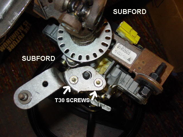

Tighten the T30 screws down low on the column.
Attachment 278054

they were tight already, I got to looking and it was the detent cable. Which isnt made OEM anymore. And since most ford parts are under patent and you cant order the OEM parts because they discontinued them after so long for some trucks. the ones that you can order are a little shorter so instead of running it back around the steering column I just ran it straight down and everything is fine now.
