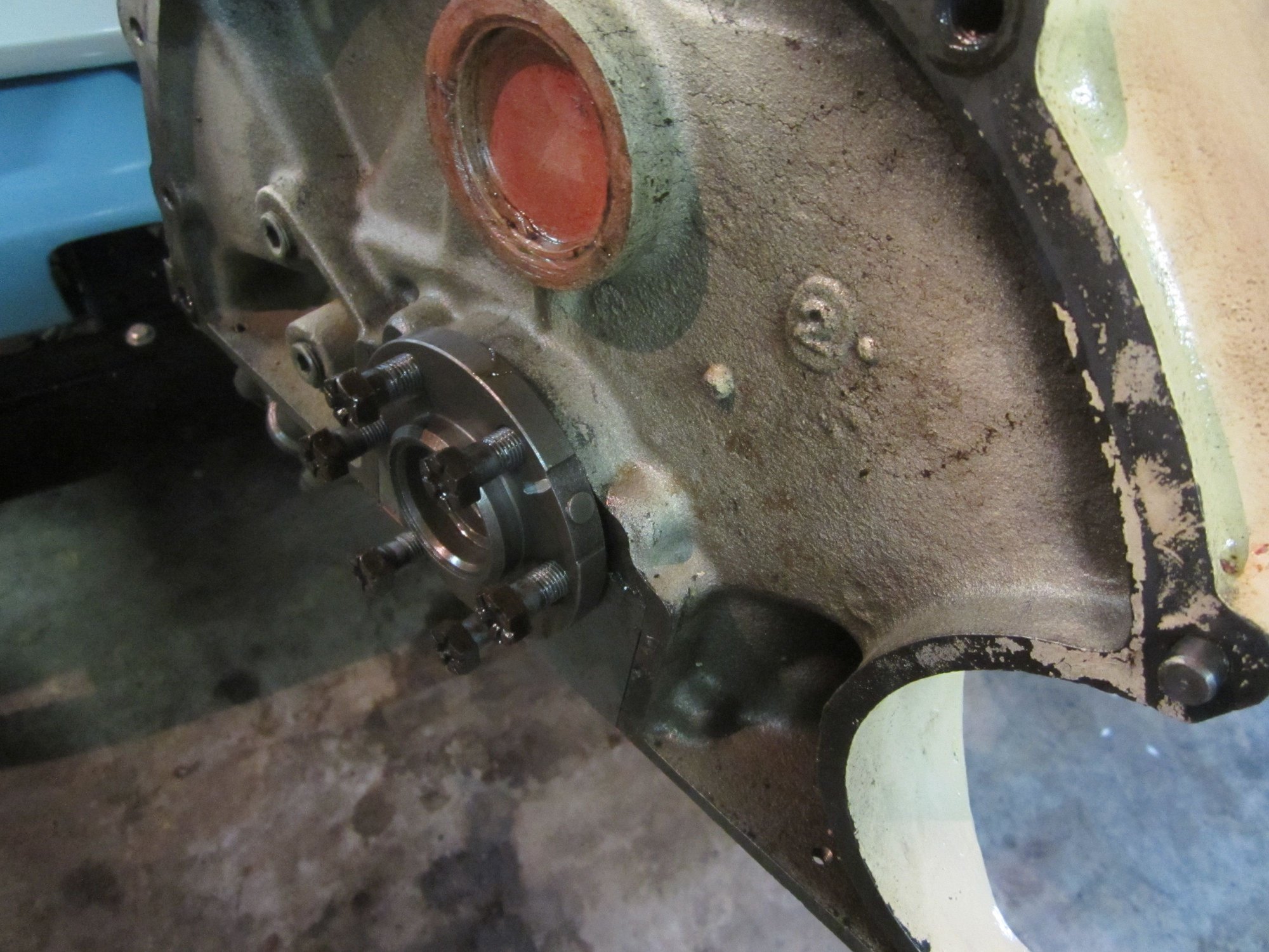

I loaded pictures from my camera to the IPad so I thought I would post some here. They’re from 2013 when I put new heads, crank, pistons and rods in it.
I had bought G heads which have bigger valves and higher compression, but you can’t put them on a 239 without some modification.

The water passages from the block don’t line up with the water passages in the head, so you have to modify the block.
I had to drill new water passages in the block at cylinders #4 and#8 to line up with the holes in the head. The new head gaskets close up the now unused hole in the block.
Because there wasn’t much gasket coverage I had a welder build up some triangular gussets. I had him keep it below the deck surface and I used epoxy to make it level with the deck surface.

The cylinders were previously bored +.125” making them the same size as a 256 or 272. I used 272 pistons with the 312 crank to get the correct pin height.

Here’s the new G heads on and degreeing in the camshaft. That gave me the most trouble ‘till I understood what I was doing.
