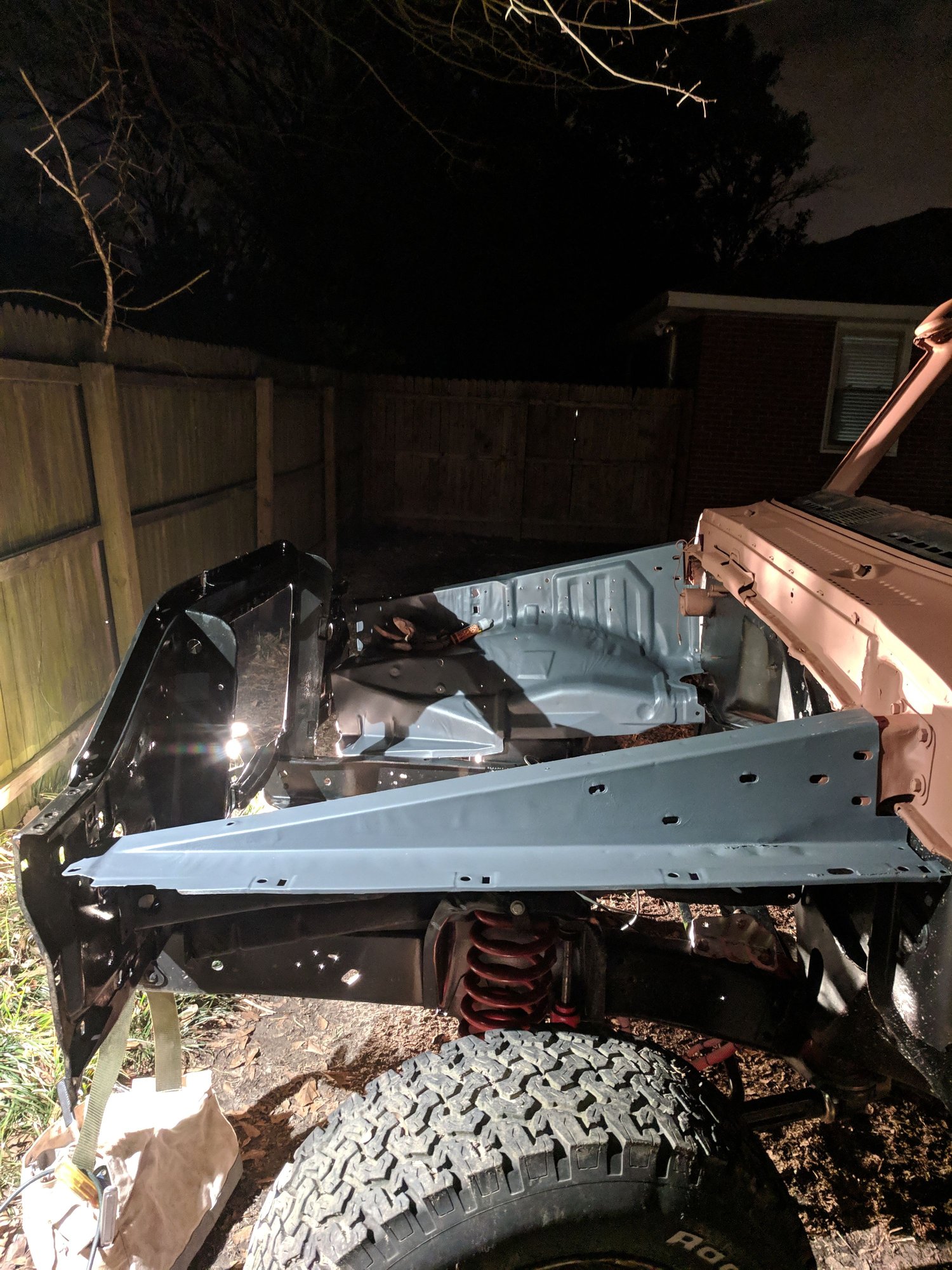

Hoping you guys will post some pics for me .I can't seem to find the old hood hinge to apron hardware .I'm sure there is a plate or something behind the apron for the bolts to distribute the load evenly .can someone post a pic of their truck so I can fabricate something out of steel? If anyone has had to do this ideas are welcome.

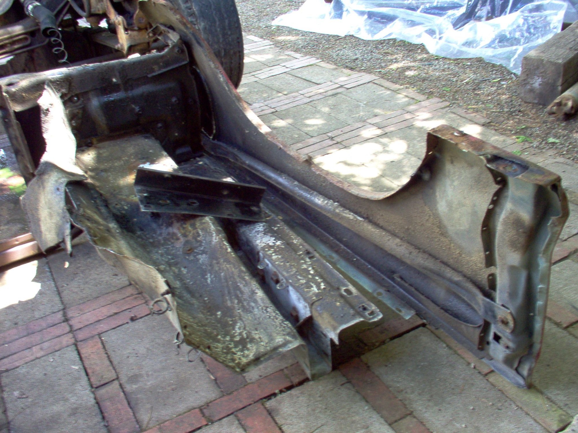

The factory hood hinge brace is sitting there. I have never seen another truck with these long pipe braces behind the inner fender but it's factory.

yes the inner fenders are what I'm talking about. It's a 73 super camper special .the three holes forward of the cab mounting holes are the ones .I have nothing on the inside of there .I don't want to just put oversized washers on the inside with nuts if it will not be sturdy enough to keep alignment when closes. Do you think it would be sufficient to only have large washers?
Thats what I'm talking about right there! Look like angle iron .I may have to make something .I should have enough scrap around to do it if I can't find the real piece.
