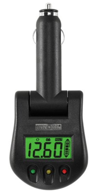

I used an Innova monitor plugged into the cig lighter as an easy way to see when my glow plugs were engaged or not. A pretty significant dip in voltage when they are energized.
