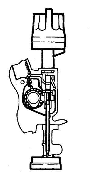

Oil pump. The intermediate shaft (hex) below is inserted into the oil pump to drive the pump.
Intermediate Shaft (hex). Goes between the distributor and oil pump.

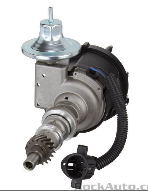

Distributor. The intermediate shaft (hex) is inserted into the bottom of the distributor.
Closer look at distributor gear and roll pin

This is a very helpful diagram...thanks for sharing it!
