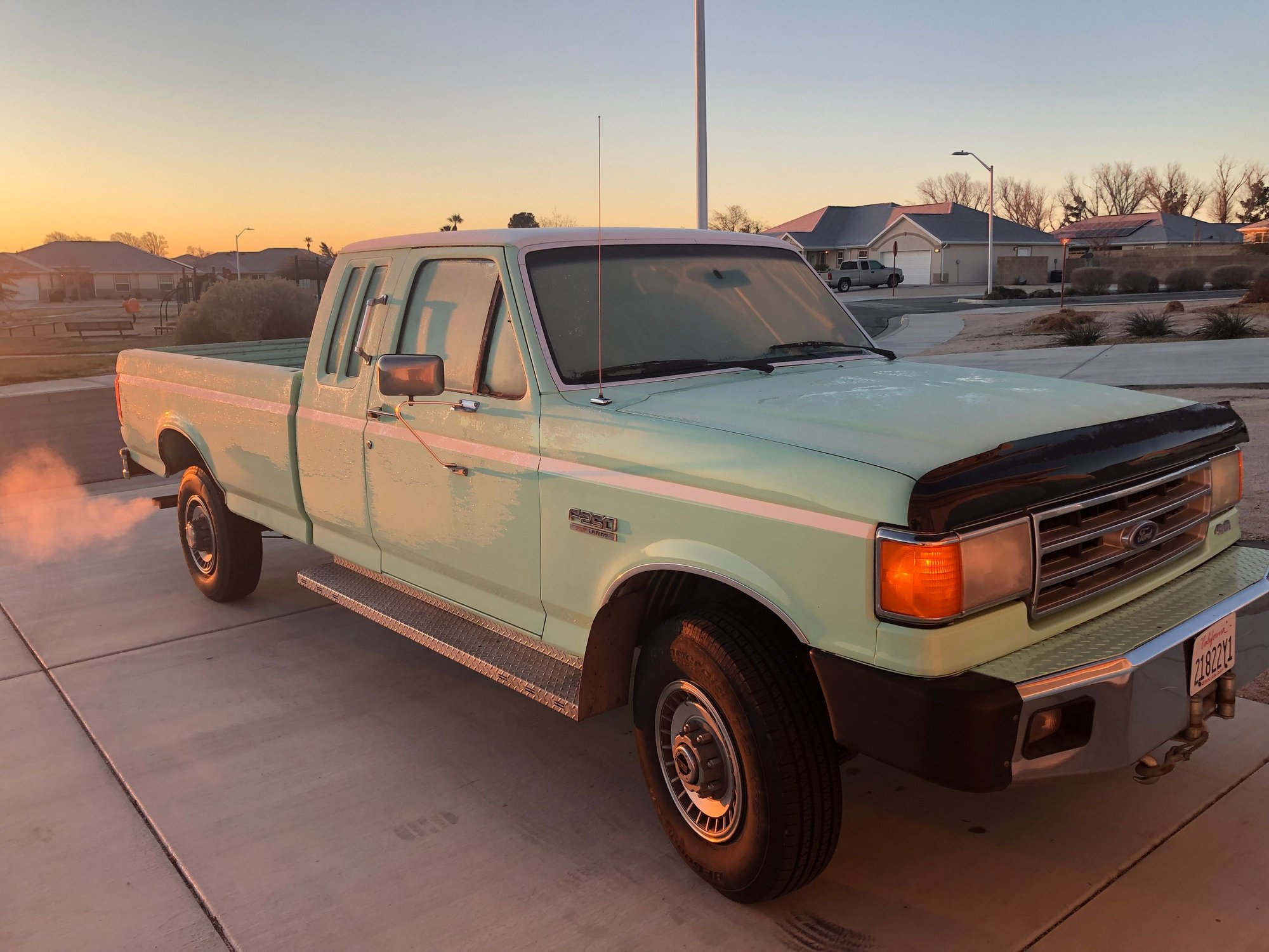

Picture of the outside of the truck below, warming up on a chilly morning last week. No it wasn’t a forest service truck, the previous owner chose this color.
