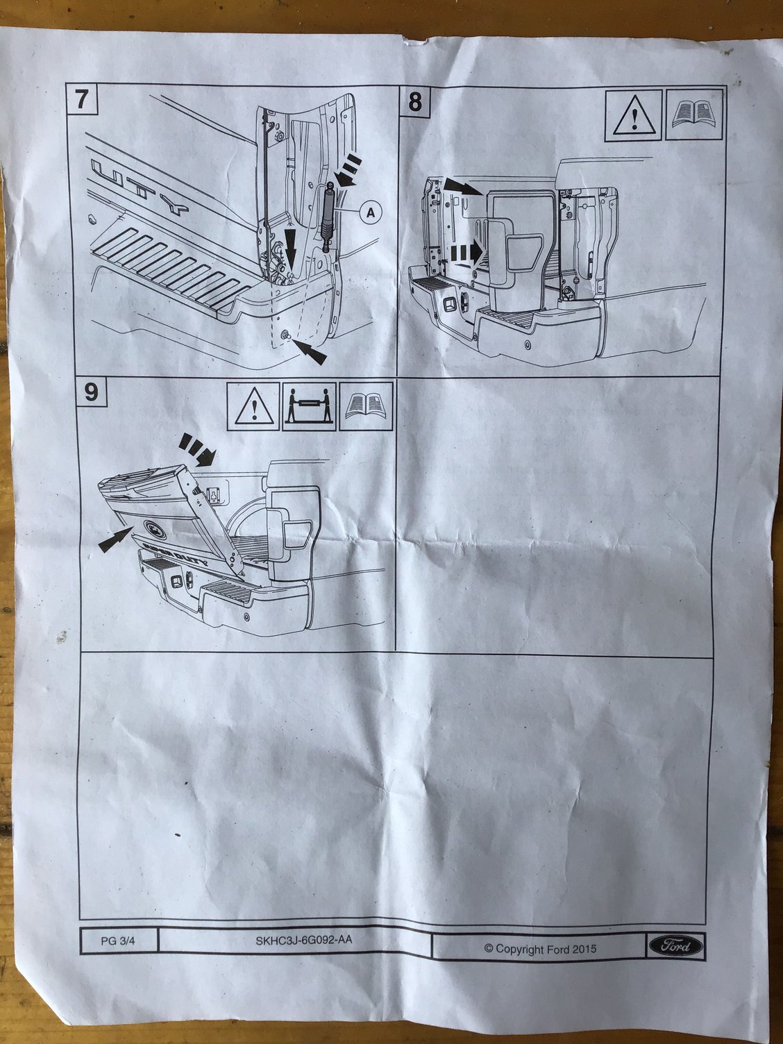

The factory damper is a one-way design that controls the tailgate opening drop. Closing resistance is negligible. The damper is located inside the right rear fender below the taillight assembly; see detail #7 in the partial instructions below.
