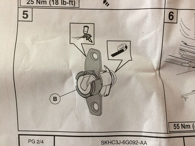

Question Question About "Tape"?
My damper kit arrived today from Amazon. Step #5 of the instructions indicates some sort of tape (?) should be applied to the arm-end of the replacement hinge:
Can anybody clarify: Electrical tape? Teflon tape? Other? Ignore?

Old Jul 7, 2017 | 02:06 PM
  #37
xxxsherpa's Avatar
xxxsherpa
Joined: May 2017
Posts: 1,382
Likes: 13
Maybe masking tape, looks like a spray gun next to the tape?
Old Jul 7, 2017 | 02:21 PM
  #38
crewzer's Avatar
crewzer
Joined: Apr 2000
Posts: 4,334
Likes: 306
From: Mills River
Thumbs up
By Jove, I think you've got it: mask the white areas, paint the gray areas. I'm not planning on painting the assembly, so I'll skip that step.
Thanks!
Jim / crewzer
