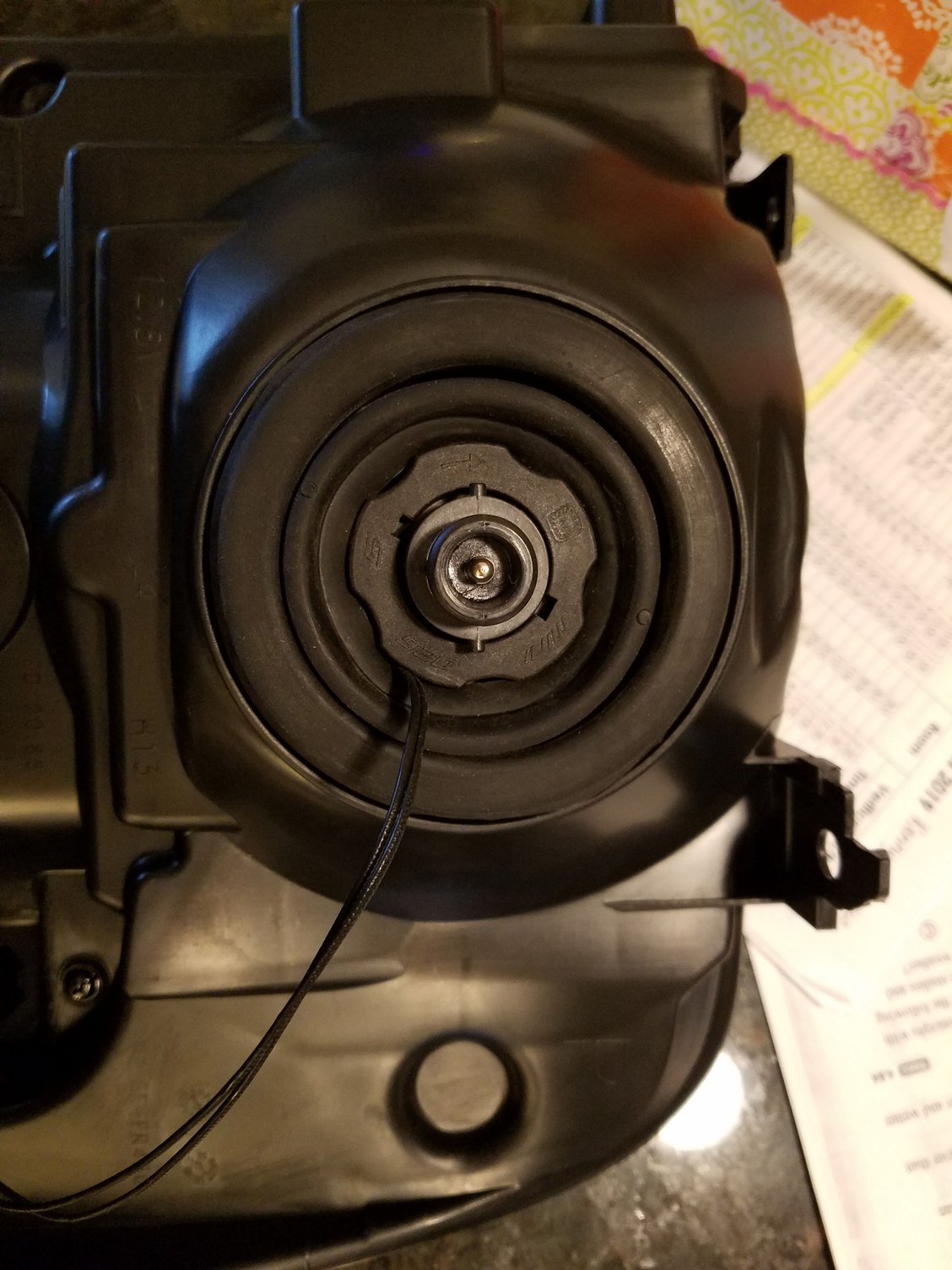

For those who have done projector retrofits on 05-07 headlights, how did you seal up the back of the assembly? I'm using G5R projectors with the Morimoto D2S holders and can't think of a good way to seal things up without siliconing the boot to the back of the reflector, making the bulb non-removable.

Typically a gromet is used and pushed through a dust cover.

For the solenoid wires, yes. Even without them in the way it looks like I need to seal against the reflector somehow.
