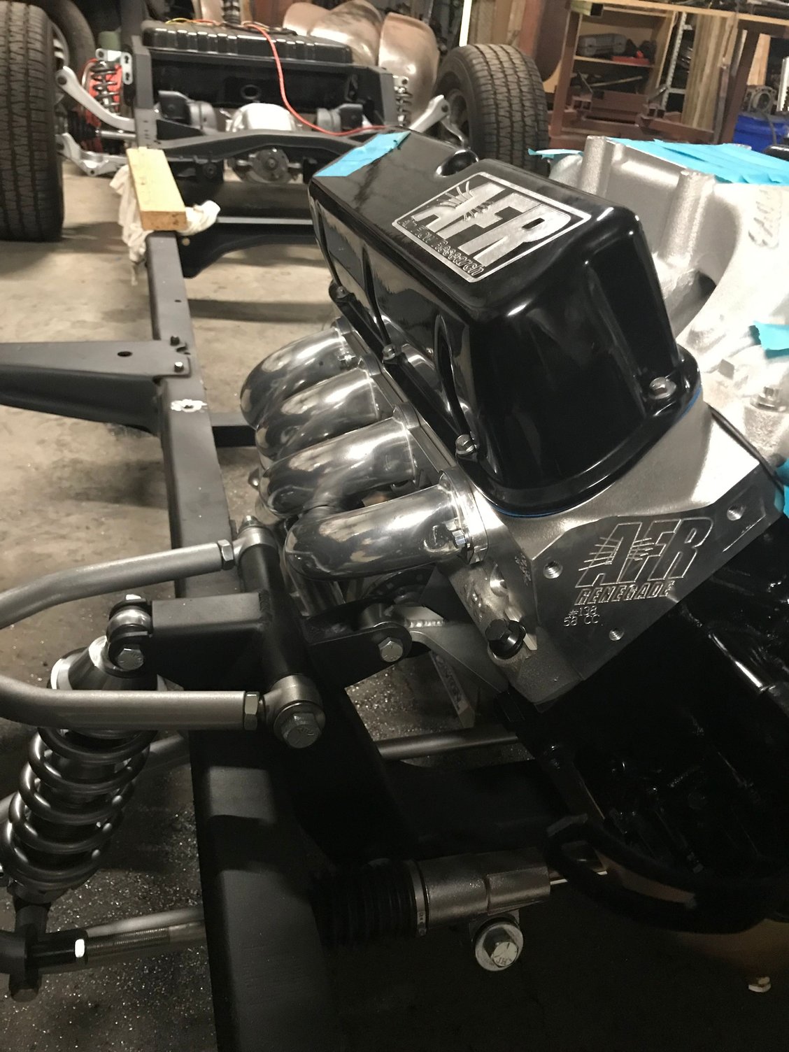

Are any of you running long tube headers with stock frame, IFS and sbf? I am guessing there is nothing COTS from my searching with custom being the only option however, thought I would ask. Thanks.

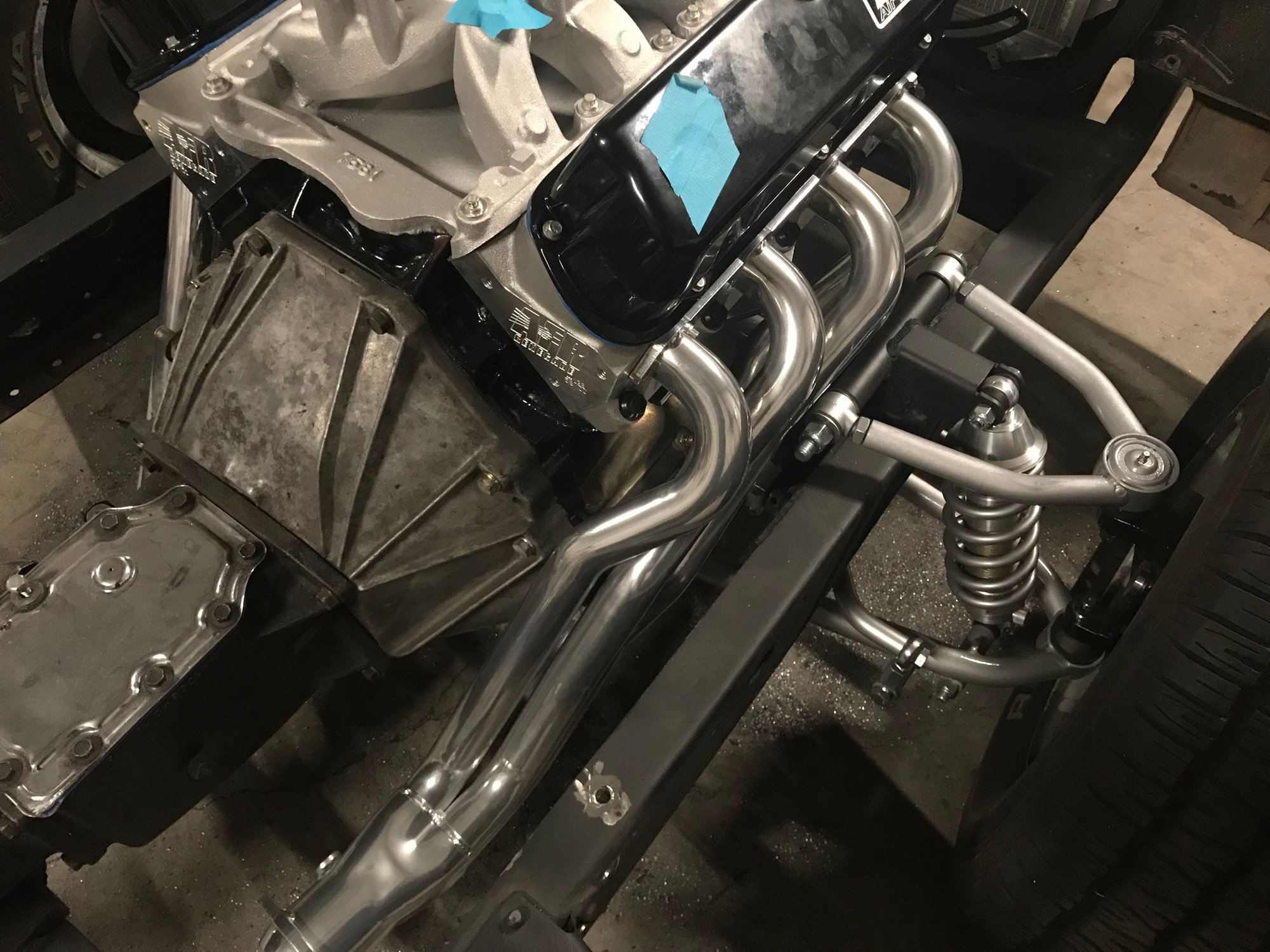

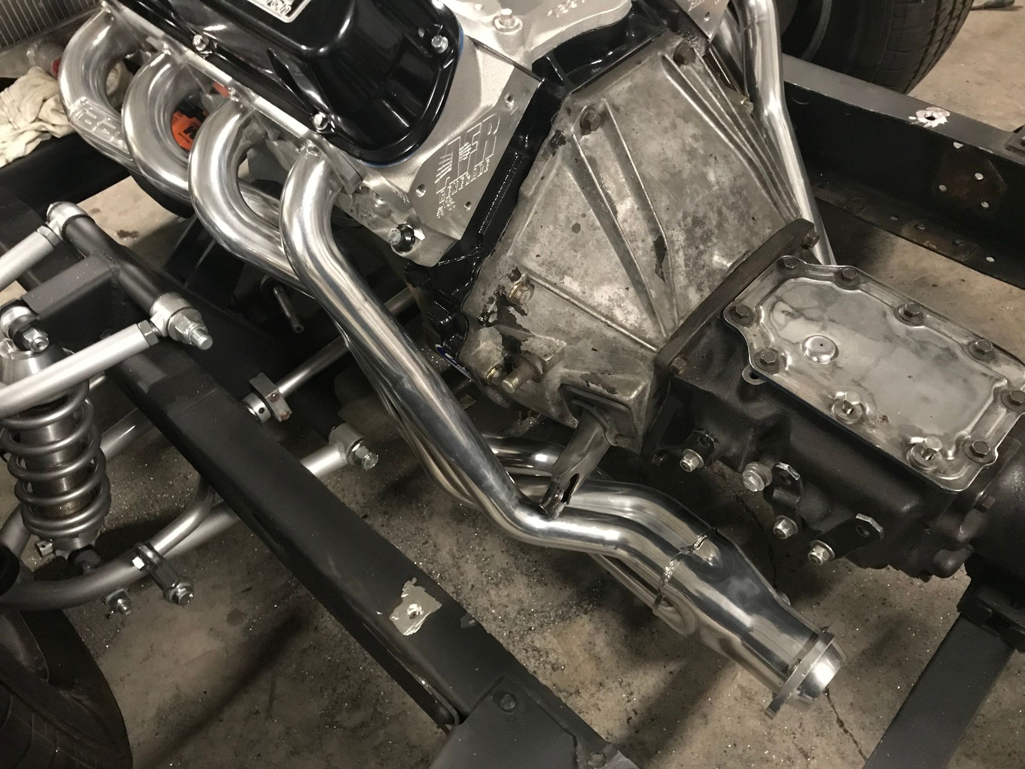

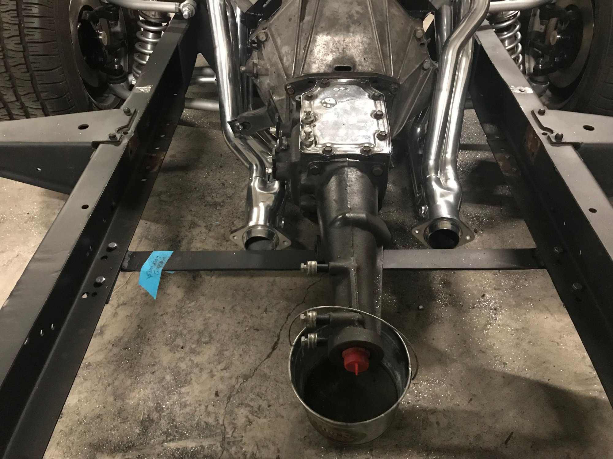

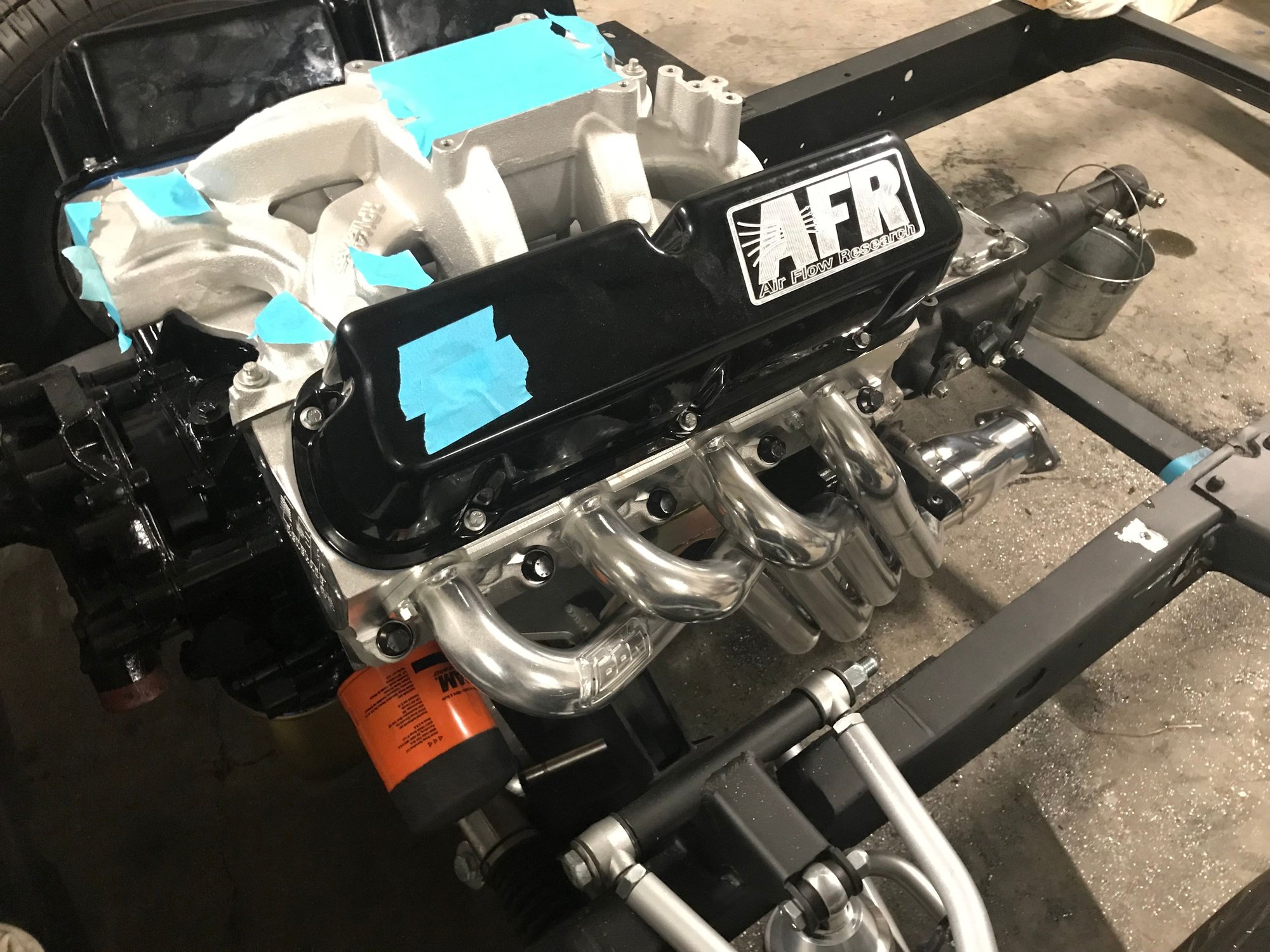

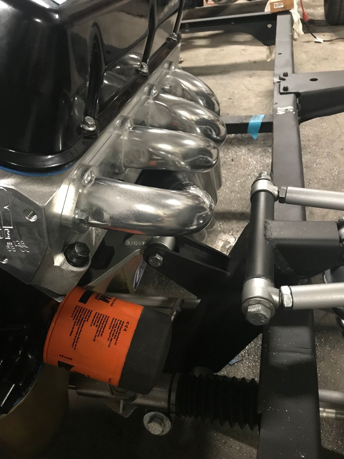

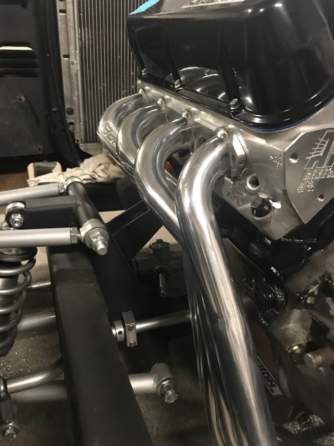

Old Mar 30, 2019 | 08:58 AM
54TexasF100's Avatar
54TexasF100
Joined: Jul 2010
Posts: 432
Likes: 34
From: West Fort Worth, TX

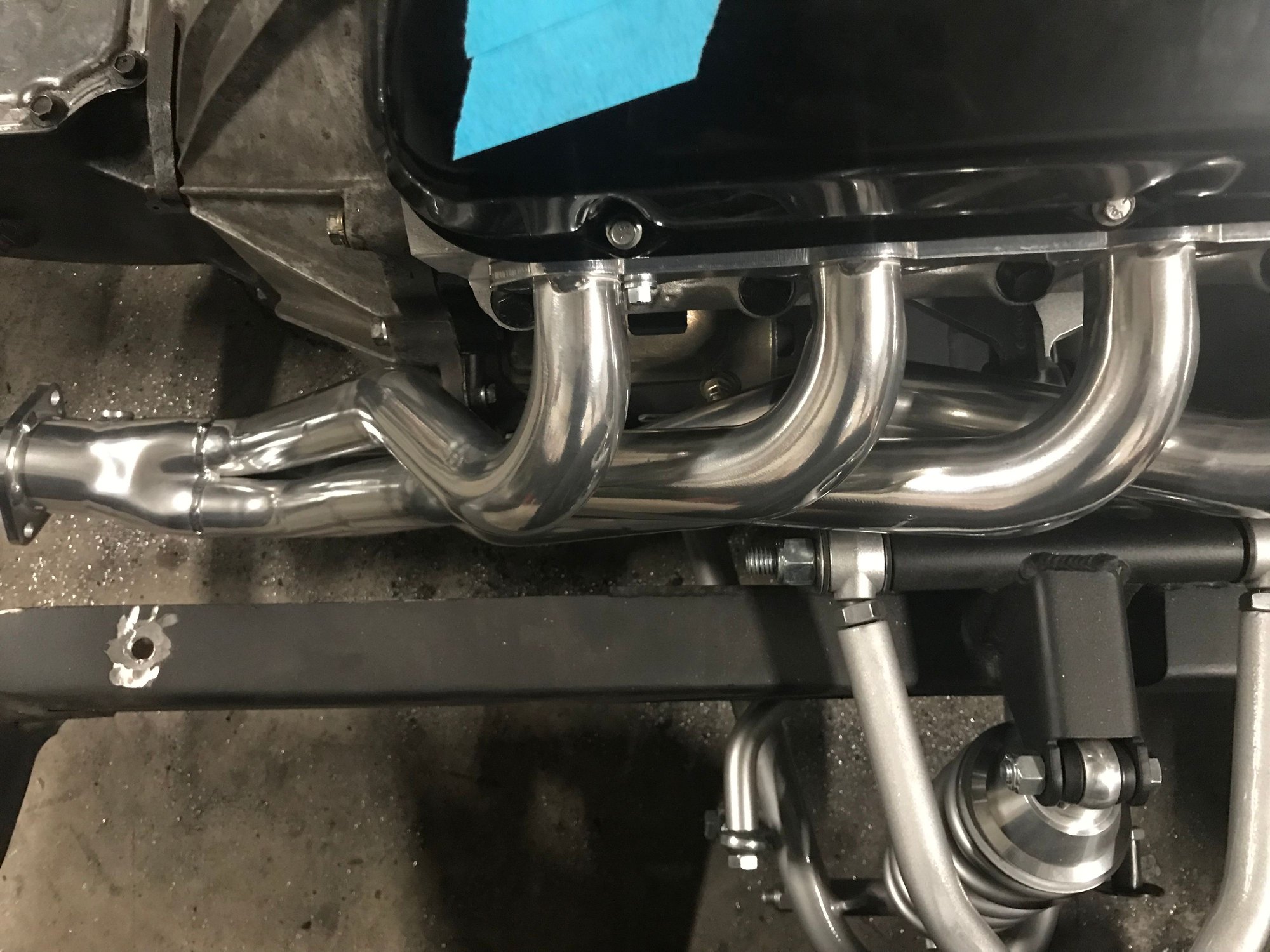

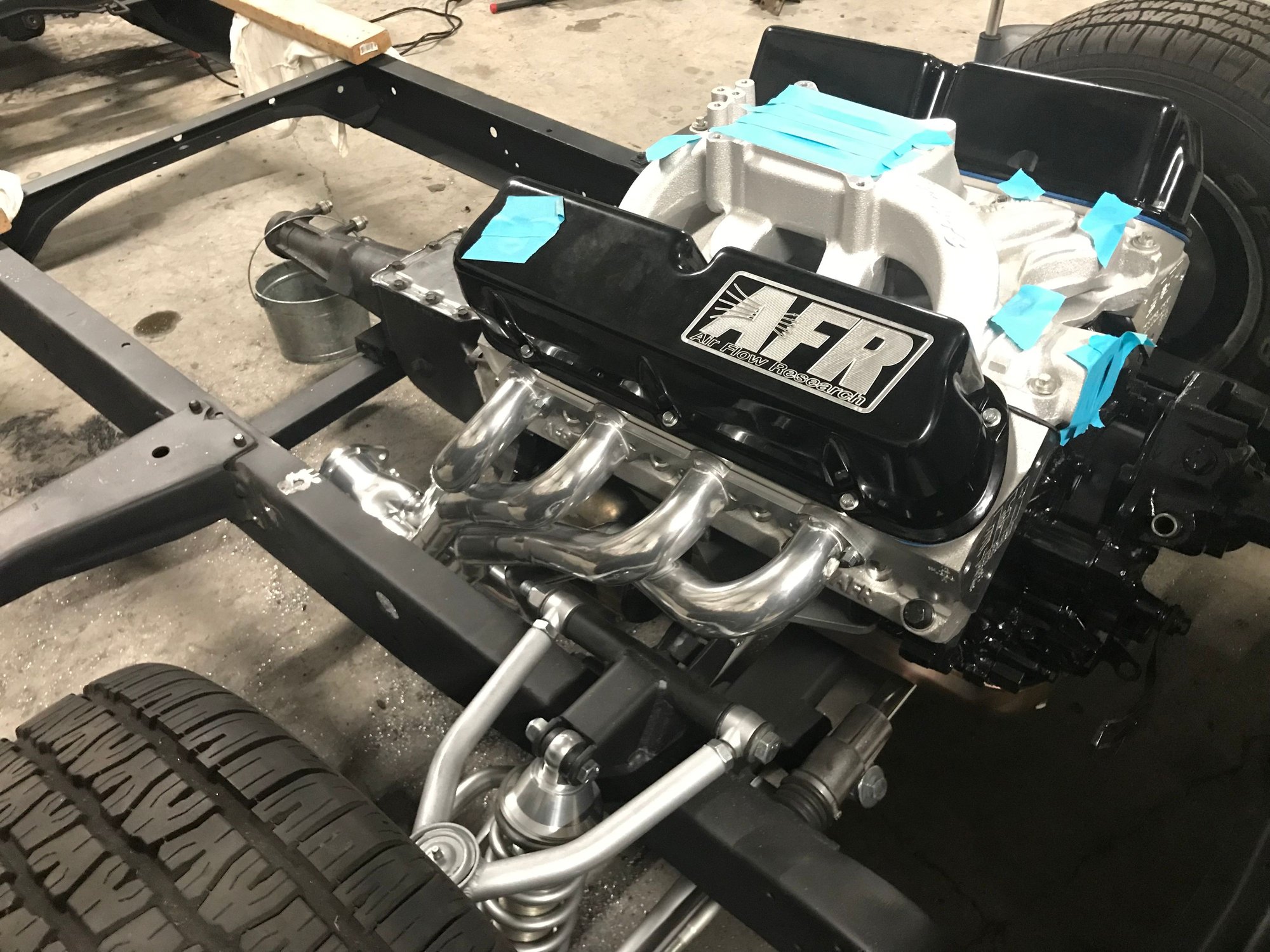

I bought 5 sets of headers with the requirements I wanted: long tube, stainless or steel ceramic coated, 1 3/4 pri. BBK-15690 was the winner. Like it was custom designed for my truck.
