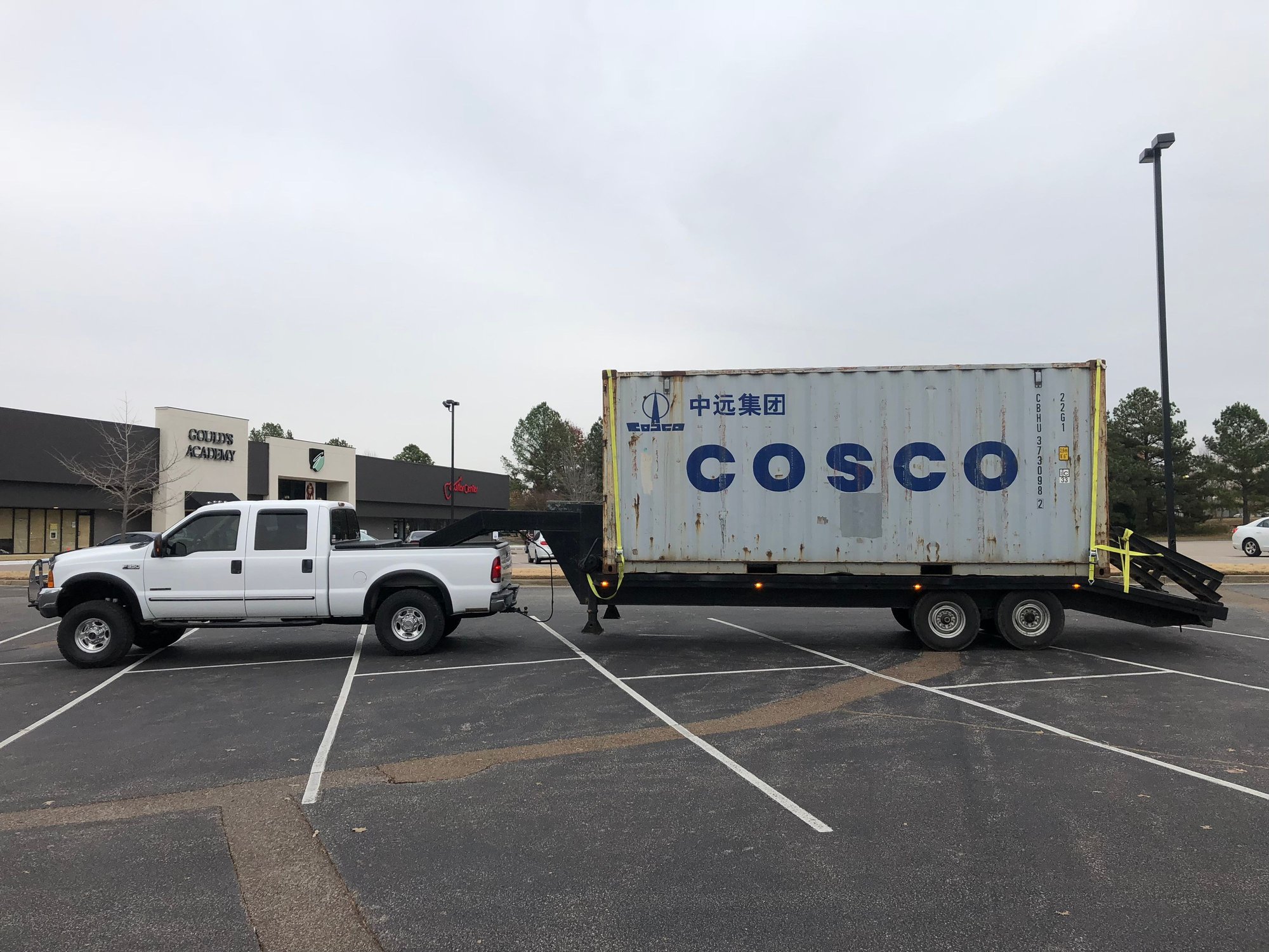

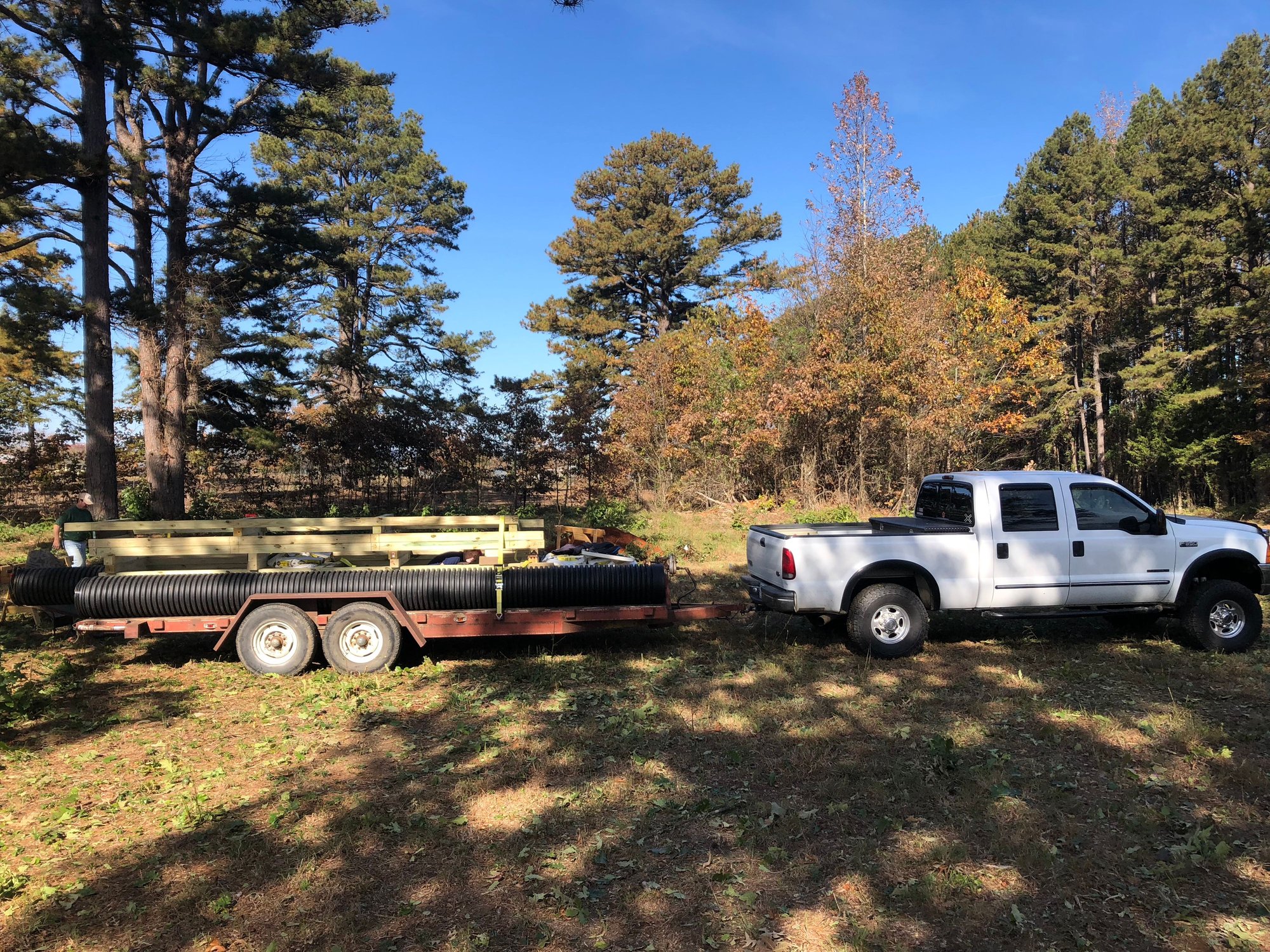

Judging by how far your factory overload springs are from engaging I would say your rear springs are not really sagging much, if any!
Maybe the front is lifted little too high?

Here’s some pics showing the ride height unloaded and loaded
