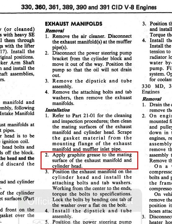

Hi tbruz,
For the steel gaskets, will you use Graphite Grease as specified in the factory manual?
Thanks..!

Hi Tbruz,
I'm not exactly sure what graphite grease is, but it is specified in the 1975 Shop Manual.
I had the passenger side exhaust manifold gasket replaced last summer at an old school truck repair shop, they used the steel gasket, and coated it with something that oozed out from the joint. Not sure what they used, should have asked.

I use Permatex anti-seize compound that contains graphite. I don't know the technicals of what the graphite does. I suspect that it may help with heat transfer, fill minor imperfections, and possibly provide some degree of rust protection to the mating surfaces. Over time, carbon deposits may also help fill the joint after the graphite has done it's job initially. I have a 1979 F150 (400 engine) with 375,000 miles and it has never had exhaust manifold gaskets installed--no leaks! Manifolds installed directly on the heads seem to stay flat and rarely (maybe never) need machining to true them up.
Many Ford engines did not come from the factory with exhaust manifold gaskets. I can't figure out why so many Ford truck lovers feel the need to install some sort of composite gasket with the manifolds. The 360/390 in our trucks did use a heat shield from the factory which is what Ford called them in the parts manuals (likely the same as the "metal gaskets" that you have). I think you are on the right track with what you are doing by installing the manifolds the way Ford did it originally. Headers are a different story.
