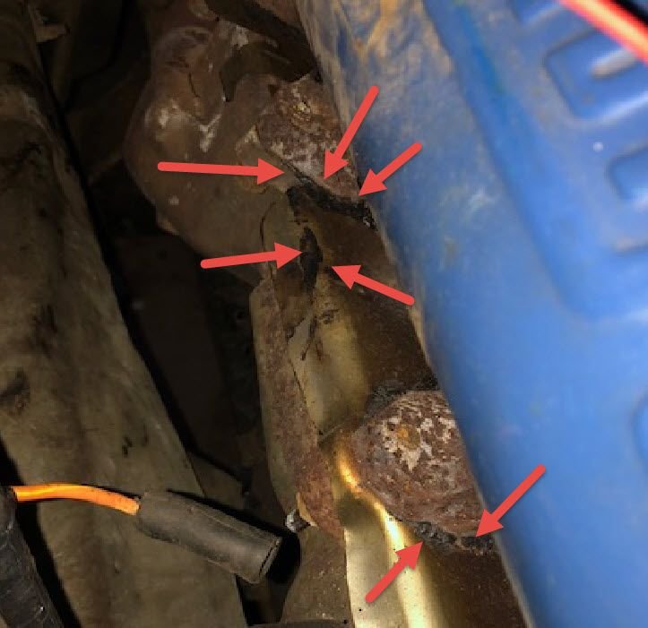

Here's a pic of the pass side ex manifold showing something oozing out of the joint and smudged on the heat shield. As mentioned in my previous post, an "old school" truck shop replaced the pass side gasket with a Felpro metal heat shield gasket, applied something to the joint that oozed out - and it works good. I'll find out what they used and report back.

The shop dressed the Felpro Heat Shield gaskets with Permatex Ultra Copper.
They cleaned the head surface thoroughly, cleaned the manifold flange face - on a belt sander, and applied bead of Ultra Copper.
Its been 9 months, few thousand miles, not exactly an endurance test, but holding up strong.

They used the Felpro Metal Heat Shield Gaskets + the Permatex Ultra Copper, scroll up and see my pic in my 03/01 post, you can see the gaskets.
By the way, I have been strongly advised to NOT use the dressing - clean it all up and just use the metal gaskets, dry.
I still wish I could use the "Graphite Grease" as noted the in Ford Manual - not sure what that is or where to get it.
