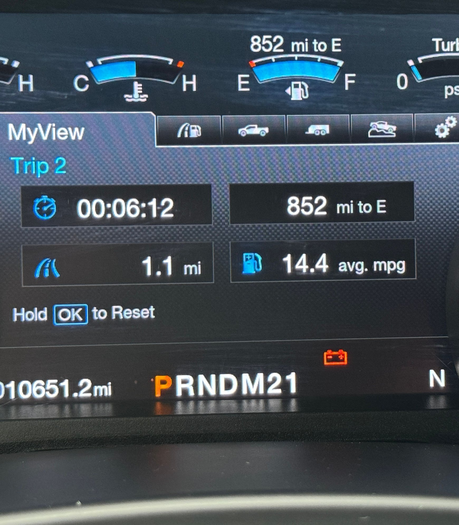

Unhappy 2022 DTE ForScan Change
Looking for help from those that have been more successful than I. I have a 2022 6.7 short bed and have had a 55 gallon Titan tank for about a year. With ForScan I have changed theIPC line 720-03-01 with the 8 22 per the spreadsheet but have had no change to the DTE on the dash gage. As seen in the image, am I also required to change the 720-09-01 (see highlighted cell) to make the change work? I'm a bit confused. Many thanks in advance!
Old Feb 15, 2026 | 07:46 AM
jetpilot2's Avatar
jetpilot2
Veteran: Navy
Joined: Sep 2009
Posts: 561
Likes: 49
From: Va Beach, VA
Yes, you need to change 720-09-01 too.
