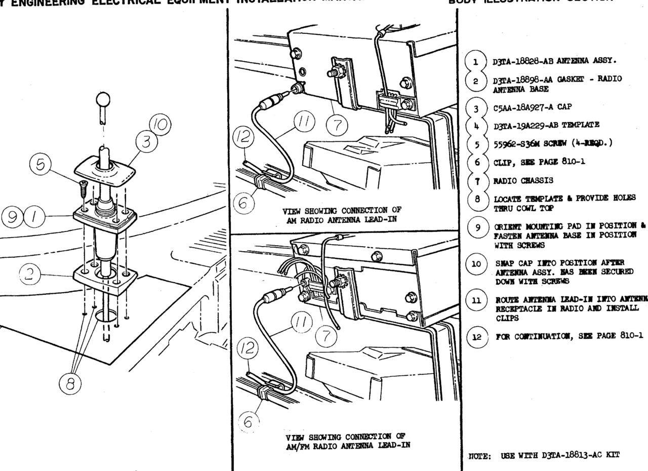

Teardrop (Ford: Airfoil) antenna used on 1967/72 F100/350 and was the same as 1966/68 Galaxie/LTD (C6AZ-18813-E).
1973/75 F100/350 also used a teardrop antenna, but it was different (D3TZ-18813-A) than 1967/72 even though the antenna mast (C6AZ-18A886-A) was the same as 1967/72.
1976/77 used a different antenna (D6TZ-18813-A) with a round mast (C0AZ-18A886-A) that telescoped.
1978/79 F100/350 & Bronco antenna was different (D8TZ-18813-A), the round telescoping mast was the same as 1975/79 Econoline (D5UZ-18A886-A).
In the early 1980's, Ford replaced all the 1967/79 F100/350 antennas with the 1973/78 LTD antenna (D3AZ-18813-A) that did not telescope.
