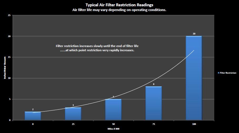

Air filter - the three biggest misconceptions on air filters are: it is okay to open and inspect it, you can tell if it is plugged by how dirty it looks and should change it when it looks "dirty", the little doo-hickey hanging off the side of the air box affectionately known as your air filter restriction gauge does not work because it never moves. The best thing you can do for your air filter is to not touch it - open it to inspect it provides opportunity for dirt contamination and breaks the seal between the air filter and housing. Cellulose air filters have a very high initial efficiency which only gets even higher as it loads with dirt. That is a good thing - changing the filter prematurely keeps you in the initial efficiency range only. As for the minder - that is the one and only reason you should ever open the box and change the filter - when it states to. That minder will indicate filter change at 20" or 25" of restriction - whatever Ford chose to select.
Your new air filter creates 1" at most, most likely closer to .5" The gauge does not look like its working because it is! The filter outflows the engine air requirements - the filter has to be relatively full before restriction starts to climb. Once the filter reaches near end of life, restriction climbs relatively quickly.
For the 6.7L, the manual states you should inspect the filter minder - it does not specify mileage replacement interval or to visually inspect the element.
You will have no effect on performance or fuel consumption up to around 20" of restriction on a turbo charged diesel engine even up to full load conditions which is when the greatest air volume is drawn - below those conditions, you draw less air volume. The industry standard is to replace at 25" of restriction at the filter. Restriction is based on the amount of surface area of the filter PLUS the air flow. Hence why it takes so long. For most owners, you will not see an air filter change request until you are in the area of 100K. Quick lube and dealerships places all over the country will fight you on this but the real truth is that changing your air filter early provides no benefit, waste Your money and can in fact be detrimental.
For those who are interested, Fleetguard, Donaldson, Cummins and many others have PDF files online which you can quickly find regarding air filter best practices.
