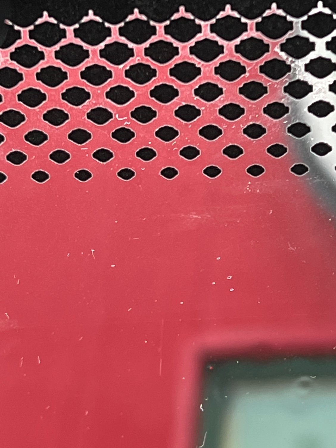

There’s a difference
The 05 and probably up, does have a special windshield. If you look at the dots around the windshield they’re not just regular dots they’re actually HD shields.
