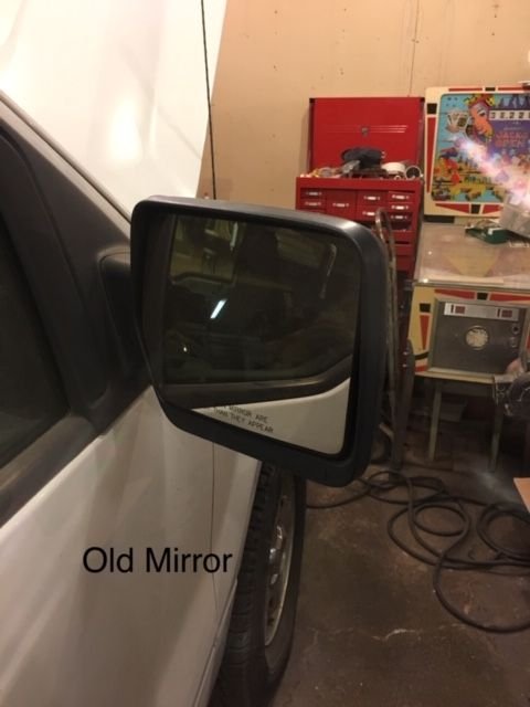

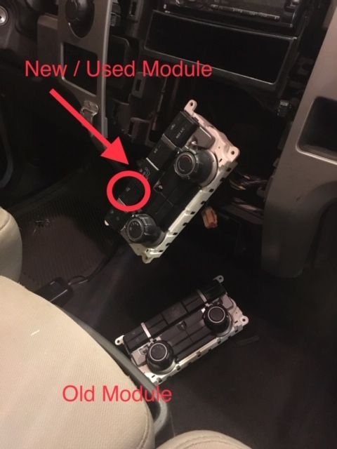

Hey!,
Just recently did a swap! Worked out PERFECT!!!! Mine was on 2010 F150 Base Model.... Some-one also pasted link in reply.... ALL I NEEDED TO DO WAS:
1, Get a set of mirrors from E-Bay, They arrived from Amazon and even BETTER! (They had the Puddle Lights) Not sure of why of mix up......
2, Buy a used Heater Control Module,
3, Plug everything in, All functions work!!!
TOTAL COST CANADIAN DOLLARS : $225.00
Good Luck,
Old / New Module NOTE: New Module heated Mirror Button

mine worked too
2013 f150 xlt. no rear defrost. i swapped the mirrors for an oem set with puddle lamps, heat and turn signal lights. also swapped the heater module to the one that is for heated mirrors only. everythings works fine
