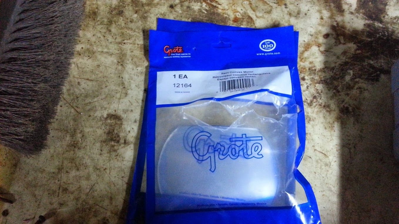

Originally Posted by oldbird1965
I like your convex mirrors Nate! Did you get them at NAPA? I have the same mirrors as your truck but sometimes I think I got alone better with the mule's nemo's. Backing the 5er sometimes all I can see is white. My smaller convex mirrors things are to small.
Those mirrors are just some Grote parts that I bought online when I got my replacement mirror heads. I don't like the heads as much as the Ford parts, but the OEM parts were too rich for my blood and next to impossible to find used in good shape. I do really like the convex mirrors though. I got used to them on the SD van I used to drive for work and really missed being able to see everything. Here's the P/N in case you want to get some. They can be bough online for a couple bucks a piece. Do yourself a favor though and ditch the cheap double sided tape that comes on them and use some 3M emblem adhesive tape to attach them.
My apologies to the OP...
