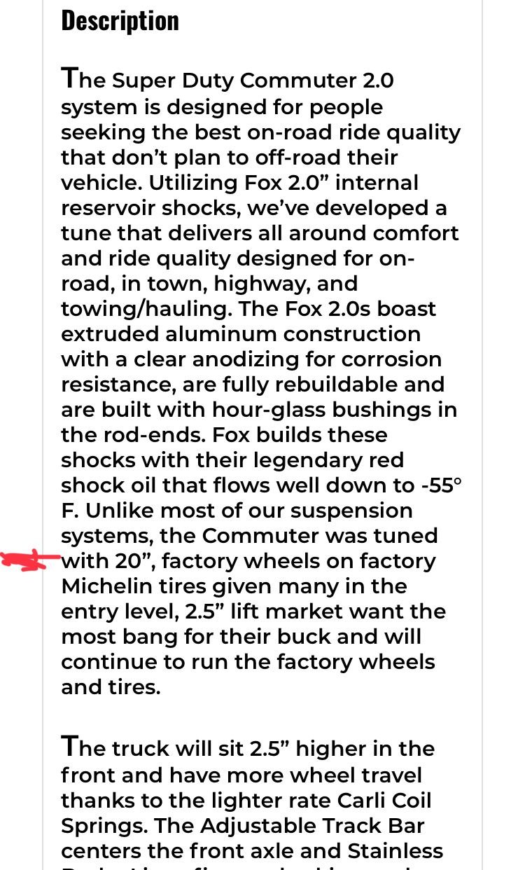

Originally Posted by brainofjjj
Care to share a link to that? This is from the Carli site for the Commuter kit. https://carlisuspension.com/product/...2-0-system-17/
"Wheel and Tire: On our 2.5” Ford Systems, we recommend 17”-18” wheels, no more than 9” wide with 5.5” of backspacing"
I drove it with the 20's lowered to 45 psi and then swapped my 17's and it was a huge difference. Anyone moving to this setup should just try it, if you started with 20's that is.
My shop, Texas MotorWorx told me i could run the stock rear leaf to keep full utility of the bed and could swap anytime if i didn't like the ride. Frankly it's been fine so i'll likely leave them since i tow regularly and don't want to lose payload. I might add airbags and a Deaver progressive at some point but it's not urgent.
Its in the description portion on the page you linked to.
Weird, you'd think they wouldn't tell you basically "Hey, choose any wheel from 17" up to 20""
I drove on both and felt like the 17" was much better given all the extra sidewall but not everyone is as sensitive.
