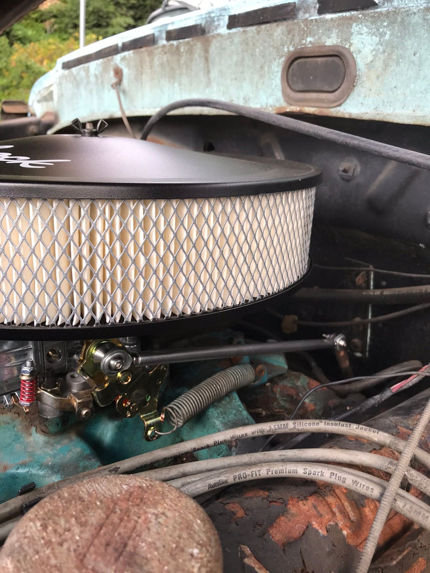

any pics of a straight rod hook up????

Posts: 24
From: Carlsbad
Here you go

Originally Posted by JHof44
Here you go
how does one acquire something so beautiful?

Posts: 24
From: Carlsbad
You can make one for a few bucks with rod and connectors from Fastenall, or you can purchase one like this from summit (Scott drake Part#: SDK-C5ZZ9A702BL) for about $30. I believe dentsides also ran a factory straight rod but I’m sure somebody else can confirm that info.
