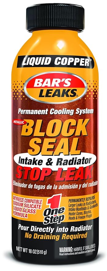

I have used BARS LEAK with good success on coolant leaks. I prefer the COPPER base sealer. It mixes with the antifreeze and no need to drain or flush before or after. I think the number is #1109 .... it cost about $10. at Auto Zone. Your biggest problem now is the coolant. Get that sealed up, then worry about the oil...... fix external leaks, then determine usage.

BARS LEAK 1109..

I used the stuff above on my old 98 4.6 and it sealed it right up....still had good heat too. I also drilled an 1/8th inch hole in the thermostat body (where the jiggle pin was) to keep pressure off it until it opened...that really helps. I sold it a year later with full disclosure.

Did you use the head gasket sealant or the liquid copper block seal? Should this work without having to drill a hole in the t-stat body would you think? Thanks.

I used the copper block seal stuff like Steve has pictured. The hole is insurance until the motor warms up and the seal is totally tight. What would happen with mine was some exhaust gas would get into the coolant while the motor was warming up. Since the thermostat was closed it built up a lot of pressure. Once the thermostat opened all that pressure was released into the system and she would puke out a bunch of coolant out the reservoir. Then it would settle down and be fine. The small hole in the thermostat prevented this. Try the sealant first and see how it acts...it may be fine.

take off the top radiator hose at the radiator and pour the bottle into the hose and reinstall.. that gets it into the system immediately .... don't pour it into the overflow bottle............ the stuff works by plugging a hole that has a differential pressure on both sides... NOT like a heater core tube, or radiator tube... has to be a DROP in pressure across a hole, like a pin hole into the head or intake manifold from the coolant passage.
