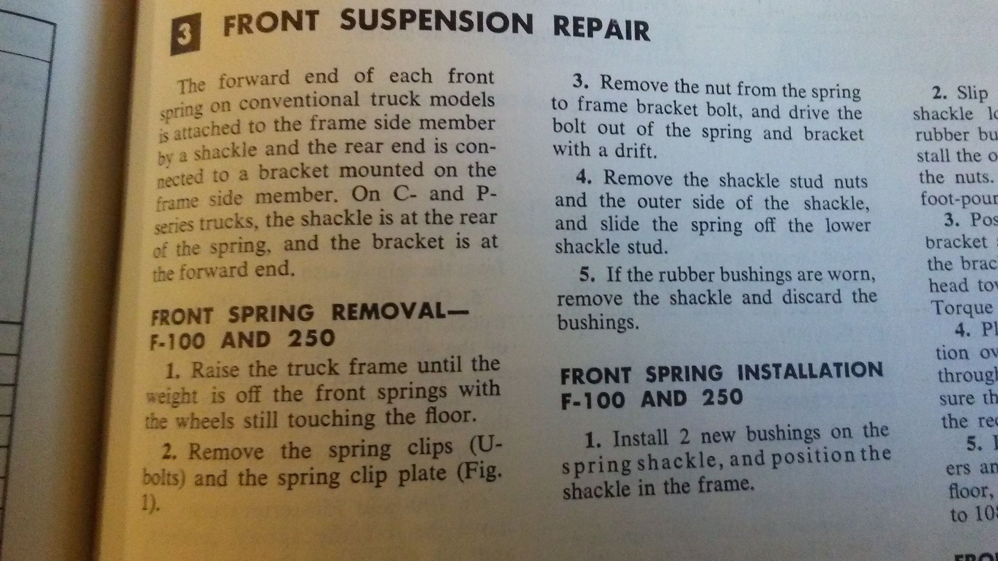

I am replacing the bushings on my front leaf springs on my 1960 f100 and am trying to figure out what eye is the front and what eye is the rear. I bought the kit from LMC that has the two piece bushings and shackle for the front and the metal\rubber\bolt for the rear but I do not remember what orientation the springs need to. From my measurements, they are the same distance from ping to the center of the eye.

Make sure that you don't remove or damage the sheet metal reducer in the front spring eye or the new bushings won't fit. Ask me how I know. I did find an Energy Suspension bushing that was the correct dimension without using the sleeve.
Old Feb 5, 2019 | 04:51 PM
robski_1970's Avatar
robski_1970
Joined: Sep 2017
Posts: 126
Old Feb 5, 2019 | 04:56 PM
robski_1970
Joined: Sep 2017
Posts: 126
Inside diameter of front bushings reads .440 inches.
