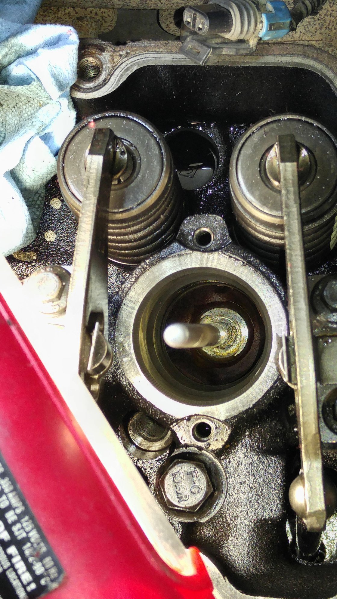

I used a Dremel on low speed and a wire brush attachment I bought at harbor freight. I think it did a pretty good job but I'll no for sure after I drive it awhile and see if I still have anything leaking.

I put a paintbrush handle in the injector hole and chipped the pieces of old sealant (it was hard as a rock)...
Then I vacuumed up the pieces, used some IH brushes along with Dremel brush attachments (similar to Obs7.3Powerstroker) to clean the seating surface. Then I swabbed the bore and seat area with 90% rubbing alcohol to make sure there was no residue before installing the cups...

That's a clean hole right there. If I every have to do this job again - I'll be following your lead.
