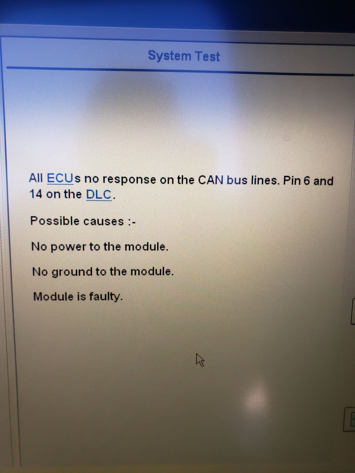

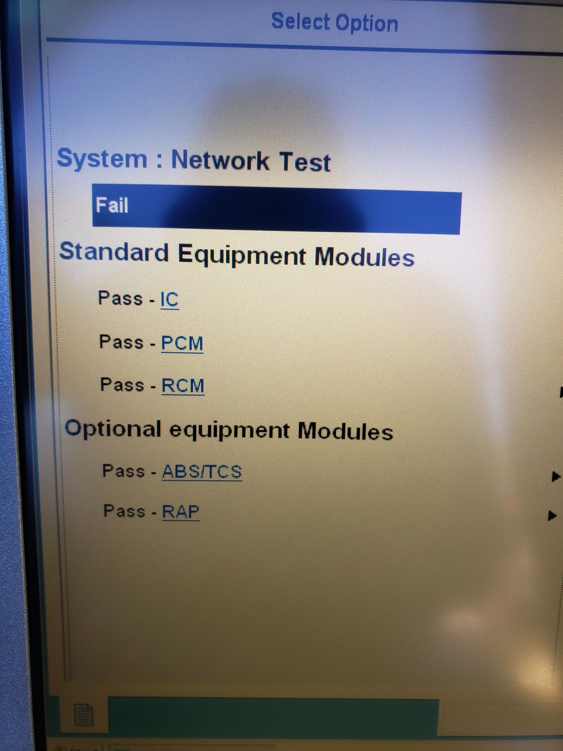

Friend tells me he was driving down the road at appx 50 mph and it died in flight. Pulled over to side of road and cranks but wont start. I hooked up with ids and pulled codes. Quite a few. B1352 ignition key in circuit fault. C1284 oil psi switch failure. B1360 ignition switch circuit open. B1607 illuminated entry input circuit failure. 5 codes for the instrument cluster. U1123, U1059, U1027, U1041 and U1262.

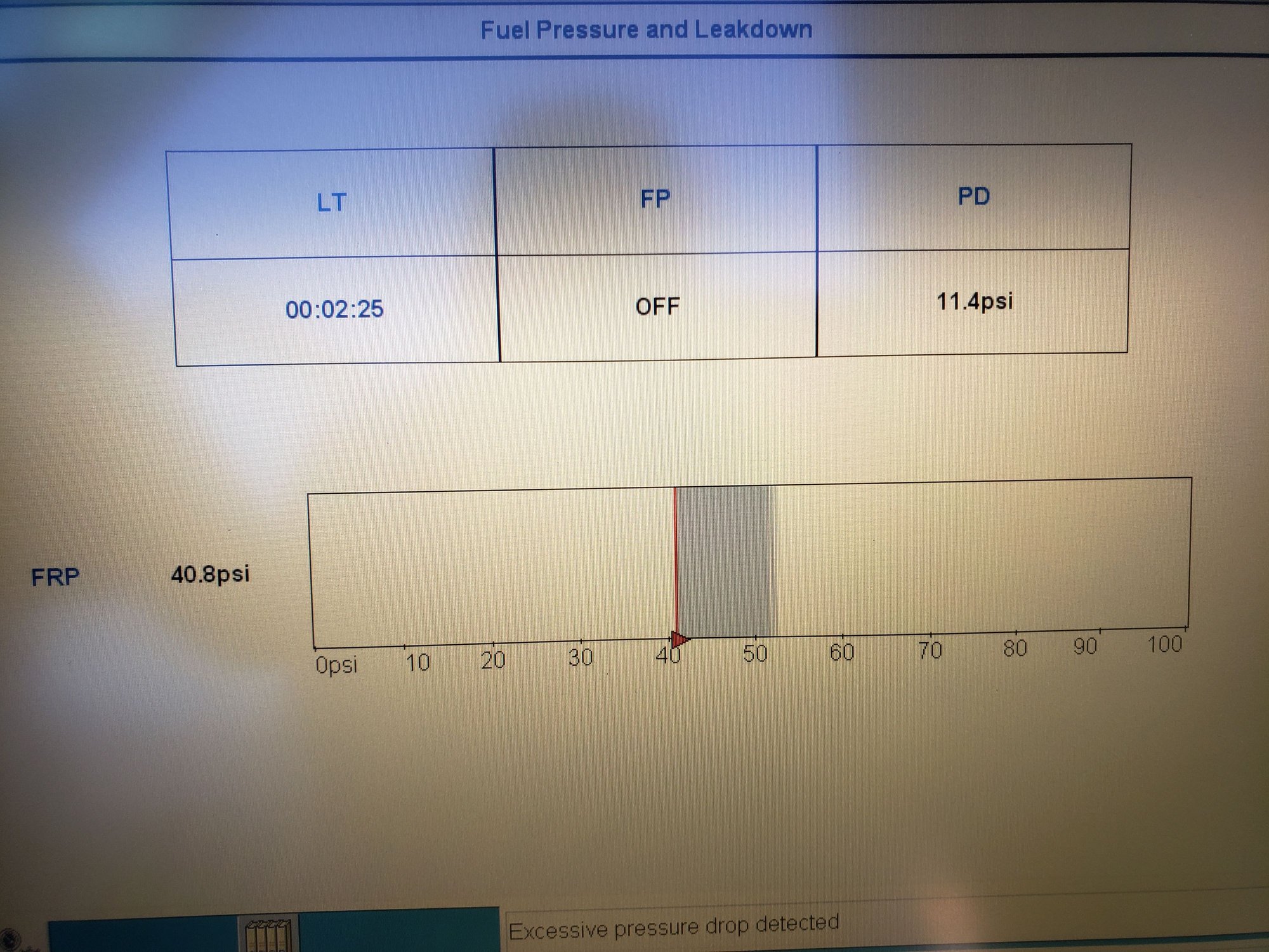

I also ran a network test and got this message. I did a fuel psi leakdown test and it had excessive psi drop. I checked the inertia switch and it has power. I checked fuel pump relay and it's good. Anyone have an idea? I did a tpS sweep test, checked cmp, IAC, I can see rpm. I'm just trying to help a guy out but don't really know this engine. Any help would be appreciated. Thanks.

It seems that yea, there may be a problem with the leak down, but you have good fuel pressure. So why are you still thinking that fuel pressure is your issue? I'd be looking at the ignition system now. Maybe I'm missing something here.
Your leak down would cause a hard start, but that can be overcome by switching the ignition to on, letting the fuel pump pressurize the system then starting the van.
